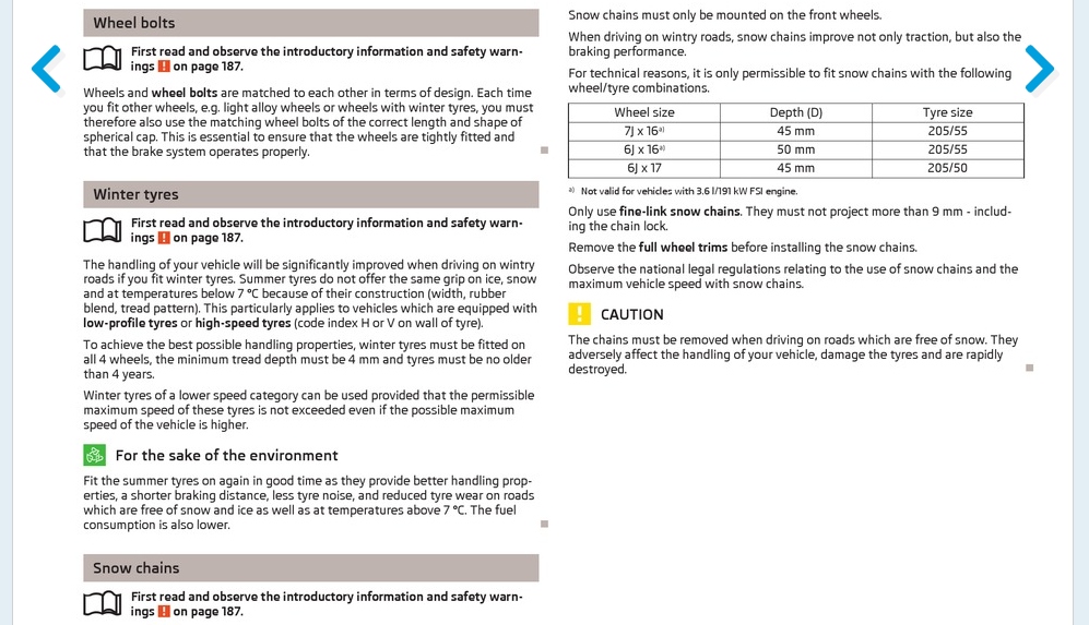

Did you not check what Skoda gave as the size of wheels / tyres suitable for fitting Snow Chains to?
43 minutes ago, e-Roottoot said:
@Carlston
195/65R15 6Jx15 ET43 from the Octavia MK3 would also work with snowchains on the Superb MK2 (provided the front brake discs don't have a diameter larger than 288mm).
