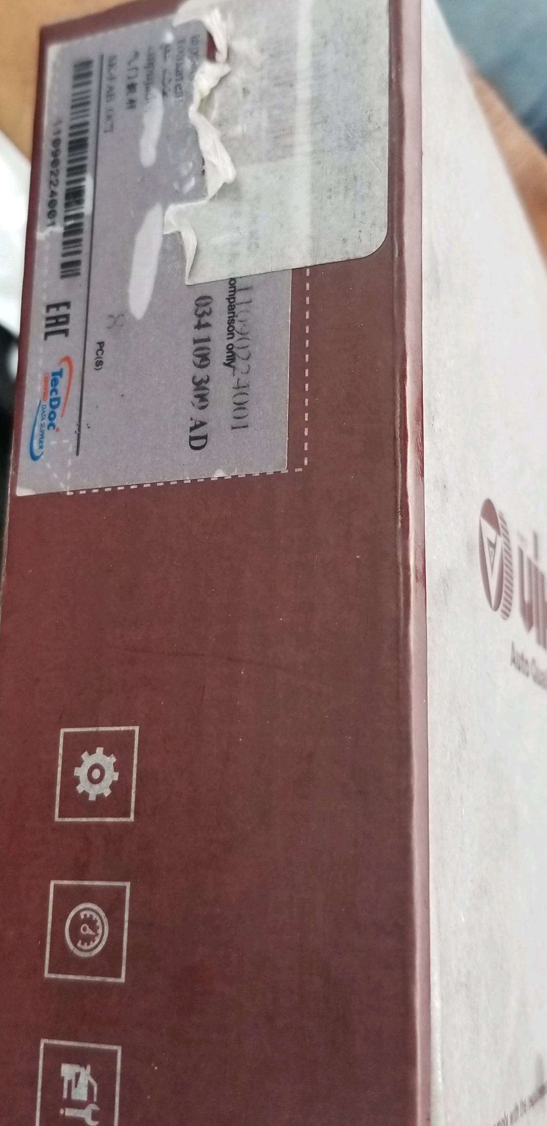

After several disputes with part stores (they insisted in the part number 038 which is for the tdi)  i was able to get the 034.
But in two brands
Topran and VIKA
I dont want topran
Have you ever heard the second one?

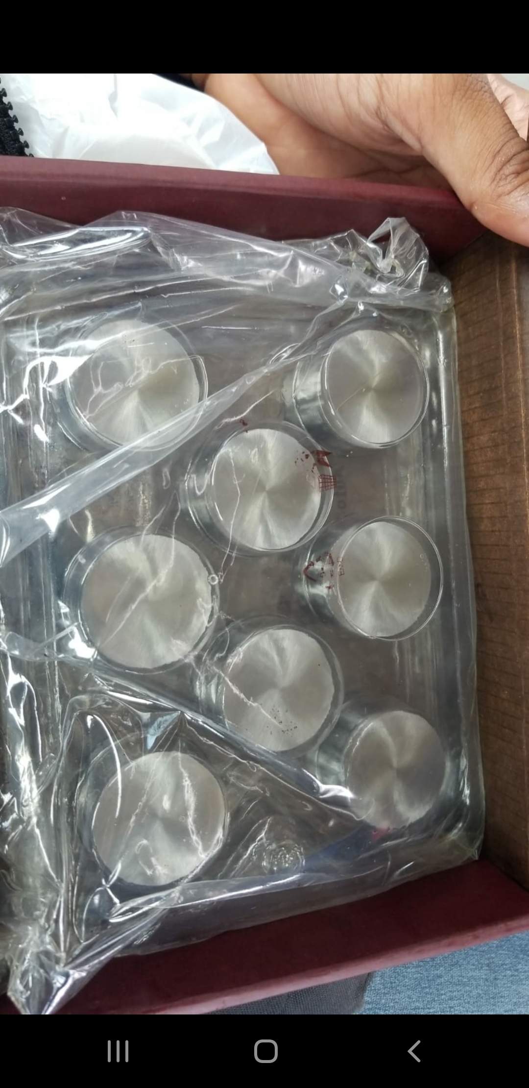

No, I have not heard of VIKA, but that doesn't mean they are bad.
They look just like new lifters to me, I've used Topran before and they're OK as well.
