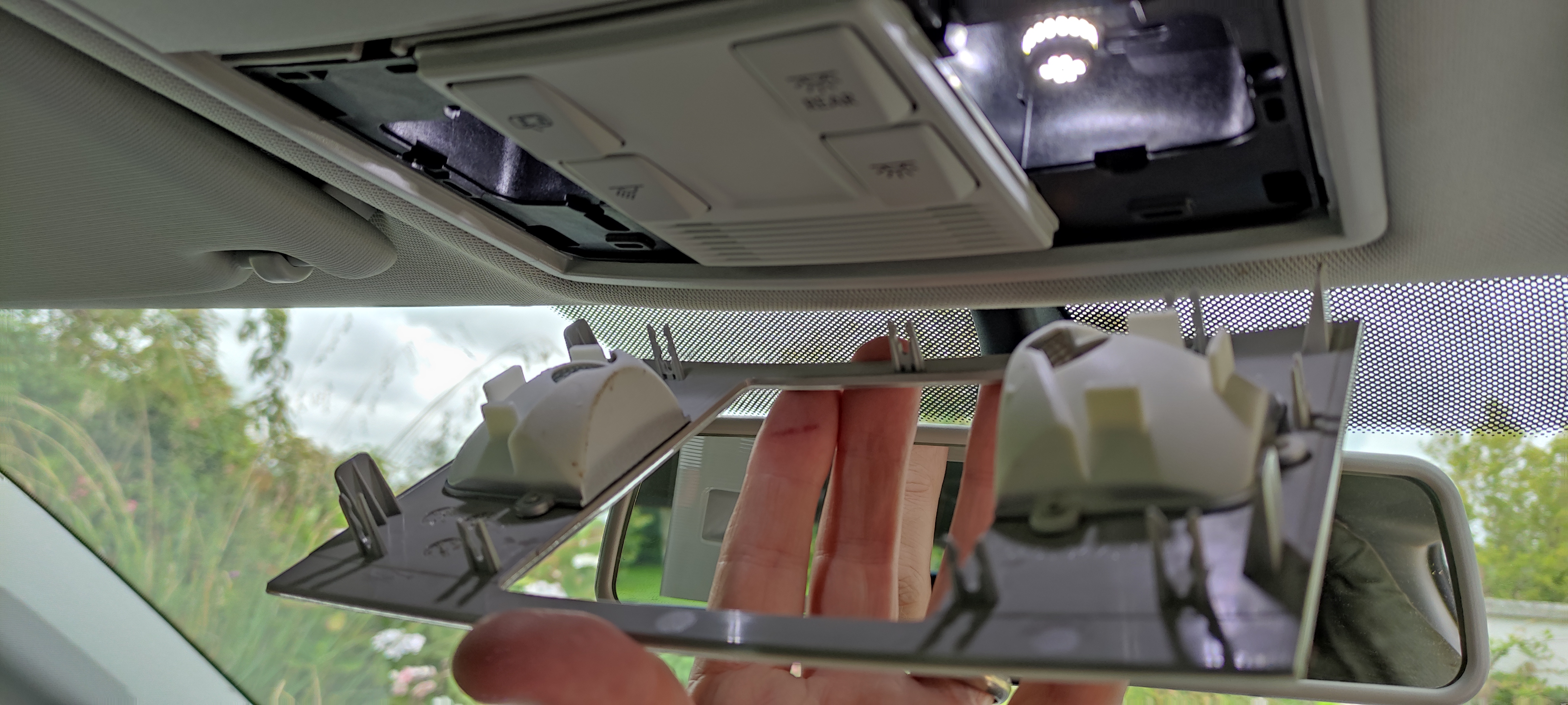

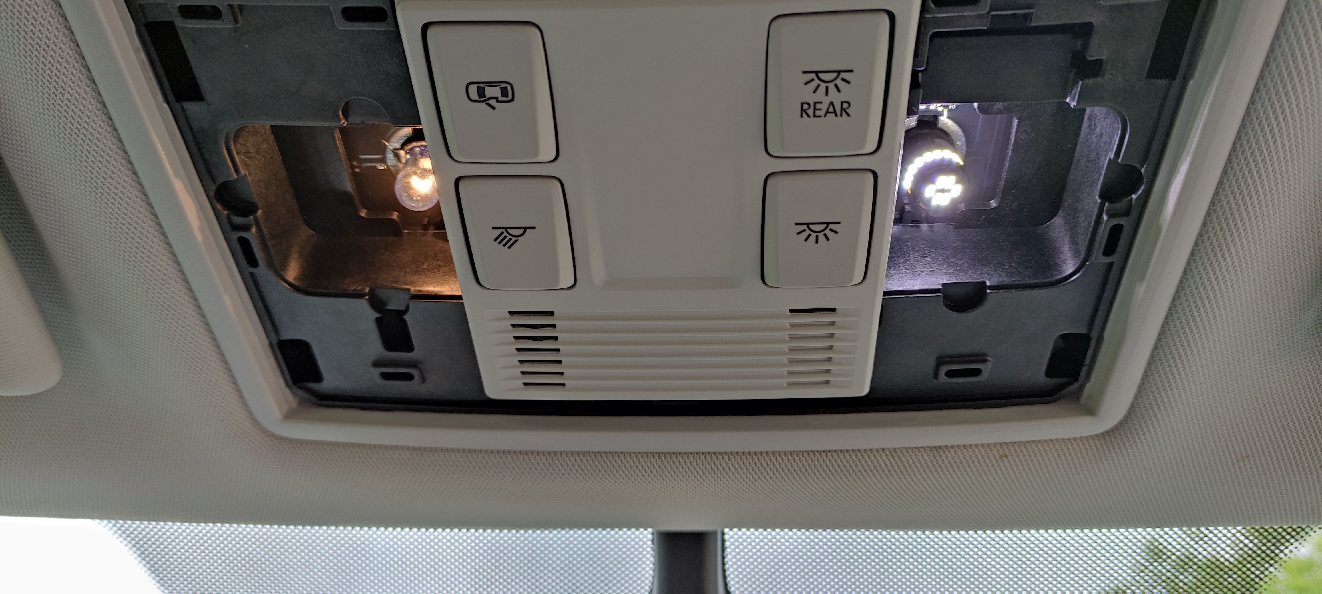

Photos attached. Be super careful when removing the front light surround. The two narrow plastic strips in the centre of the trim could break very easily. In my case I lowered the sunglasses holder which allowed me to to get my fingers on the trim and slowly prize it down, from the back of the car to the front of the car.
The rear reading light was very easy to remove, pull down from the rearmost edge, the fronts have two tabbed sliders and it just drops out. Disconnect the connector. Then with a couple of plastic removal tools push in the various tabs on the back side to slowly release the cover. Then to have access to the bulbs.
