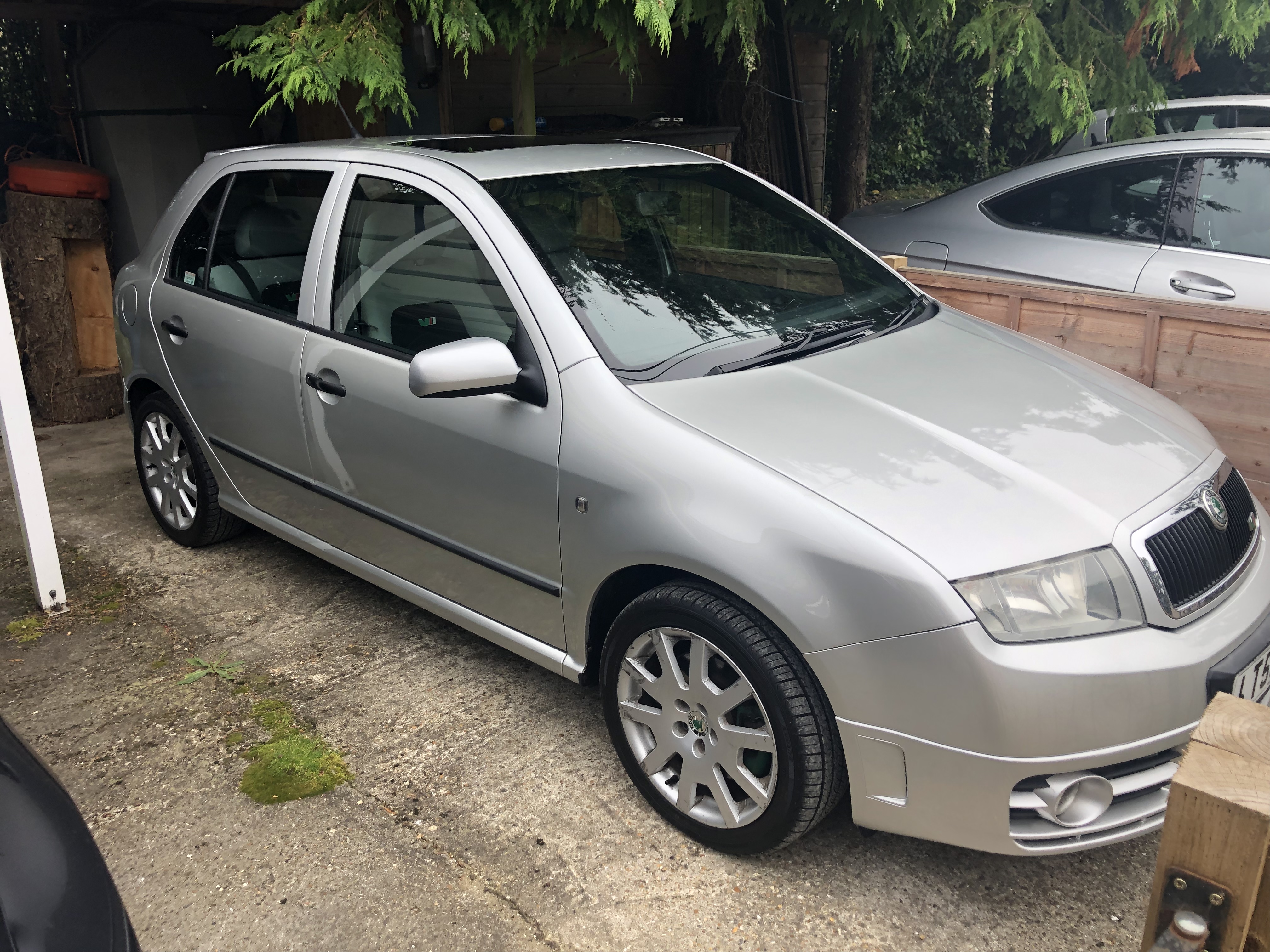

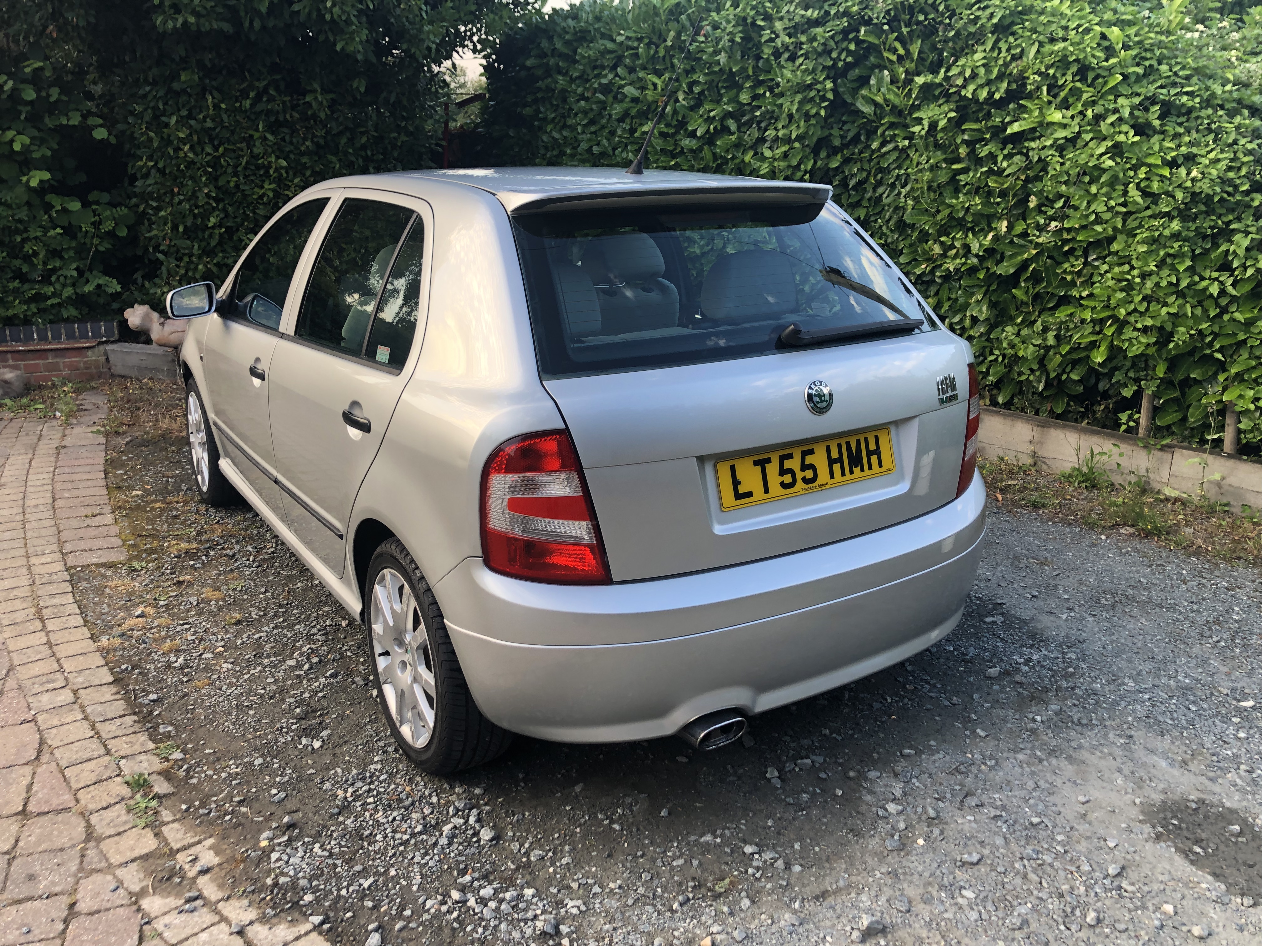

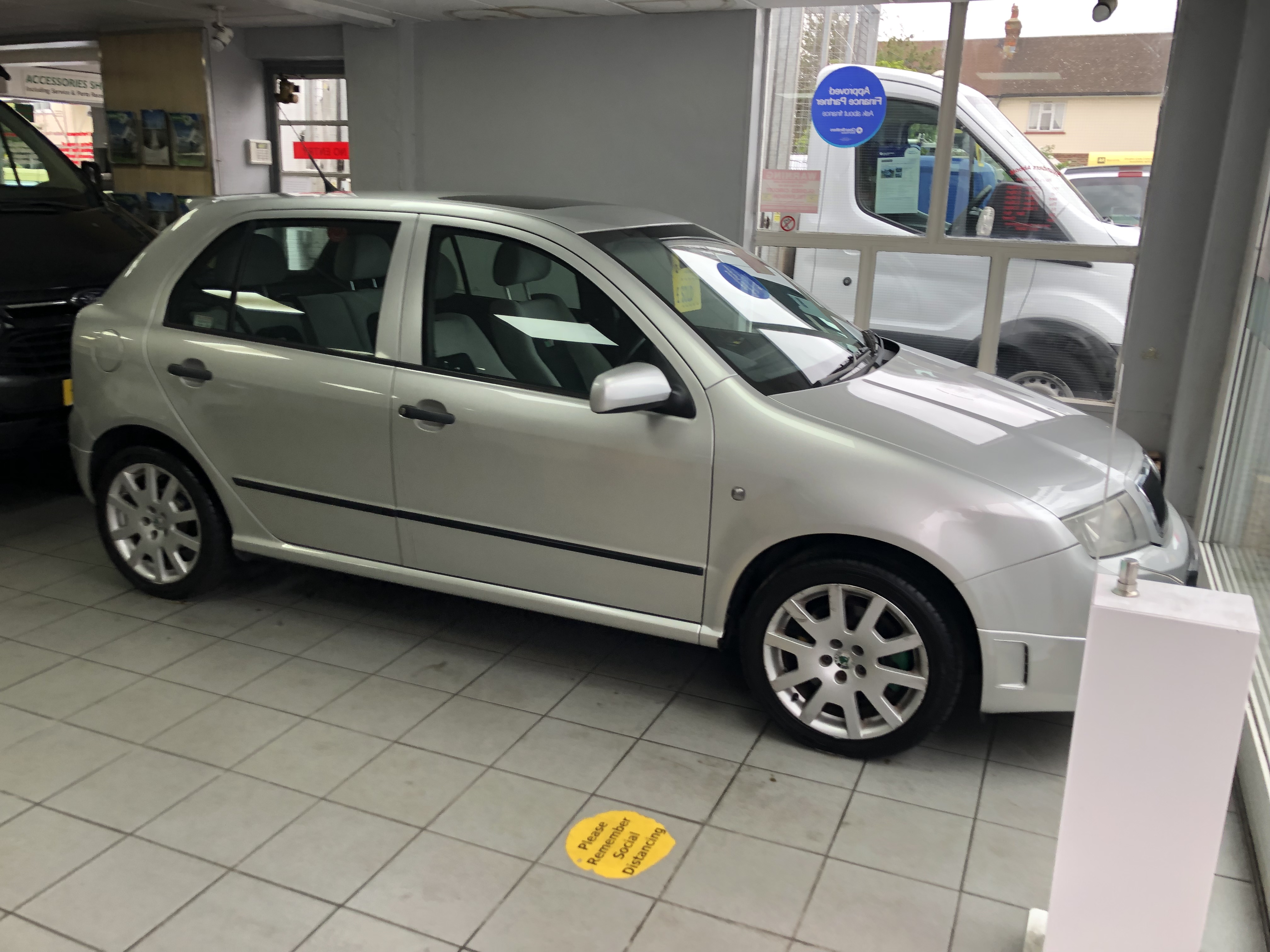

2005 VRS

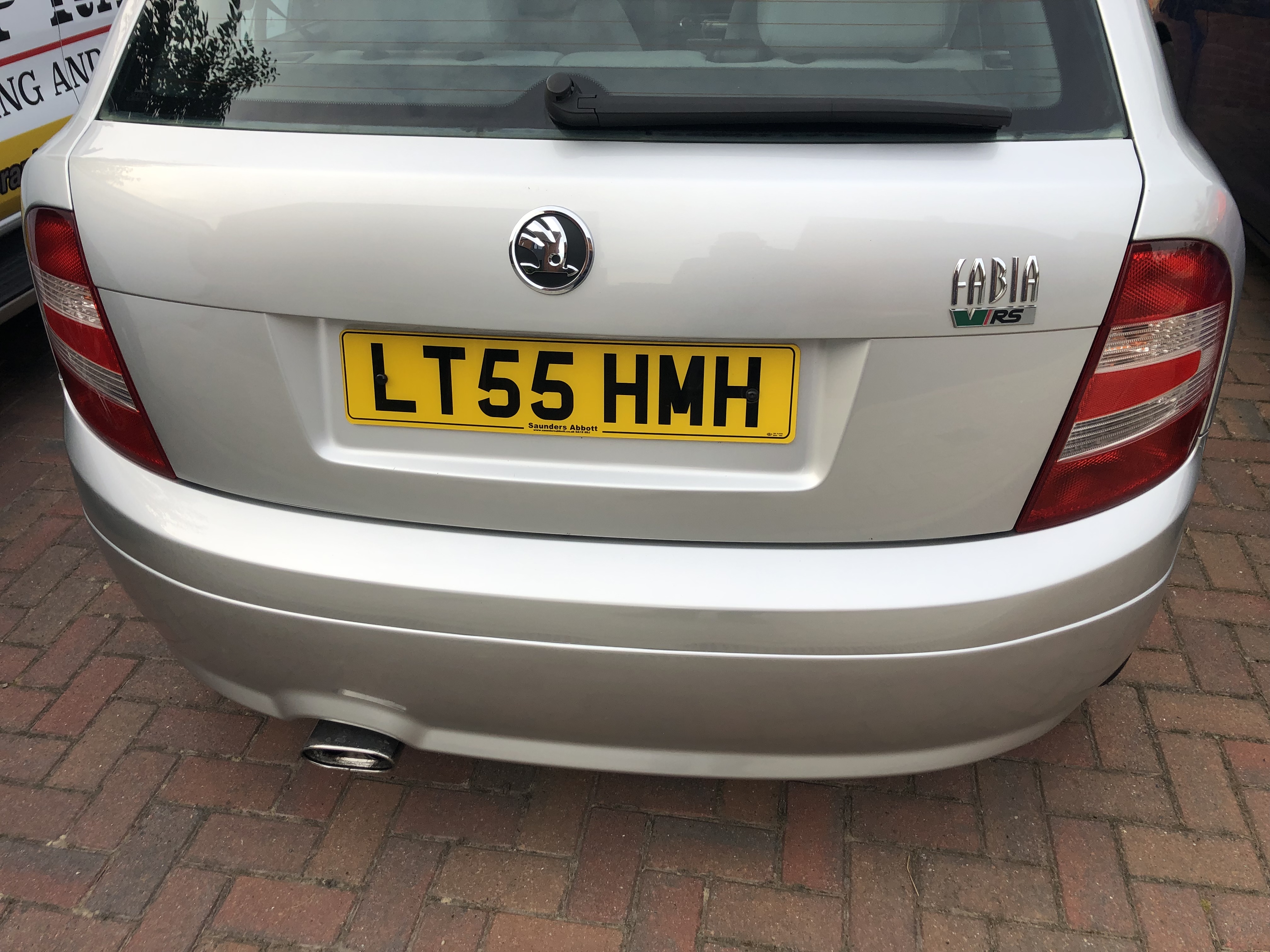

Tidy. Have you still got the old badges and would you be willing to part with them Pete?
How hard are you going to have to resist to do full on restoration?!😄

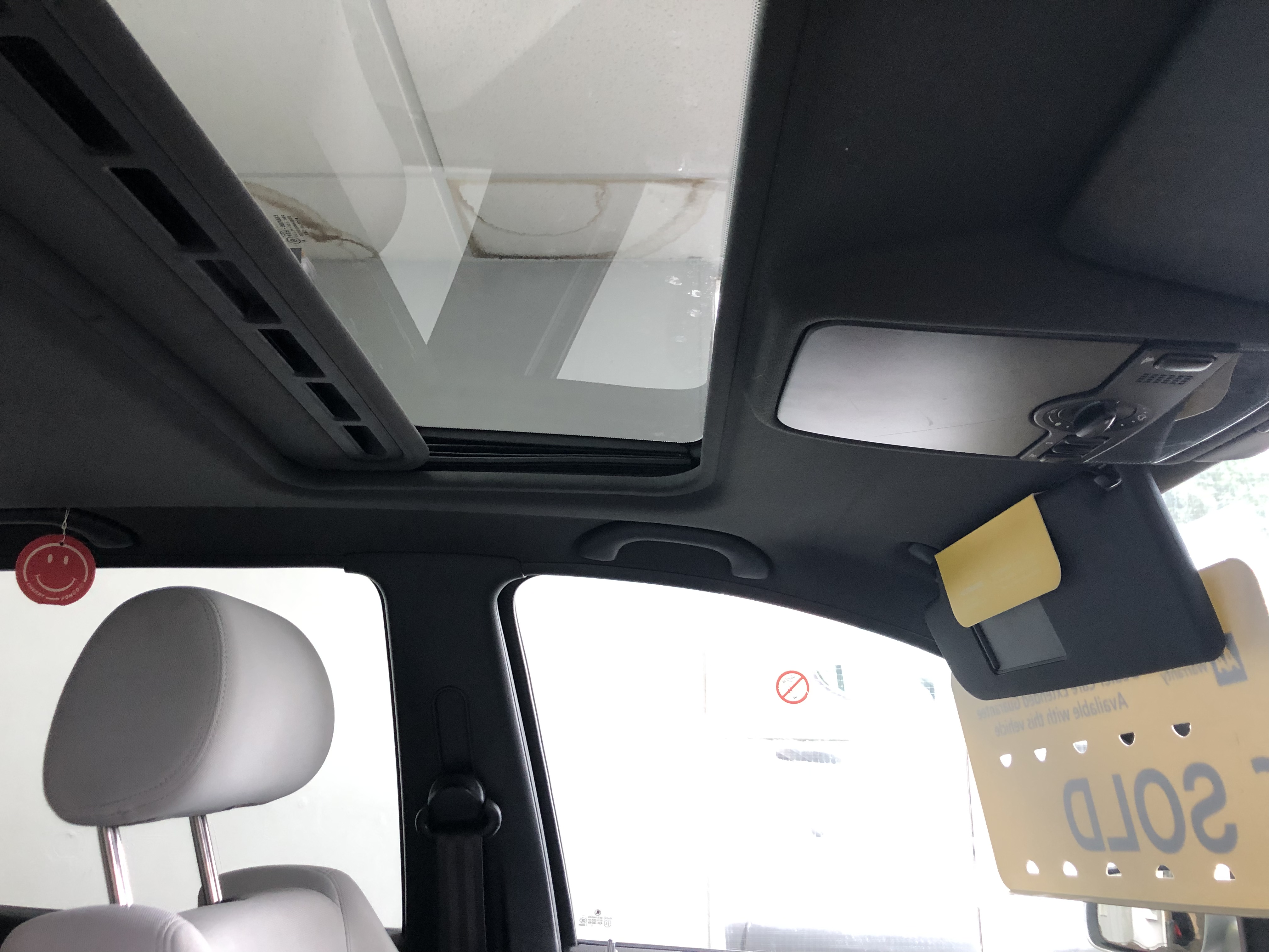

Tidy sunroof car looks like a good base.
Nice to see a little Fabia with a sunroof! Looks like a very mint car indeed!!
It’s not mint but anyone that knows me will know what it will become. Watch this space lol 😂
Old badges were horrid and now in the bin sorry buddy.
That's alright, thanks. Mine has the new style ones on but I fancy putting a little bit more colour back with it being black.

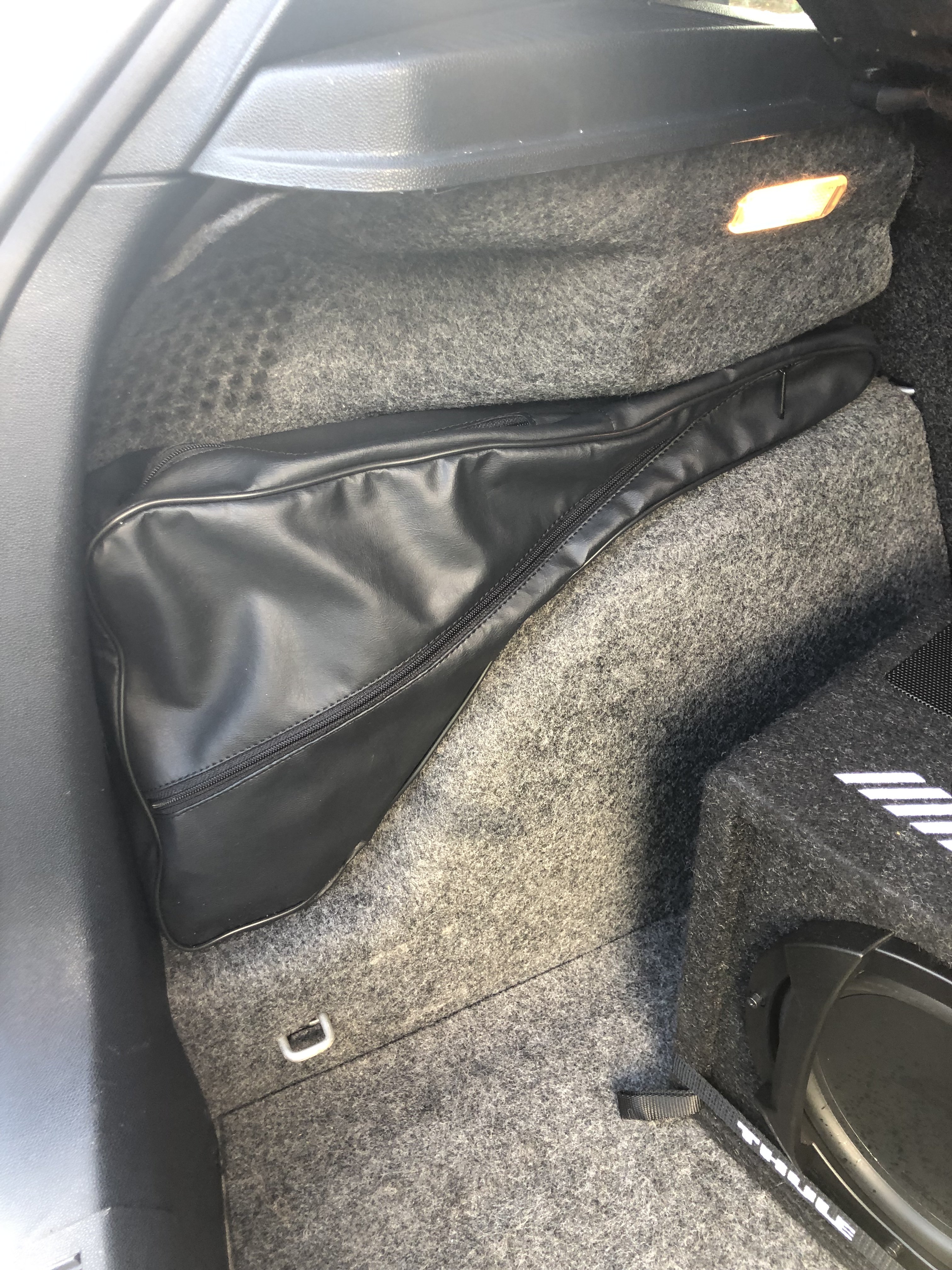

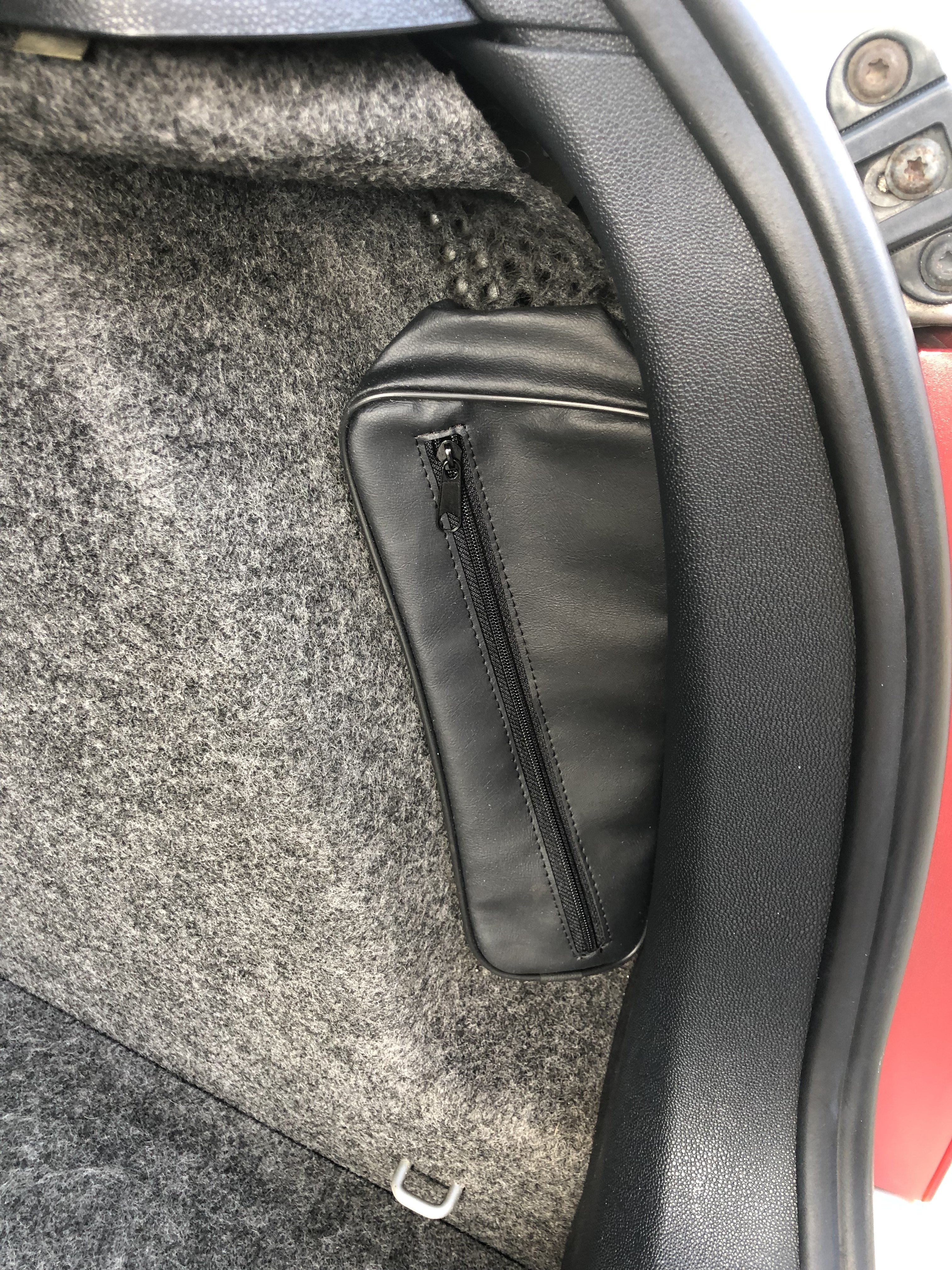

New old stock genuine boot bags
Where did you get those from?
From my great Skoda spares stock why do you want some ?
I've been looking for some actually for that little extra storage!
Those must be a rarity these days.

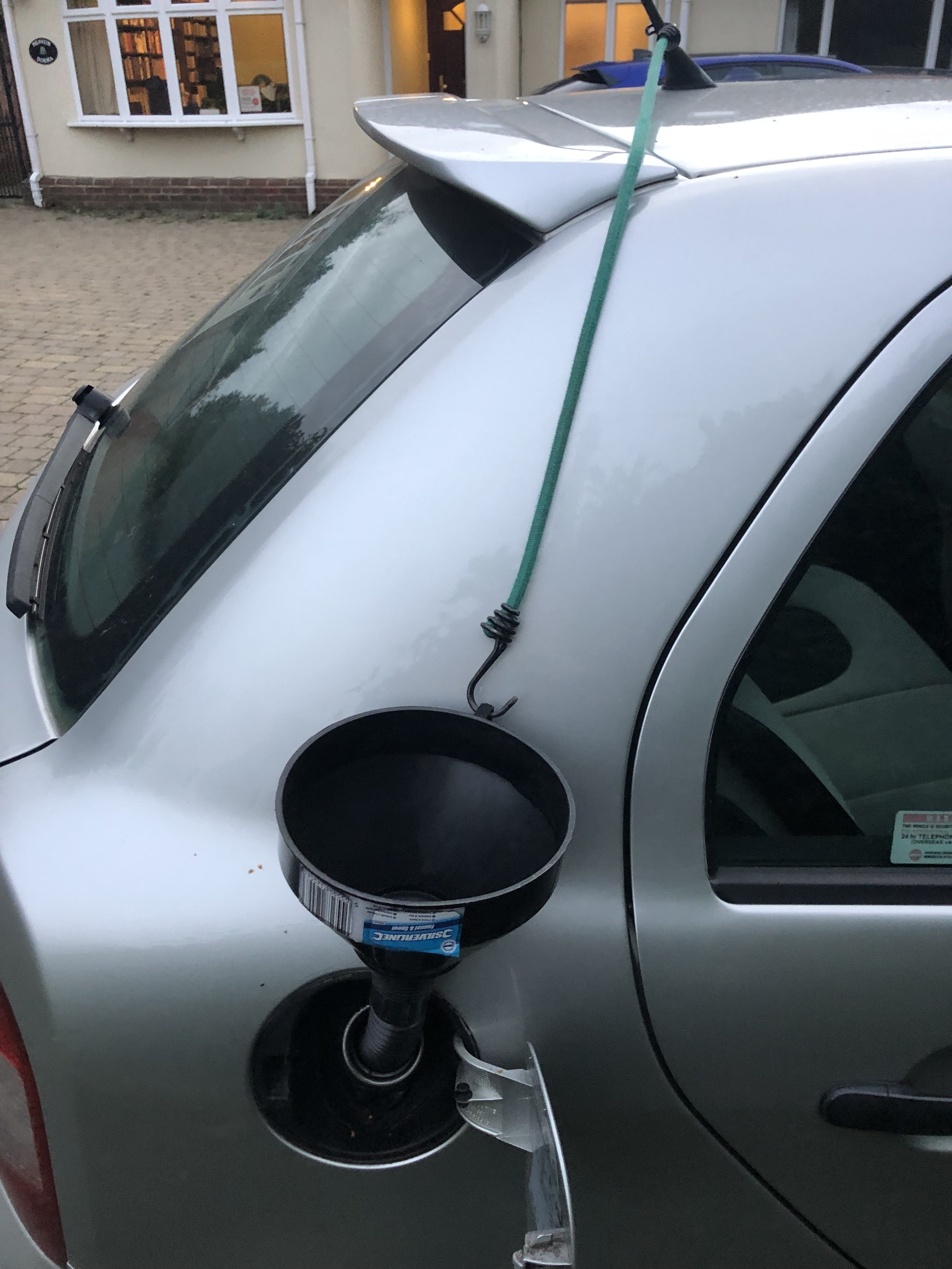

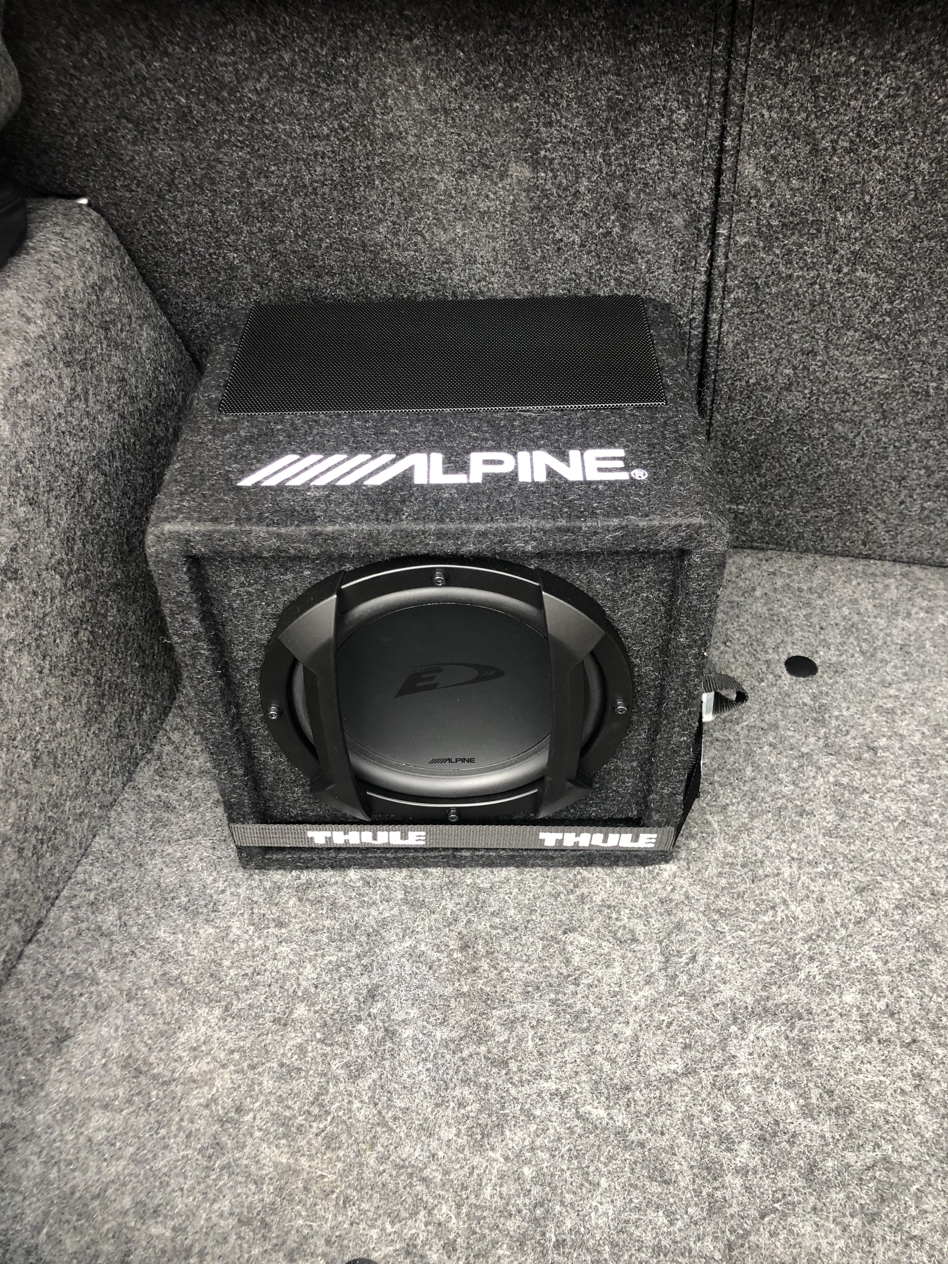

Problem solved lol
On 07/10/2021 at 20:25, group1rs said:
Problem solved lol
ha ha - this reminds me of how i used to fill mine up on a trackday, keeps the funnel in the right place for sure for some jerry can action.

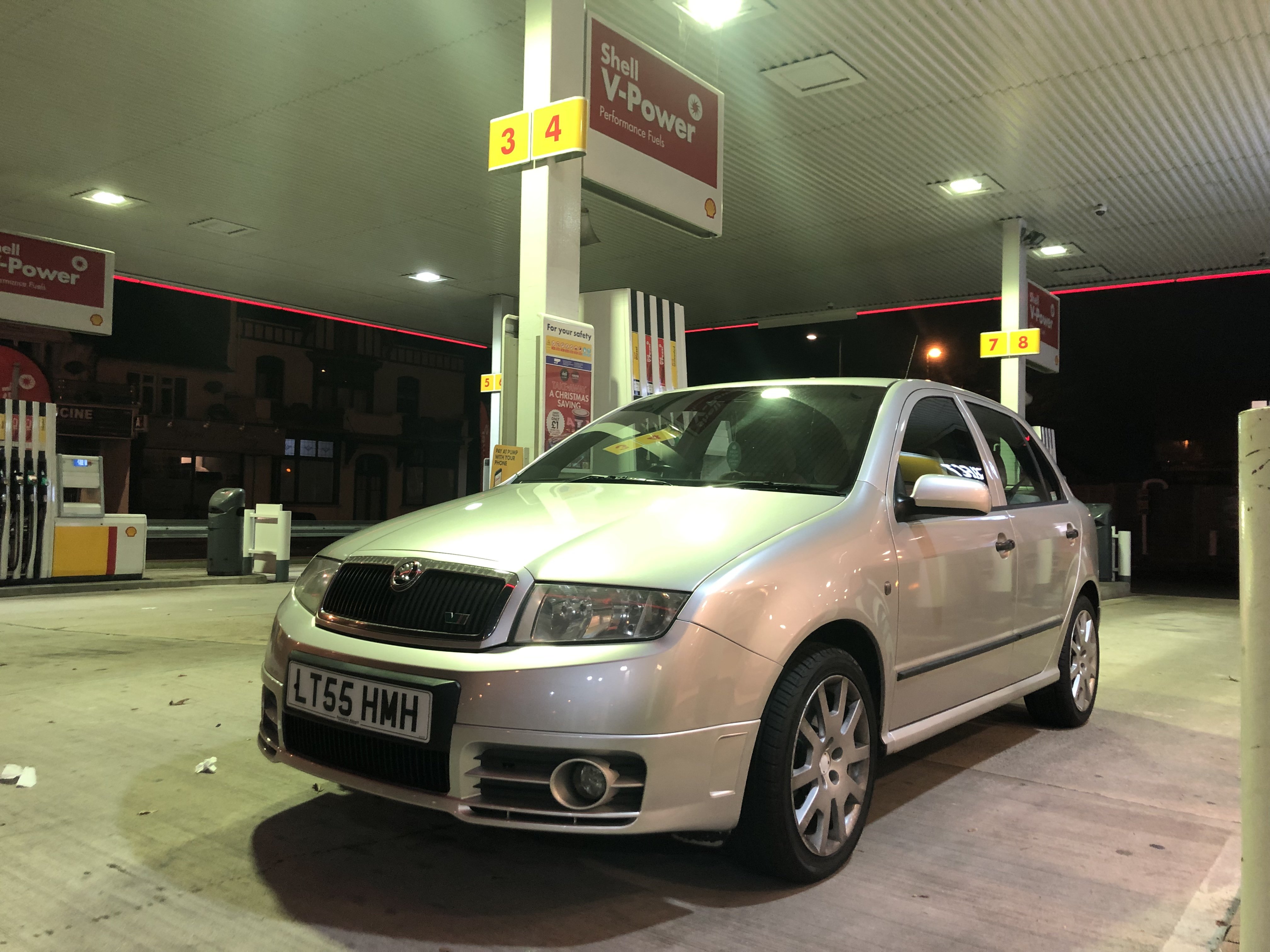

No news really. Just fill with V Power and enjoy

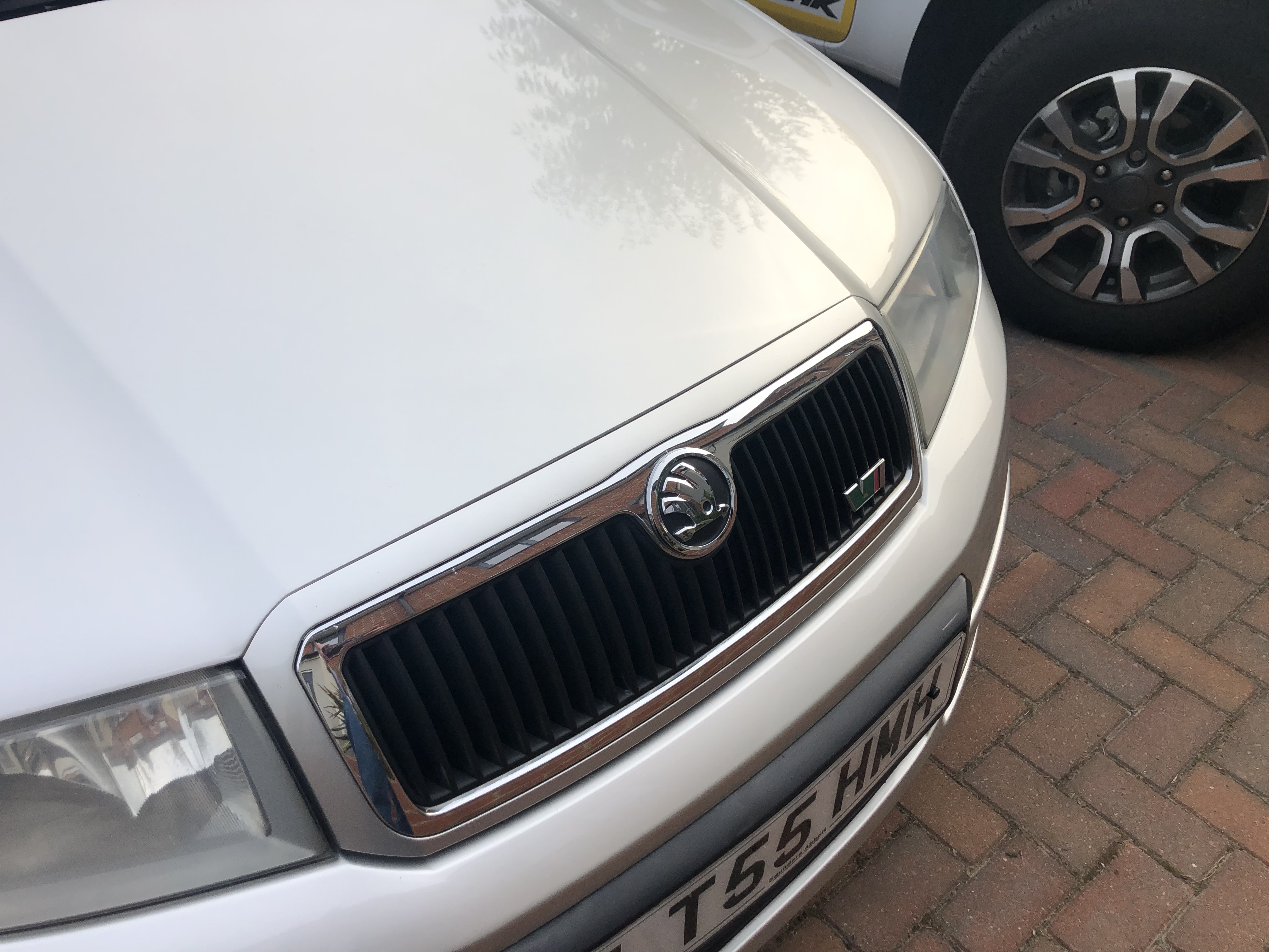

It's looking good! You could do with a set of centre caps by the looks of it. These take a wee while but the older style badge ones I bought were good. :)
I have No news really. Just fill with V Power and enjoy
I have new wheel centre caps will fit when I get wheels refurbished

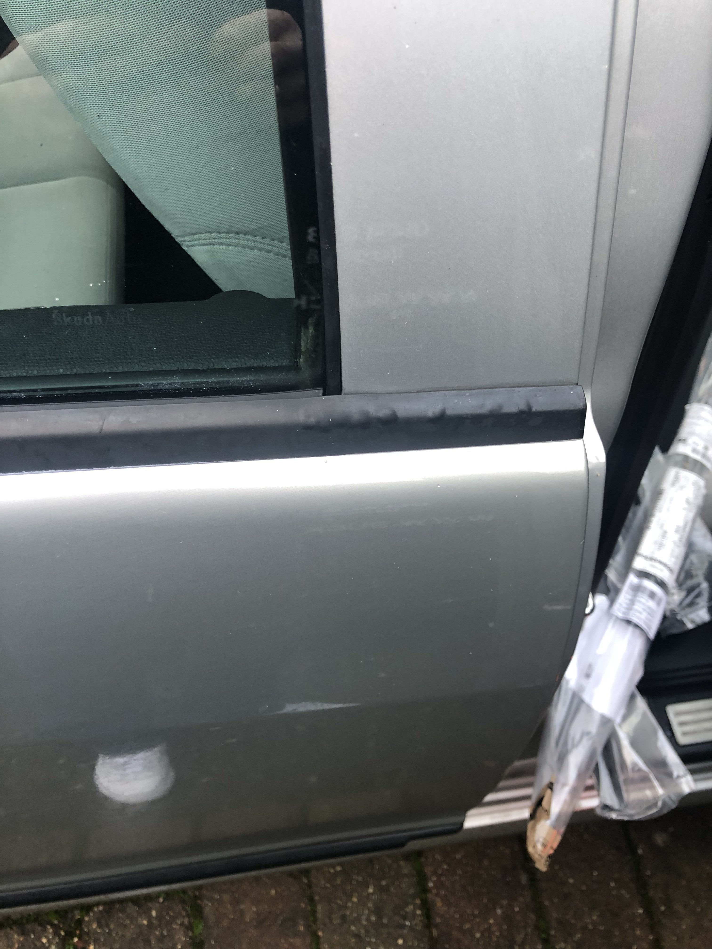

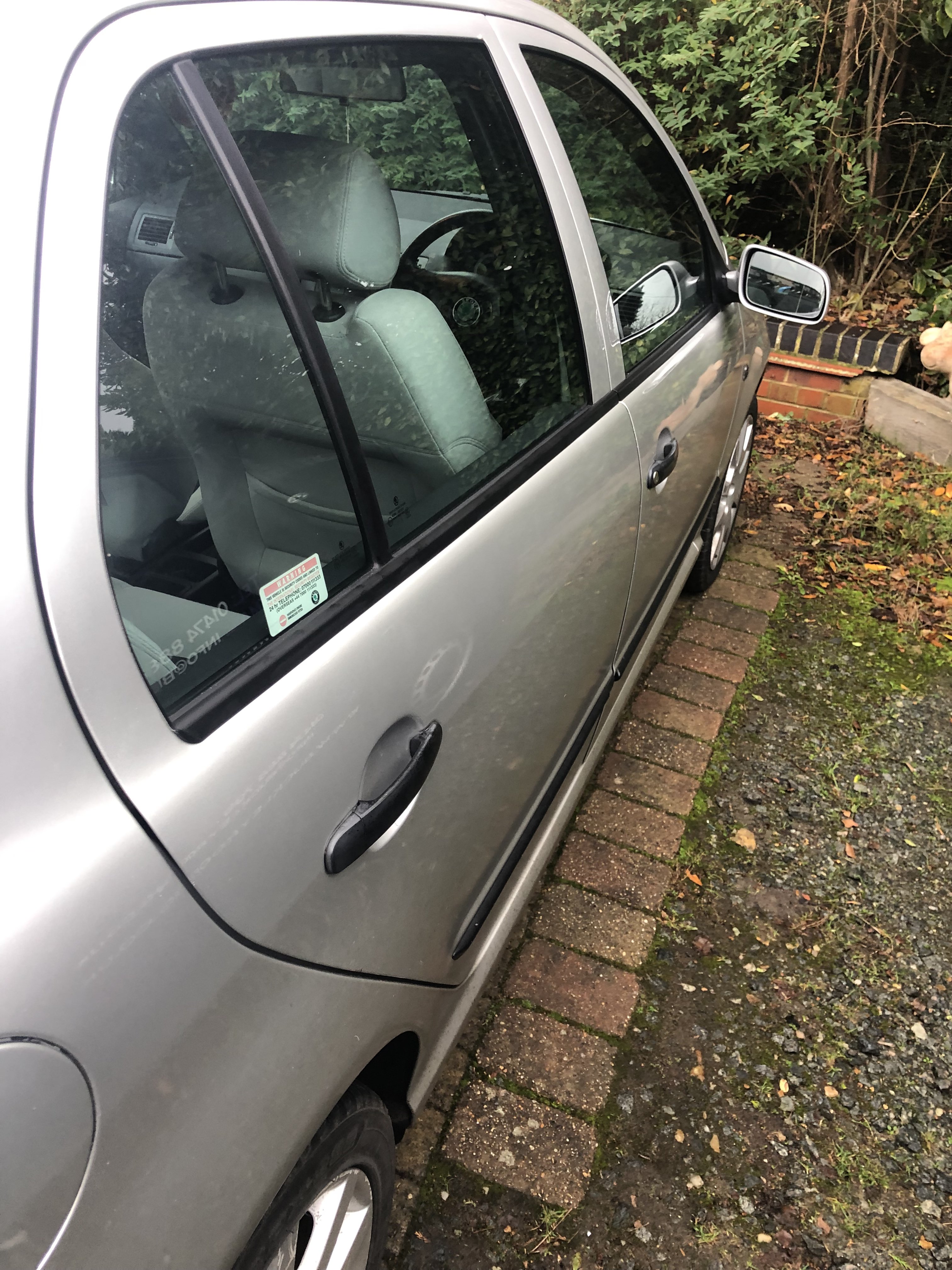

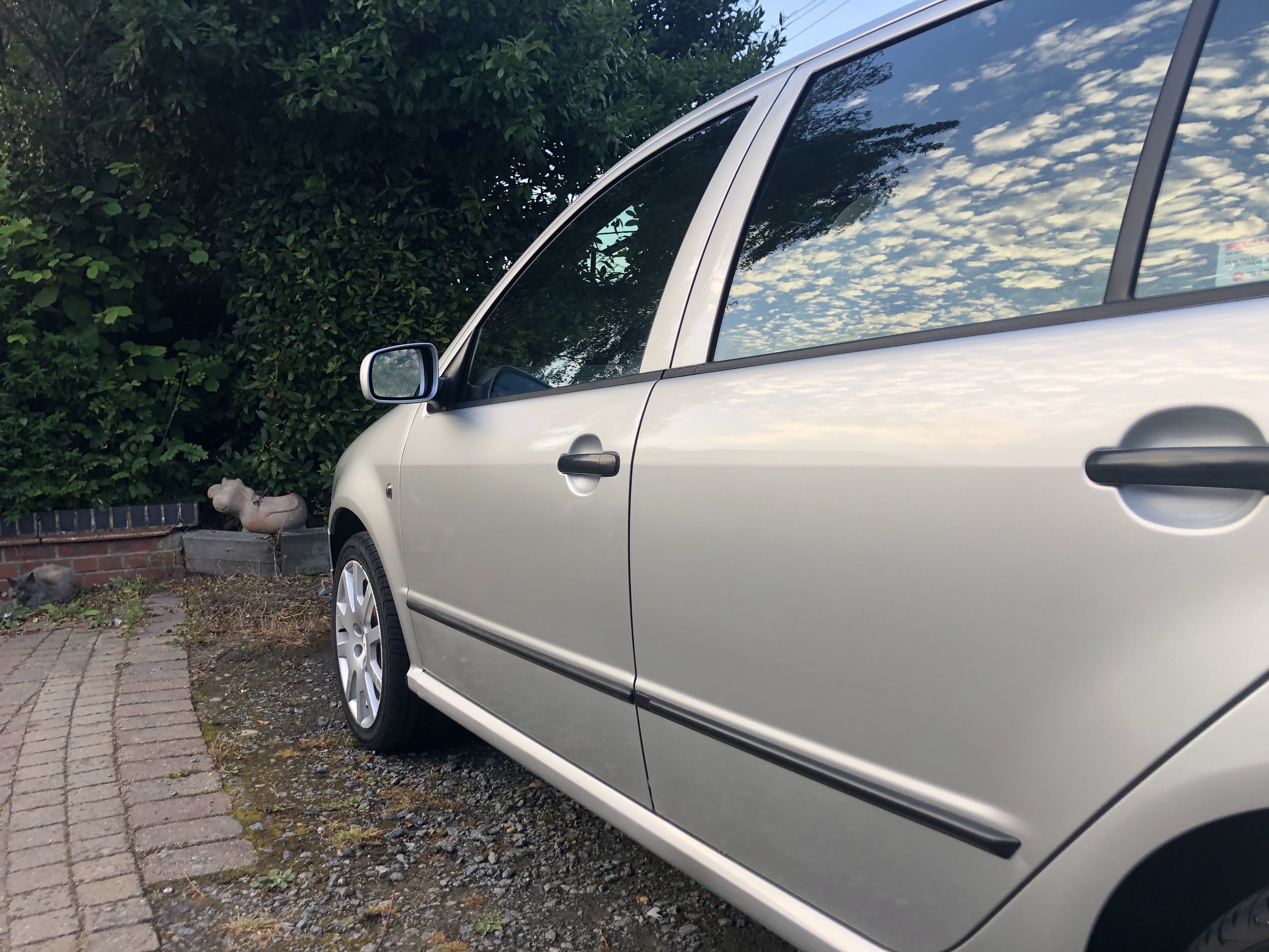

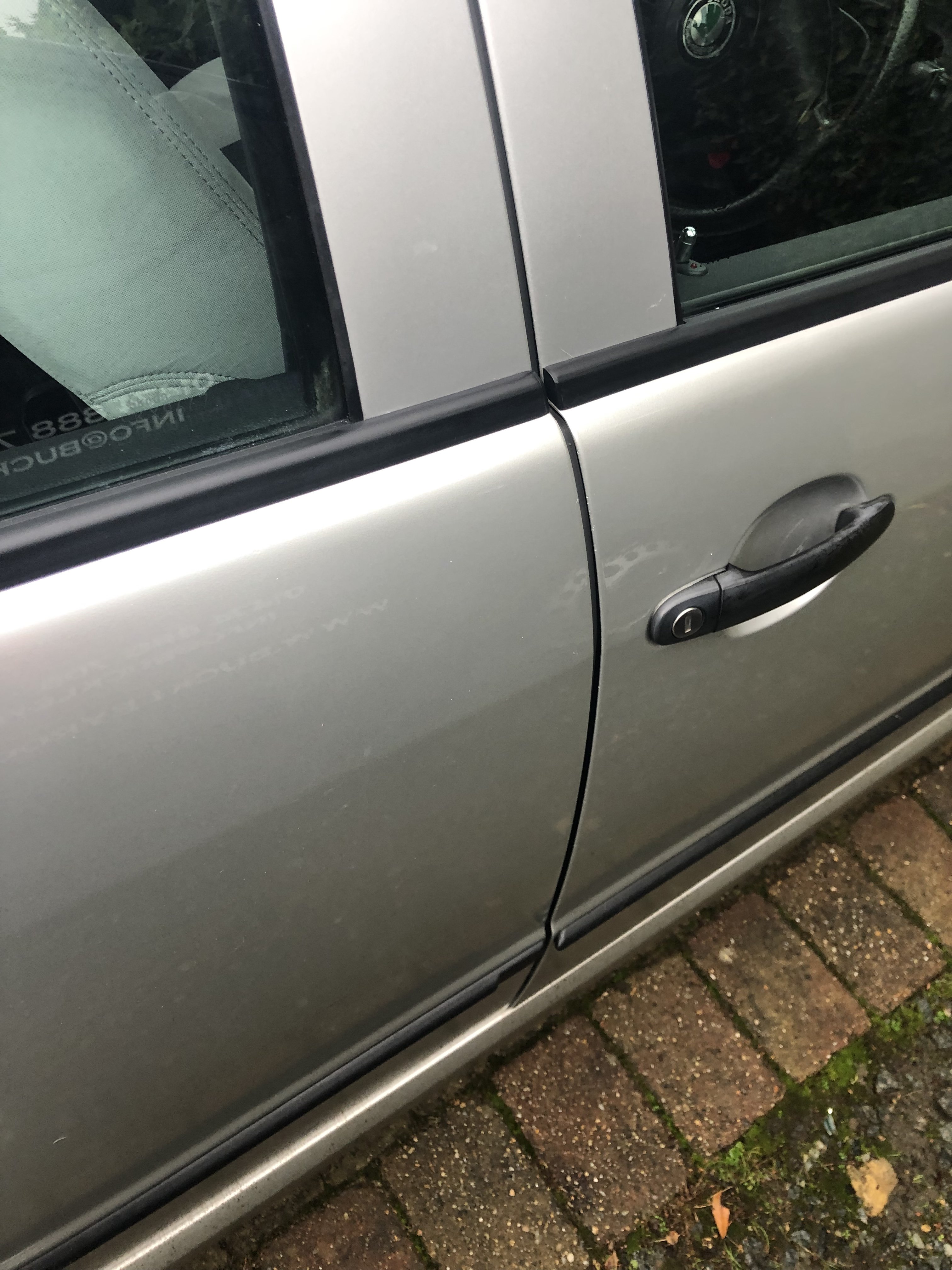

Exterior window trim time. The original ones had started to bubble and were annoying me ! So full new set ordered and fitted. For anyone that also has this problem the part numbers are.
6Y0 837 477A
6Y0 837 478A
6Y6 839 477A
6Y6 839 478A
4 minutes ago, group1rs said:
Mine has bubbled that exact way in the same place. Thank you for posting the part numbers! :)
Could you tell me where you got them from?
Edited by AnnoyingPentium
I got them from my main Dealer. £57 for all four including the VAT
When fitting you need to be careful not to break the B pillar plastic clips. As the clips are no longer available
Thanks! I'll head out to Ingram Skoda in the new year.
Right cheers. I'll need to be watchful of that then, maybe I'll get someone a bit less brutish to do it. :D
