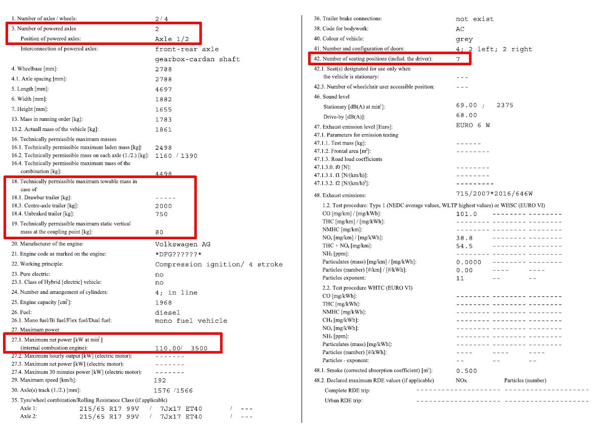

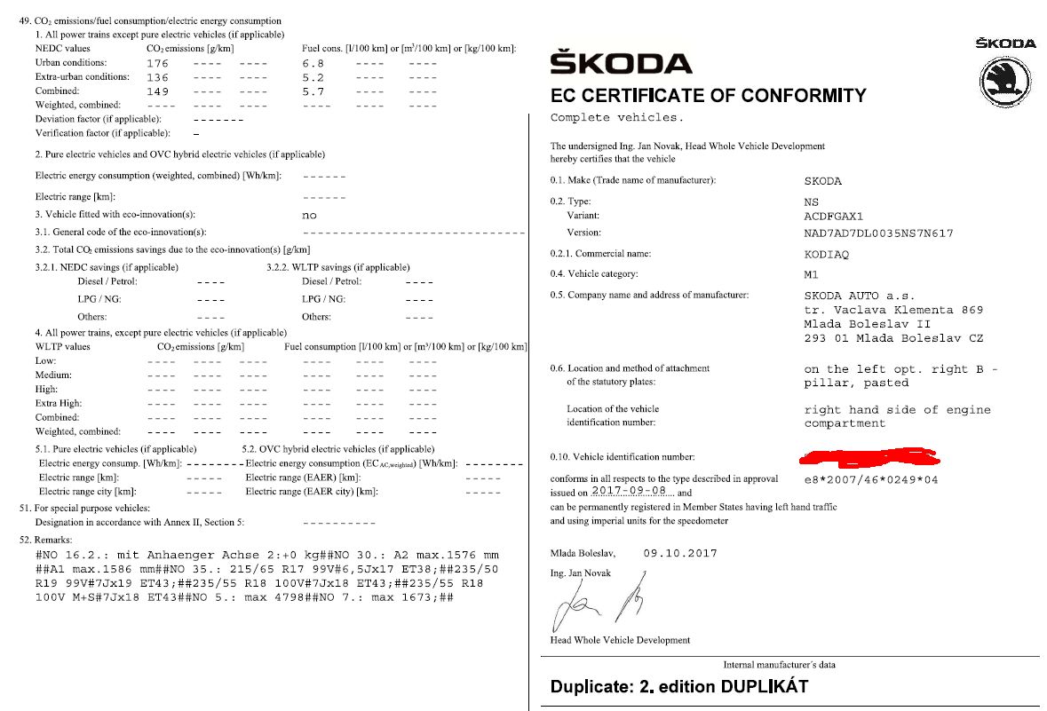

In my experience, getting technical information out of a salesperson, is a hiding to nothing.    Get on to Skoda Customer Services and ask for a "Certificate of Conformity" for your car.  You're entitled to a free, paper one, but if one has already been issued for your car, they're allowed to charge for a duplicate, so make sure you haven't already got one.  It's a single sheet of A4, with loads of technical and regulatory data on it.  (See attached).  Fields 18 and 19  will give you the type approval information for your actual car (the VIN will be on the front of the certificate).  This is the definitive legal document.  Nothing else matters.  Forget what you hear on internet fora, from owners or salespeople!
