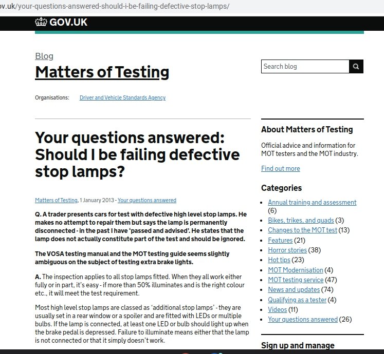

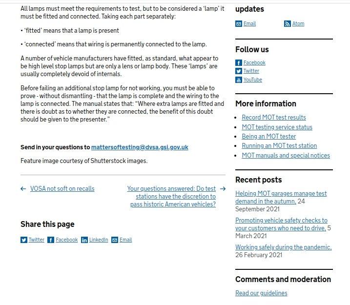

An oldie but goldie from 2013.
Thank goodness you posted the content of that link that @briscaF1 posted earlier, I was utterly incapable of clicking on it for myself...
@sepulchrave  Sorry missed seeing that link, but no harm done is there?
No, not now, I'm sure @briscaF1 will be cool knowing that you plagiarised him accidentally and I'm getting used to you facepalming me for calling you out.
