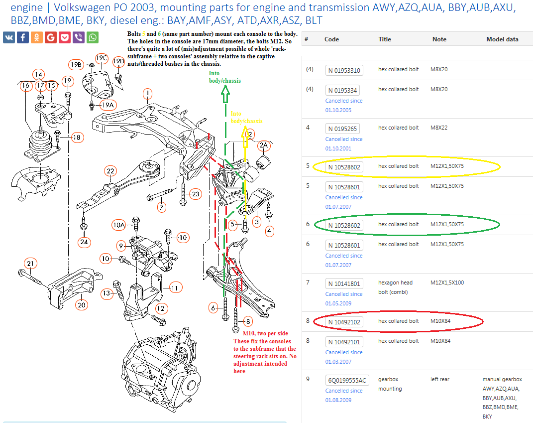

It's the dogbone engine mount rear bolt (item 23 in below link) getting mixed up with the gearbox-to-engine bolts that's usually where things go haywire, mostly during clutch work. It's 61mm long and goes up right underneath the left side of the rack tube. Some of the gearbox bolts are 65mm which is long enough to dent the rack tube underside if switched.
The bolts that hold the rack onto the subframe are the same ones that hold the subframe to consoles I think, item 8 at 84mm long:
mounting parts for engine and transmission - Fabia(FAB) [EUROPA 2005 year] (7zap.com)
Not the clearest diagram in the world ever. I've got an annotated version somewhere that tries to clarify what goes where, but I predictably can't find it just now.
Removing that bolt 23 and measuring from underside to tip would be reassuring/condemning. Very hard to see the point where it emerges under the rack.

In a 'Polo' folder, but I think everything's the same. Red annotations are the console-to-subframe plus rack mounting 84mm long bolts, I think. The item 23 (M10x61) rack-killer one is just about readable in the original diagram with its dotted lines.
The last time I did a rack on a VAG group car I had to drop the subframe and suspect the garage would have done the same, this would necessitate removing the dog bone, so...
  • Sponsor
But not the gearbox, so...no 'similar' length bolts.
