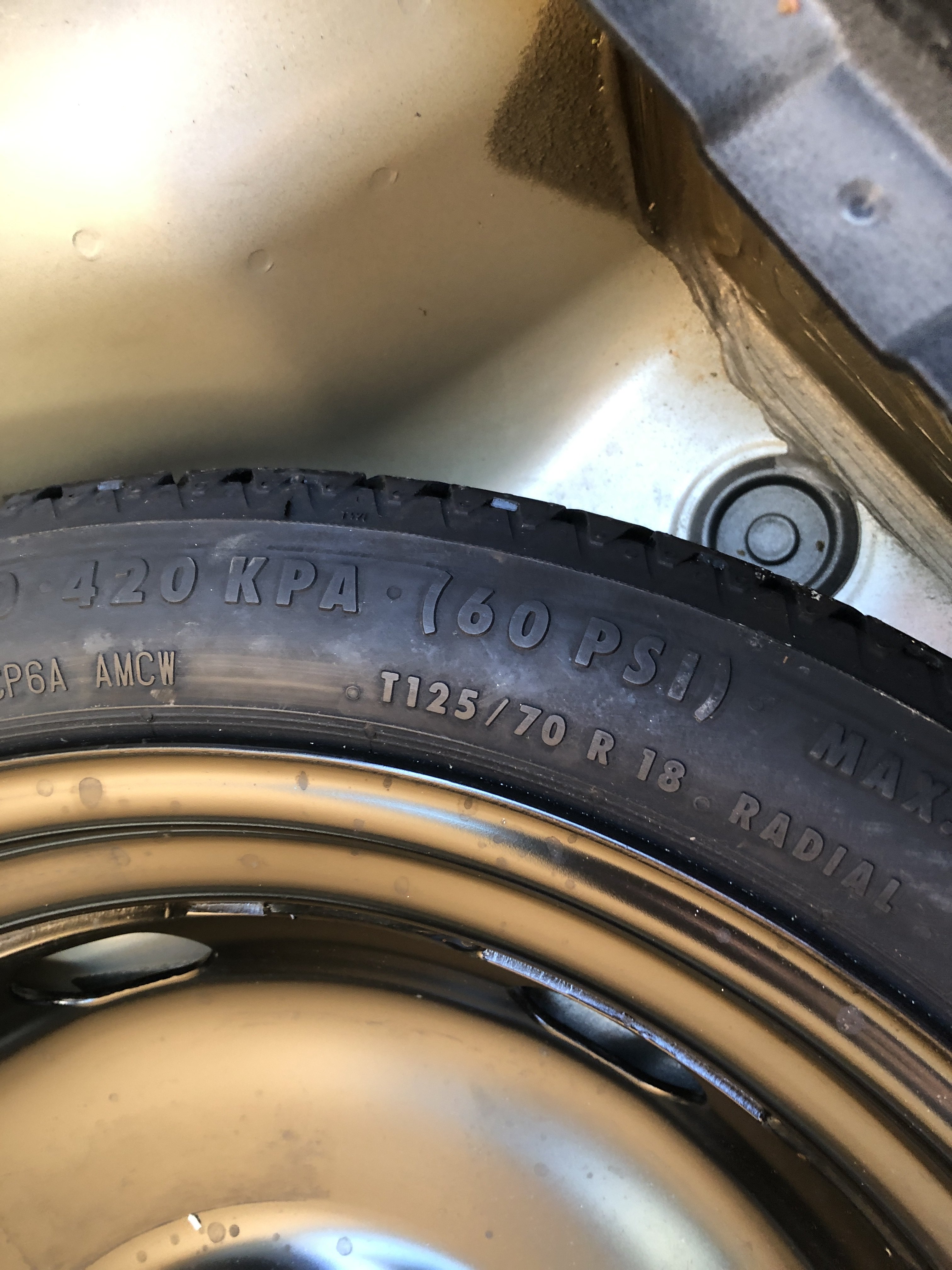

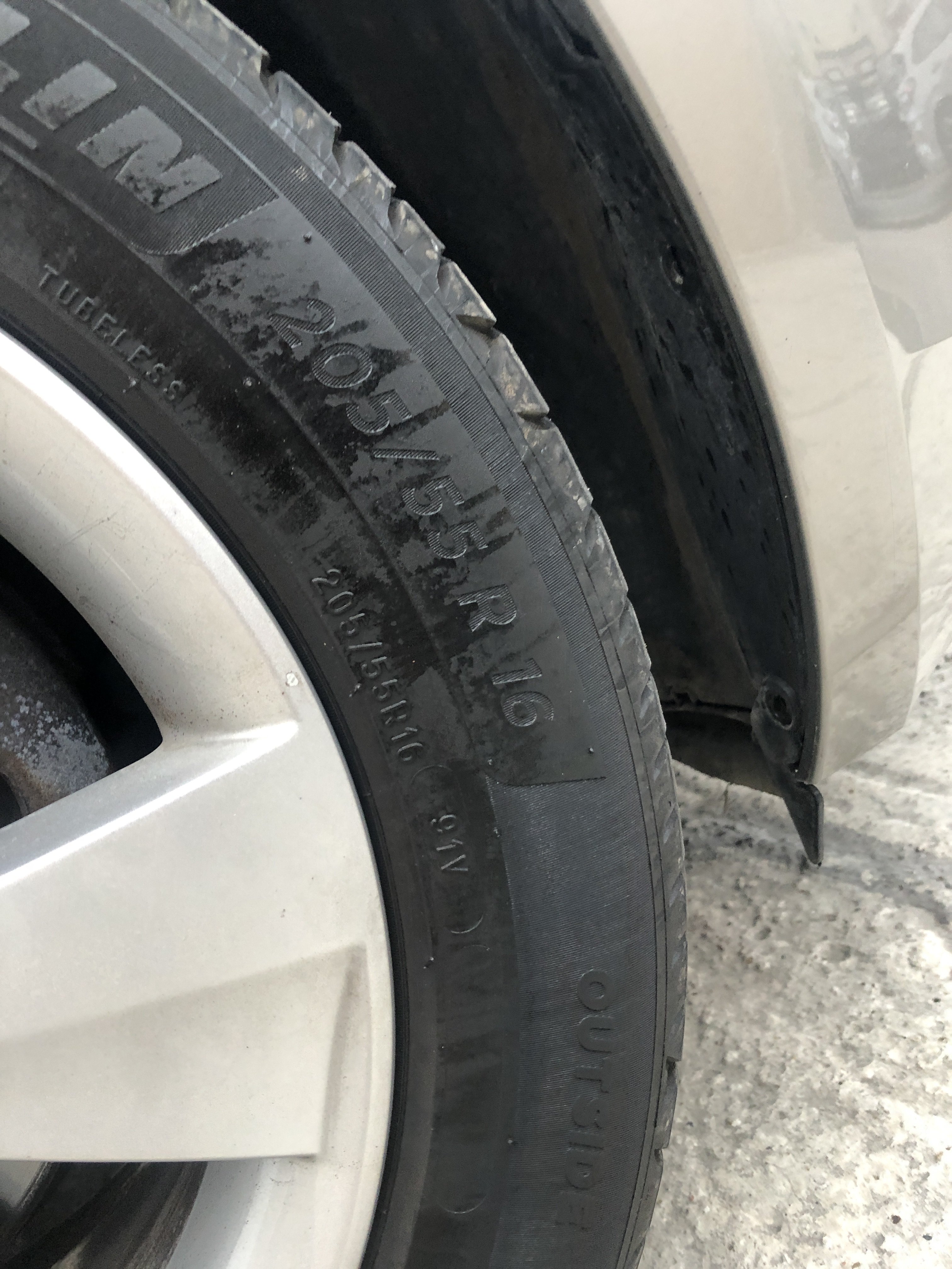

My spare wheel is r18 and all my tires are r16 😧. The spare wheel has never been used. Is this difference a problem?

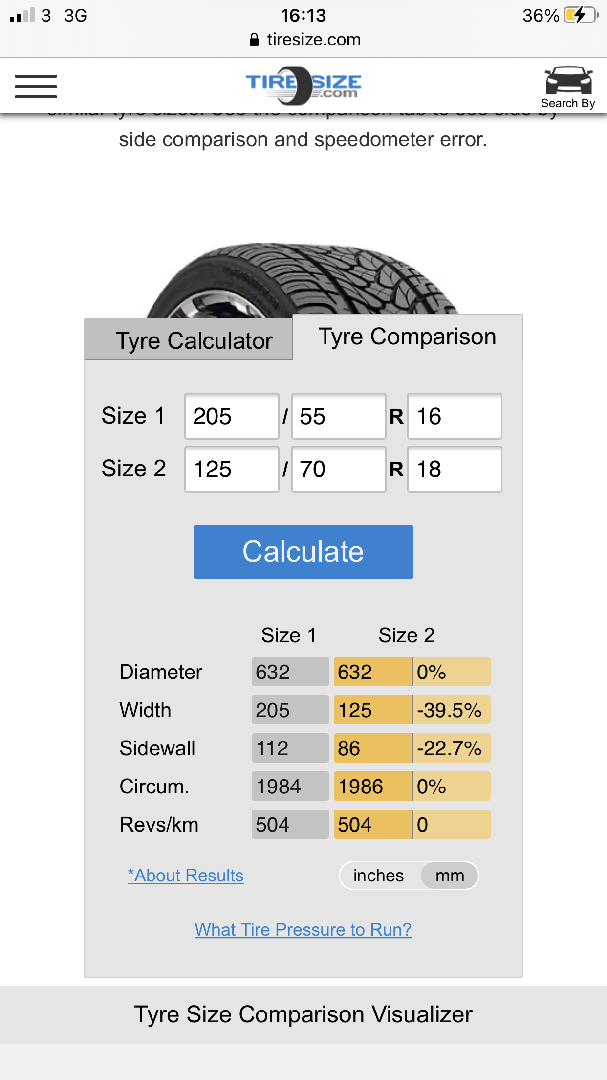

https://tiresize.com/tyre-size-calculator/

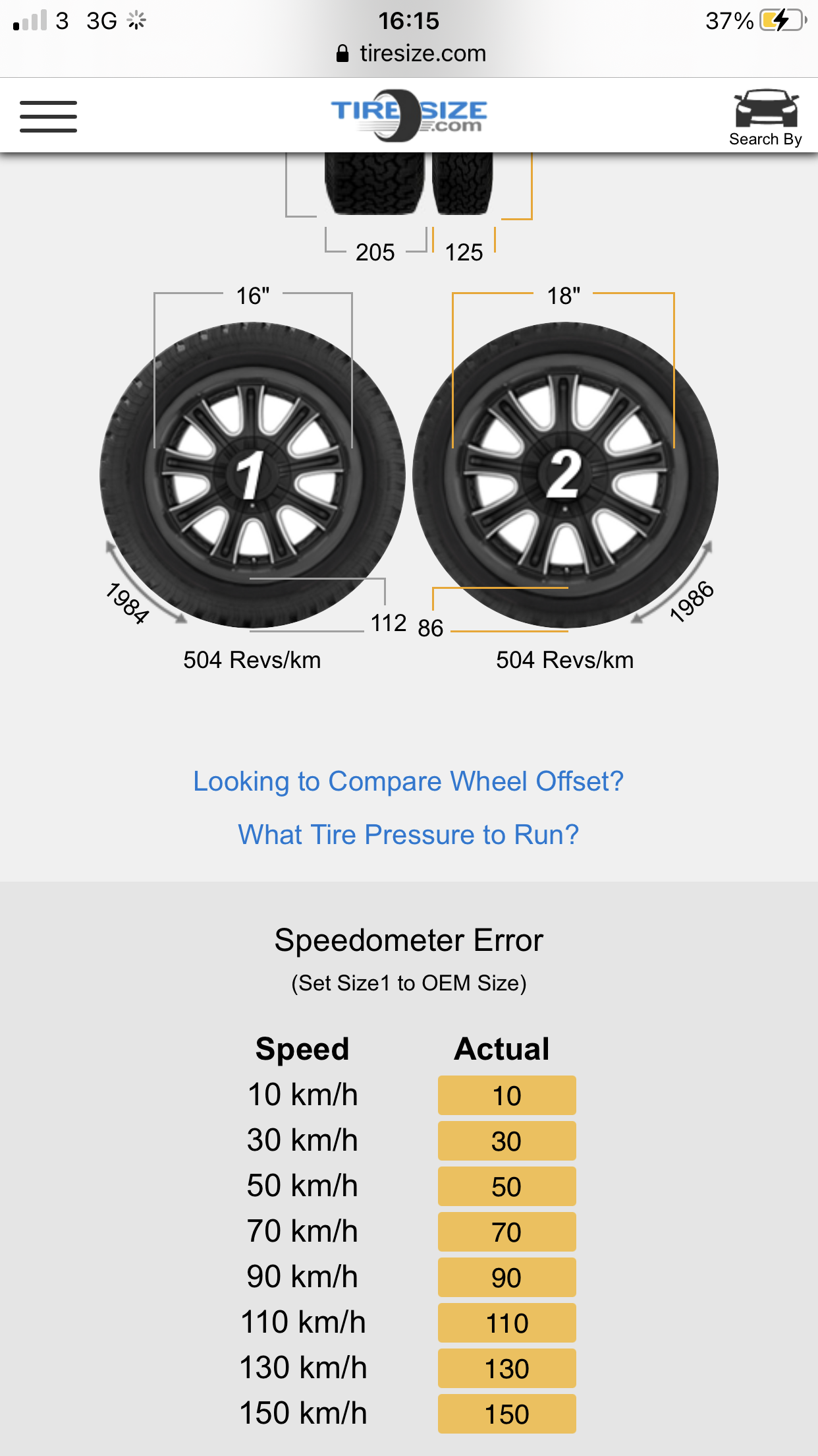

I used the link you provided ( thank you) and it seems to have same circumference , don't know why I thought It was different. Anyway I think is ok as a spare wheel to be used on this car

Its a space saver spare wheel, in order to get the same rolling diameter but with a reduced width of 125mm it is necessary to use an 18" wheel rim, what matters is the rolling diameter and its load rating, the load rating is at a much reduced speed and the rim should be covered by a 360° large yellow sticker warning of that and as a visual indication to any Police that you should not be exceeding 80km/h
It is definitely not a wheel whose purpose was to fit over larger diameter brake discs and calipers.
Does the spare wheel fit flush with the boot floor? If so then if by the means of a moulded polystryrene spacer/tool tray the its a factory fitment, if its 8cm below flush then the original spare has been lost or damaged and replaced with a space saver.

I don't wish to argue the toss, if as I believe it is a space saver spare wheel then its purpose is clear, temporary use at restricted speeds in the event of a puncture.
If the load and speed rating of that spare tyre is the same as the tyres homologated on the vehicle (91V shows on the photo) then what I said about it being a space saver & for temporary restricted speed use is incorrect but I doubt it because why would they have used such a narrow rim if there is space for a full width one?
