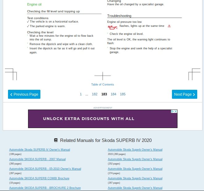

See your owners manual and the warning on overfilling and the diagram with area A.     You need them to correct their staff members error.      It is a problem if the oil level is that high when the oil is checked as per the owners manual.   At normal operating temperature parked on the flat and after the engine stopped for a few minutes.    Not dipped cold.    Some Skoda manuals wrongly say warm.  If overfilled have the dealership remove the extra oil and log their employees error.  And have them say how much over capacity they filled it.     They can send out a master tech or Skoda assist to remove oil. You should not be inconvenienced.  If you have to go to then ask for expenses.  Their hourly rate is fair.  Or they could do the next oil change for free.

Ps, just out of interest have they used VW508 00 / 509 00 so 0w 20 FS IV, or just VW504 00/507 00, so 5w 30 FS III or even 0w 30 FS III,?   These plug in hybrids are not that green needing to be on Fixed oil and filter regimes.     Some run on mostly electric will use more oil than if it was a 2 Stroke. Low petrol and high oil just being put in then changed each year or 9,400 miles.

It take it you pay for the service or paid with a plan.  Best you know on an invoice what goes into your car and what price   the cheaper old spec or the newer oil which is more expensive.    Or do they go with VW502 and the Fixed service interval oil, cheaper again by a little.       The recommended oil is VW508 00 for your car for lower emissions. That is what VW group did for the WLTP and RDE.    But seeing as they are on fixed services some dealers might just decide ignore that and use VW504.
