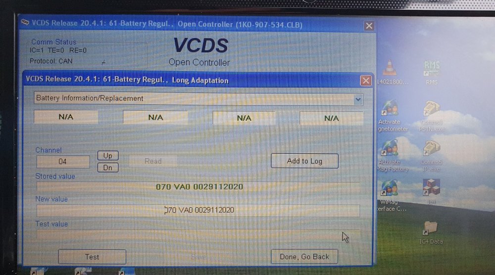

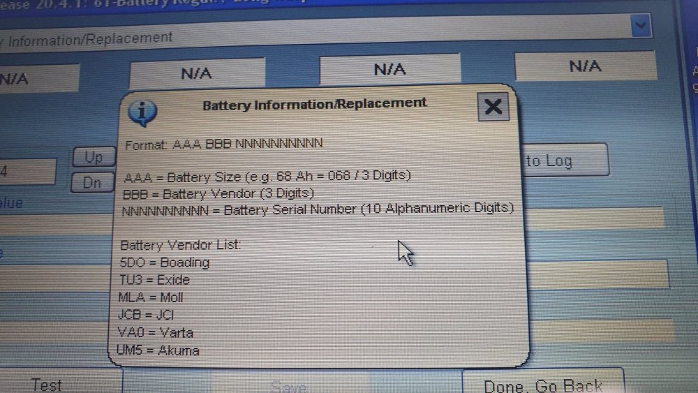

I'm still going to do the coding on every battery change. It is so easy to do, takes about a minute, it takes longer to swap the battery than enter a few settings. So the point of arguing about it seems pointless. It needed doing for me anyway due to the battery type swap from EFB to AGM. A different battery type must be needed info as the charging profile would be different.

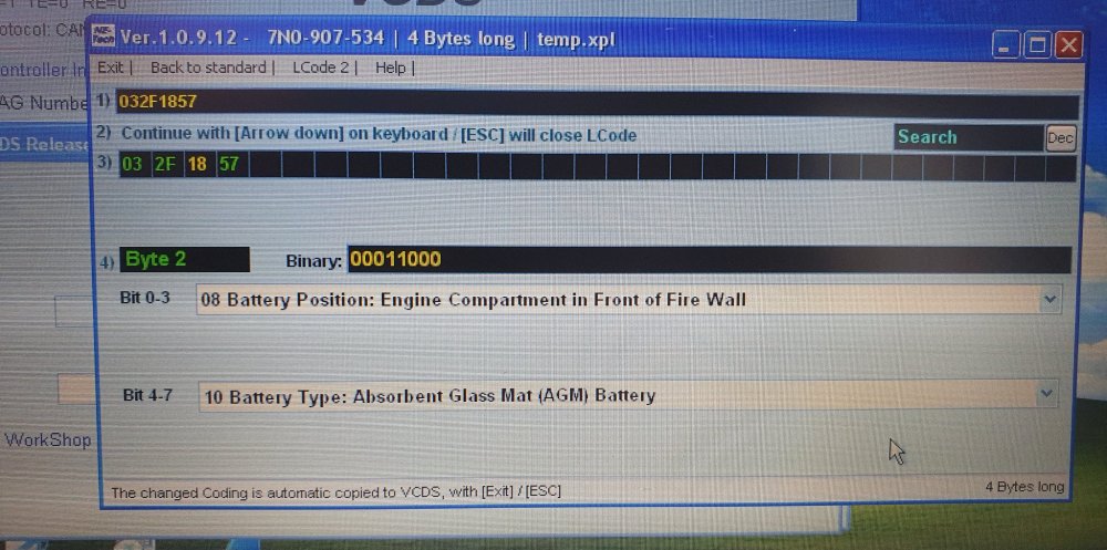

The procedure does seem different on different vehicles. My sons Octavia Mk3 VRS for example had totally different forms to populate, the same type of information but a different entry method. We also swapped his original EFB to AGM type battery and on that it had to be entered as Battery Type = Fleece, whereas the Yeti as seen in my earlier attached photo had AGM on a drop down list. His Octavia has Binary-AGM, however I've been told that is something completely different and AGM batteries as normally brought are type Fleece.

Probably but mine wasn't, I upgraded from the factory fitted EFB to an AGM type. For the price difference it seemed silly not to. A Varta 570901076 Battery was only £120.   I get your point on having to buy VCDS, but I did that years ago and it has more than paid for itself in normal servicing and fault finding over the years. I've also helped quite a number of local people with scans and coding mods. Anyone local could pop by mine and I'd code their battery after fitting.
