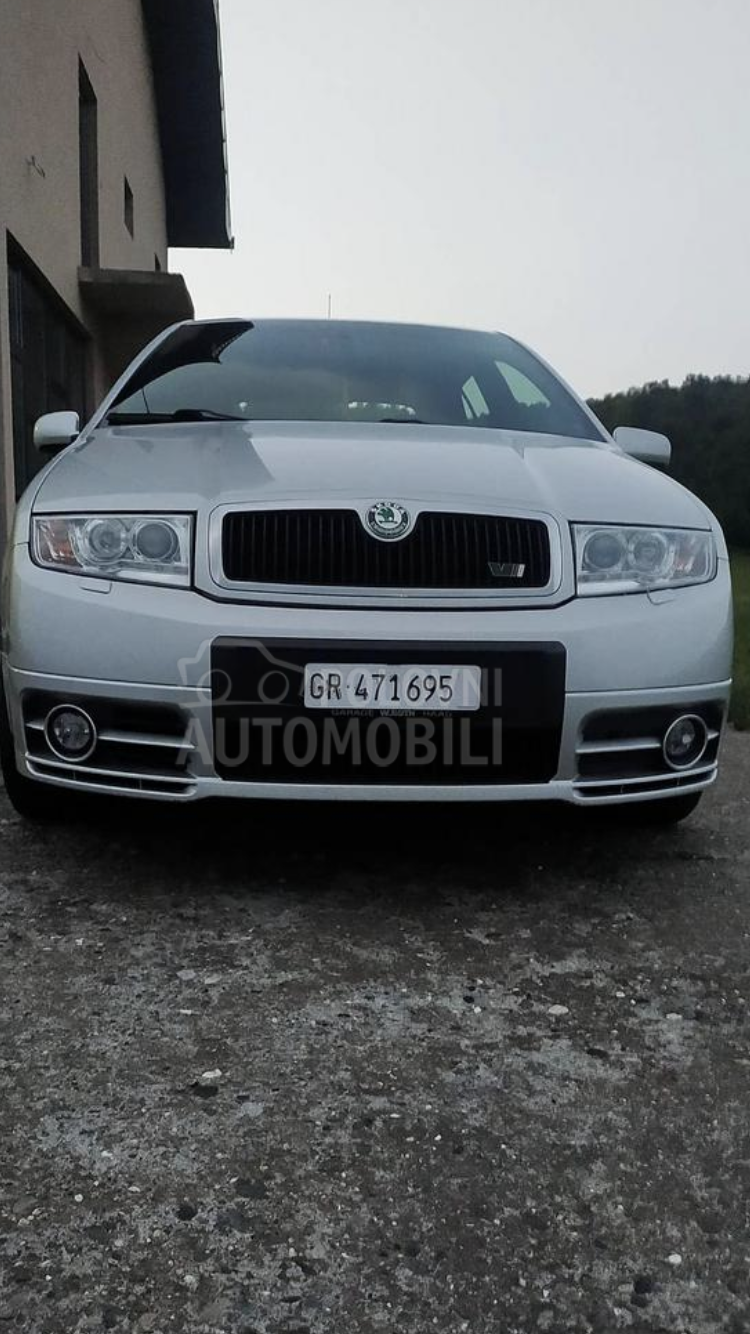

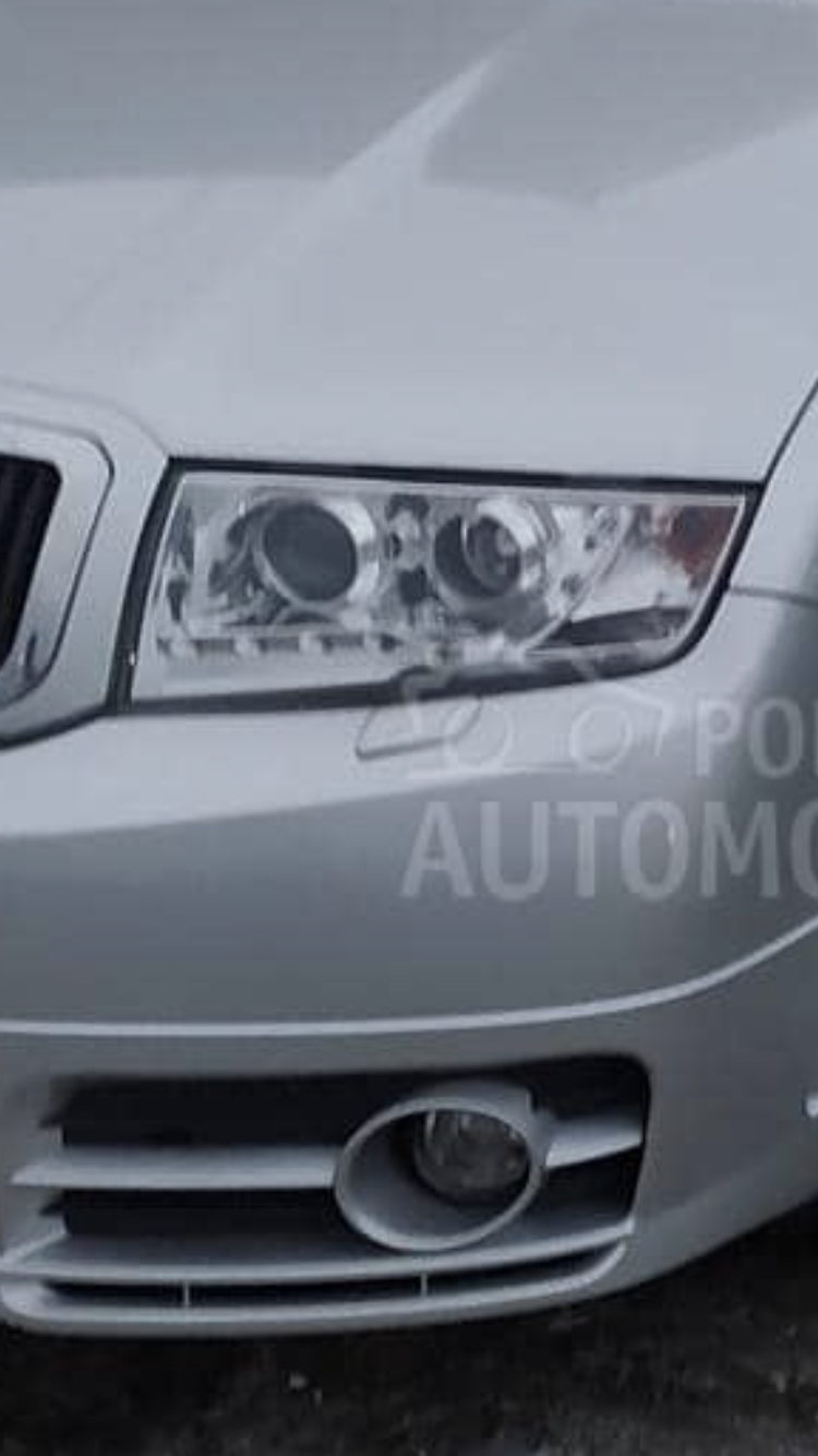

This is the car. Thanks for
the info. So somebody must have replaced the burned out oem xenons with the aftermarket headlights and fitted halogen bulbs….

Ahh yes 100% non genuine aftermarket headlights there!

I’m from Serbia, and the car has been imported from Switzerland. I was kind of worried that it might have been in a collision, because, who would replace Oem xenons for this?! But the washers are working, so I guess they were replaced due to failure.
