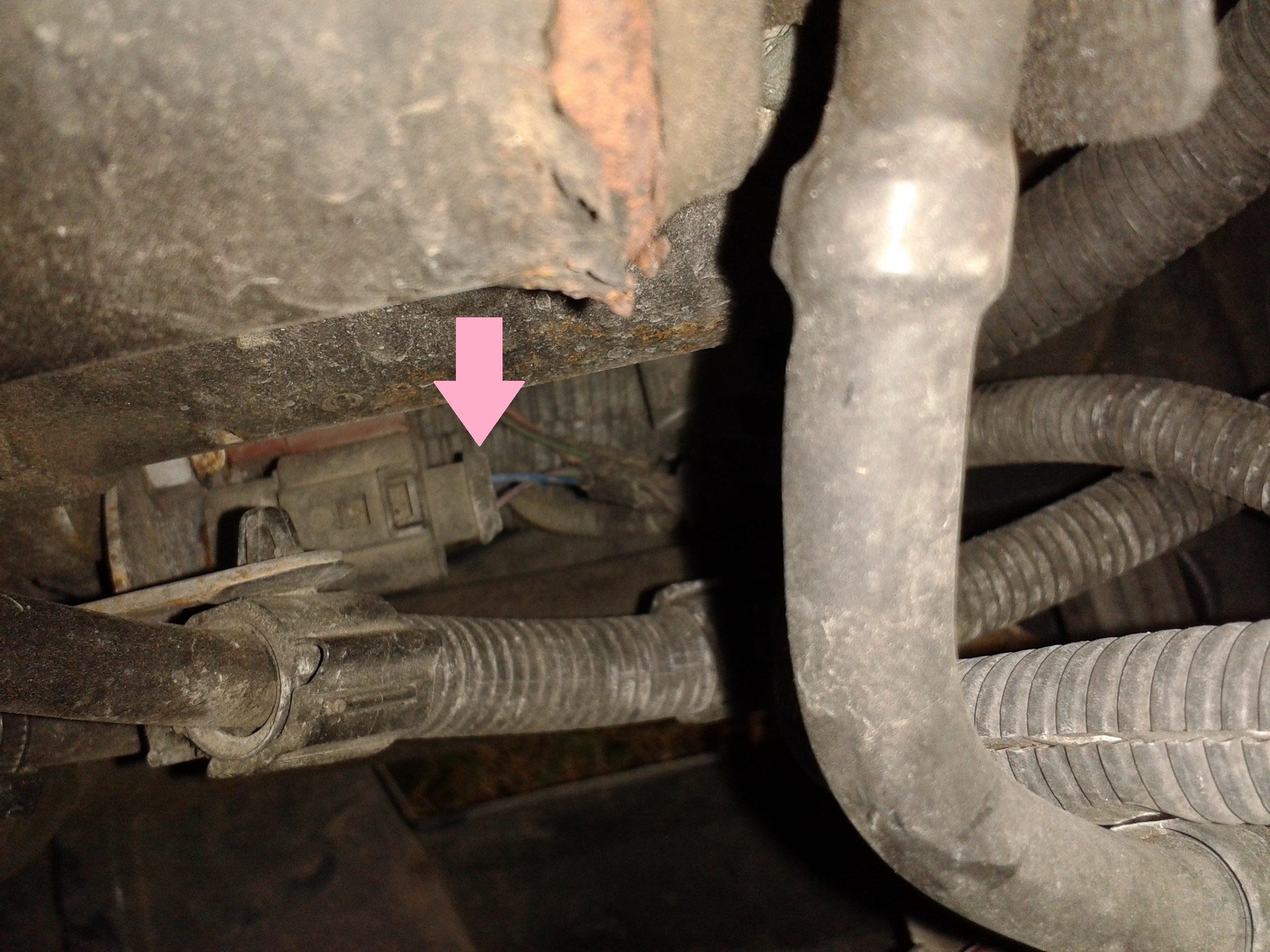

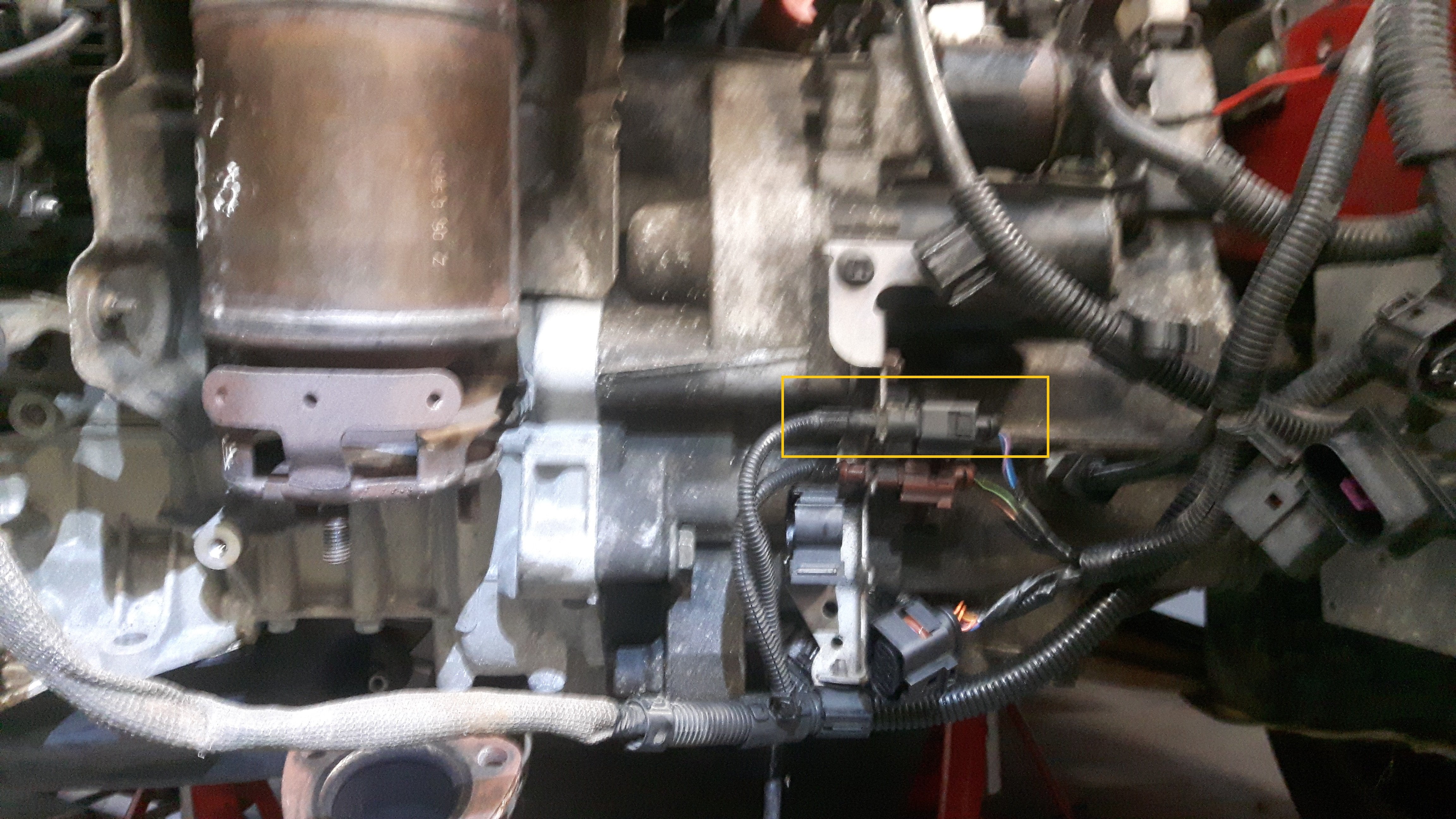

On your car I think the connector pair with DFM and alternator excitation wire will be the top, black pair, seen here just below the starter motor.

Oh, so the exciter cable and the DFM cable, are connected to each other?  Would I be looking for visible tears and the like in the entire length of the cable (highlighted red) or only the (highlighted green) part?

They pass through the same (2-way) connector pair on their way to the alternator, though separate wires all the way. Breakages are usually easily seen near that connector pair.

Depends, it may show the presence or absence of a freewheel pulley, depending on the angle you've caught.  Cable breakages are almost always at the area highlighted in my photos above though, which you may well be able to see looking down from above, I'll link you to a thread with lots of photos.

The cable damage is usually very obvious, like dead-ends of wires that go nowhere, because they've completely snapped.  You can add in lengths of any old cable to bypass the connector pair if there's not enough available to reach by whatever repair method you choose.
