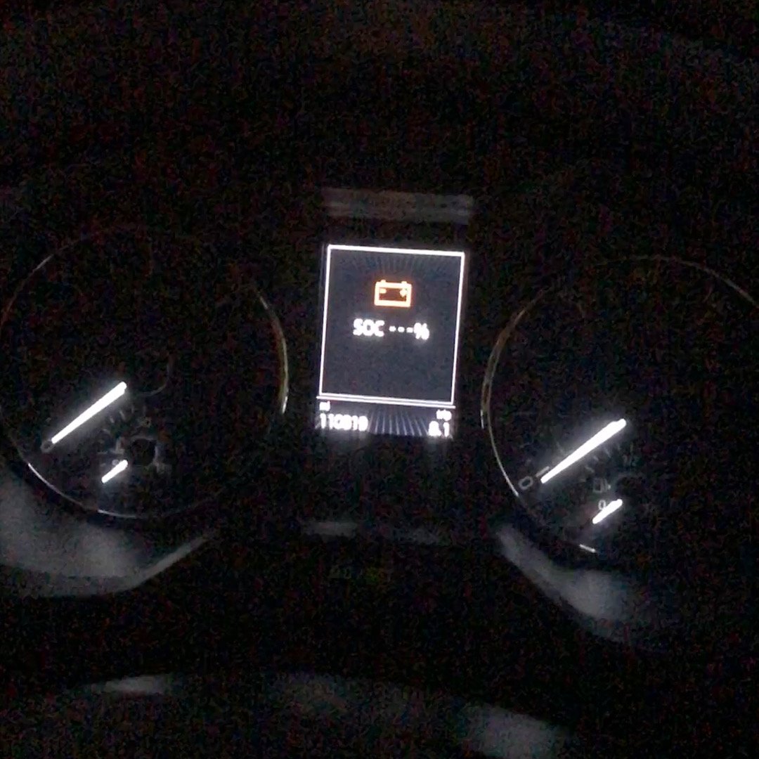

octavia 2016 doesn't show state of charge, does anybody know what is the reason?

If you have a Stop/Start battery then having no SOC figure is normal.
This is because the battery is not charged fully by design and is also allowed the fall to less than 50% before the 'Smart Charging' system kicks in.
If the car showed the SOC most people would think that their battery was no good.

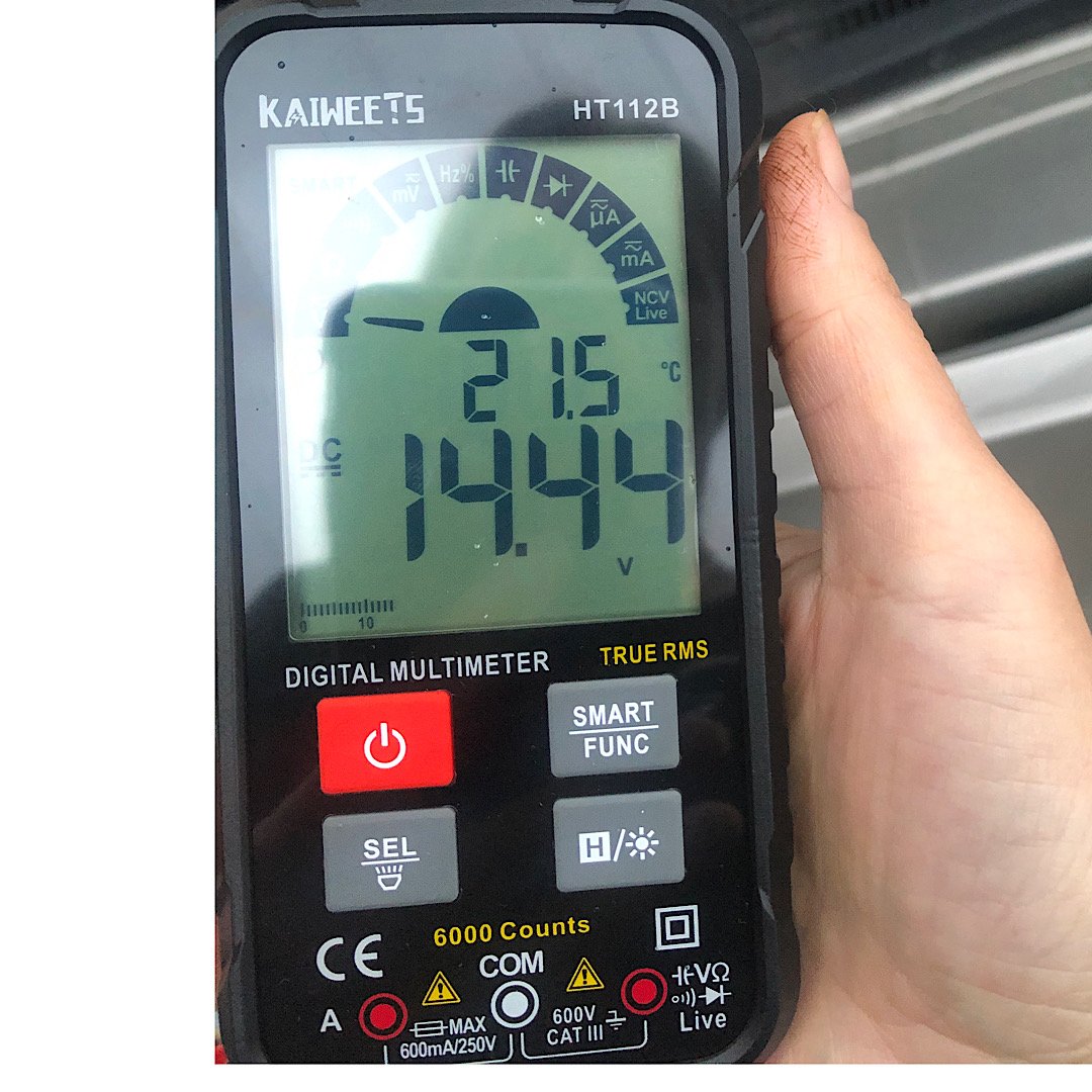

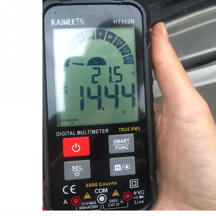

     The car has stop start so I presume that the battery should be . I did some different measurements using a multimeter directly to battery and this are the results: 12.6v ( engine off, ignition off), 10.somethingV when starting the engine and 14.4 V with the engine on. So battery is good , alternator is good. Vcds can't be used in my opinion for exact measurements of the battery, at least not as better than a multimeter.
   If that's so with start stop then I am not worried anymore 👍

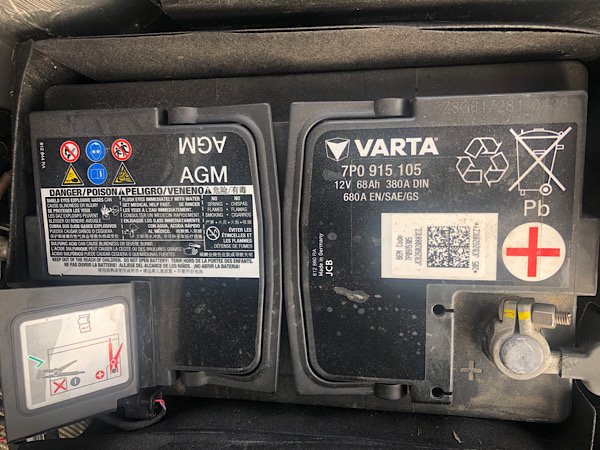

Take a picture of the battery label. Someone will tell you if it's the right spec.
AGM = Absorbant Glass Mat which is a Stop/start type battery.
Looks original.
