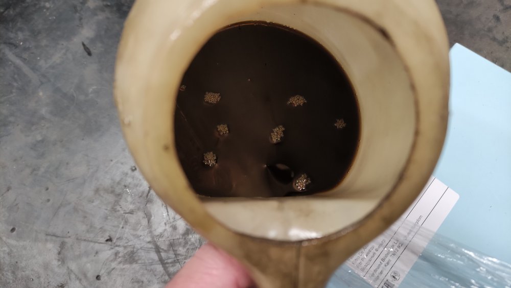

Update:
Just over a litre of very black, thin oil came out, just over 2 litres went in. I'm not sure if this car had a gearbox leak prior to my ownership, it has been fine since I have owned it but the state of the oil was terrible.
Very glad I got this done.
😯 Much darker than new oil, isn’t it?
I didn’t notice such a « Guiness-like » oil, when I changed the oil of my DSG6 upon 60000 km.
Good thing, that you changed it.
Did you notice any improvement in the behavior of your manual gearbox?
Smoother ? Quiter may be ?
It does feel quieter and smoother. I was getting a whine in first under acceleration, still there but more muted now. Shift action also feels a bit better. €45 labour, €70 for the oil. Well worth it.
