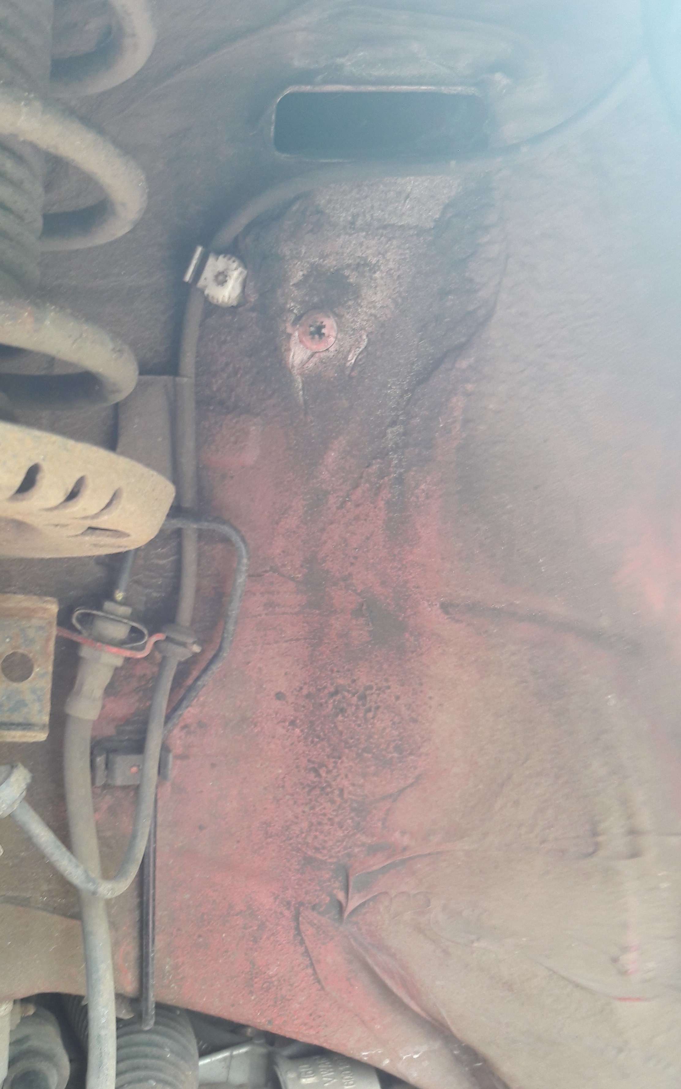

Access to the exit of the scuttle drain on pollen filter side is almost certainly just behind the rear half of the NSF wheel arch liner.
You'd be able to scoop out blockage with a screwdriver or similar; if you prefer taking a wheel off and a bunch of torx fasteners holding the plastic on, rather than going in from above. This is on a mk1:
Yep that could be plan B thanks.
