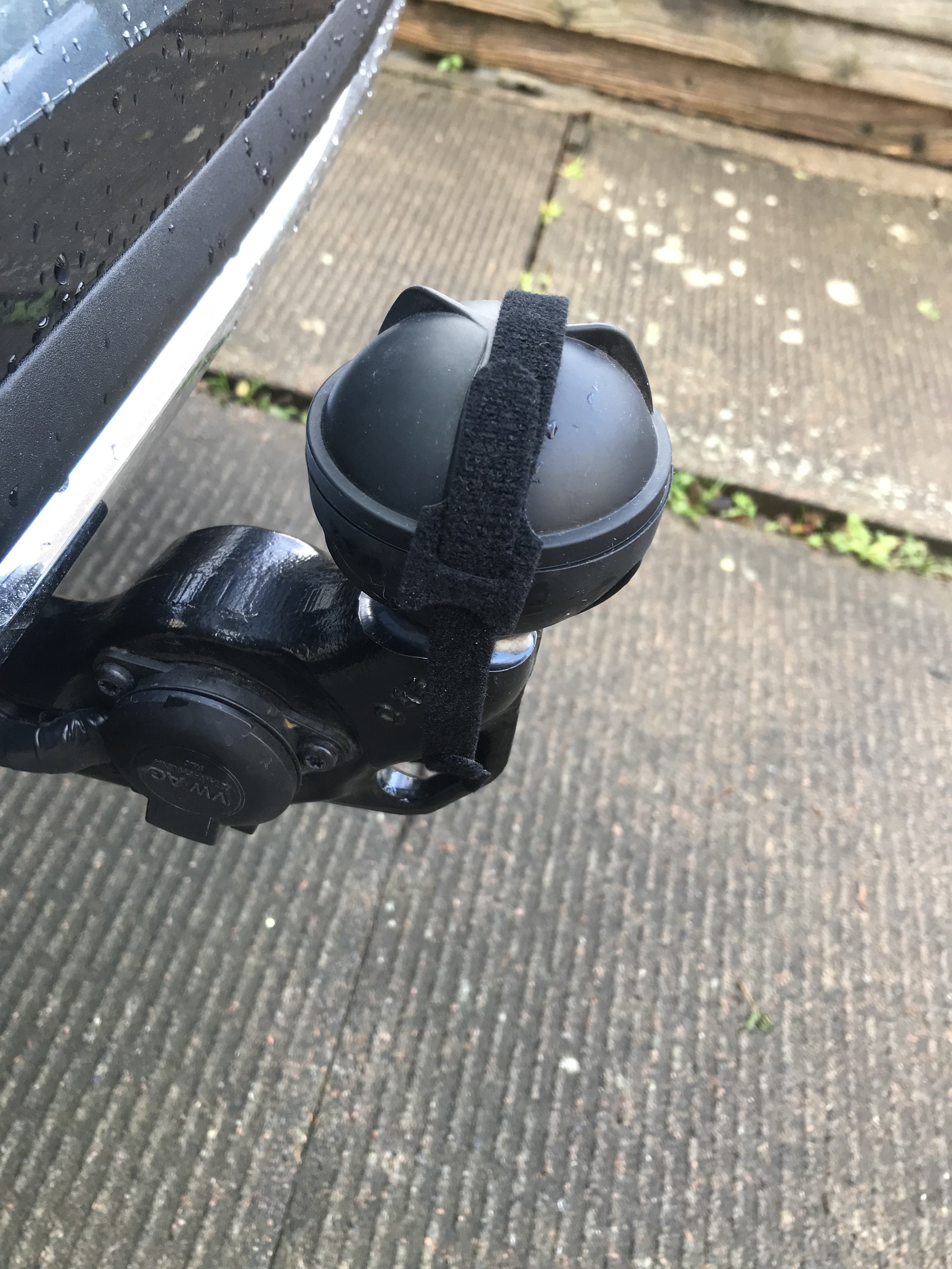

I'd wrestled with this too, on both an A3 with the same factory-fit tow bar as the one on the Karoq I've got now. Most of the drop-down hitches seem to be these Bosal units.
I'd tried various combinations of tow ball covers, plastic bags, reusable tie-wraps and rubber bands but none of them stopped the ball going rusty.  It wasn't a massive deal to clean it, but I was convinced there was a better solution somewhere. As you say, the main problem lies in the hitch being stowed upside down

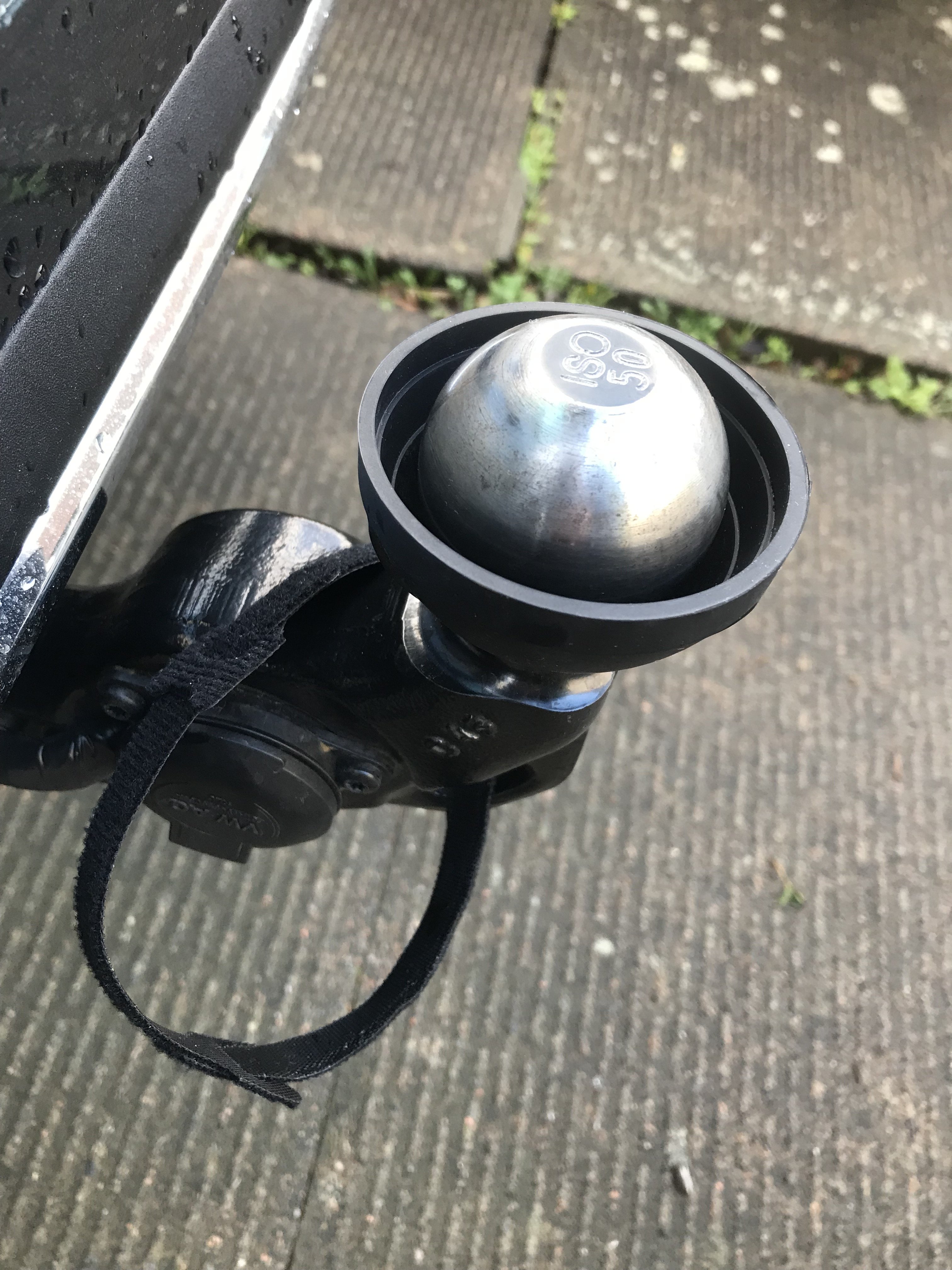

Anyhoo, I bought two of these. The hole you'd use to fill it with water ( I can't really imagine having a ball of ice that size in a drink, but that's not what I got it for) needs to be made somewhat bigger so you can ease it over the tow ball but not so big that it isn't a reasonably tight fit on the neck of the hitch just below the ball.
I used a very sharp scalpel, and once I was reasonably happy that it'd fit, warmed the rubber up to stop it splitting and stretched it over the ball.
The result is shown below. Hopefully it's self-explanatory. The top is held on with Velcro cable ties. It clears the hole in the bumper - just - and thus far has stopped the ball going rusty. The photo shows the ball after several months of use. I haven't cleaned it, and there's no grease on it.
It isn't an unqualified success, but as far as I'm concerned it's pretty close.

I forgot to mention - though I probably don't need to - that you don't need to take it off when you use the hitch for its intended purpose.
You just turn it down out of the way like turning a cuff.

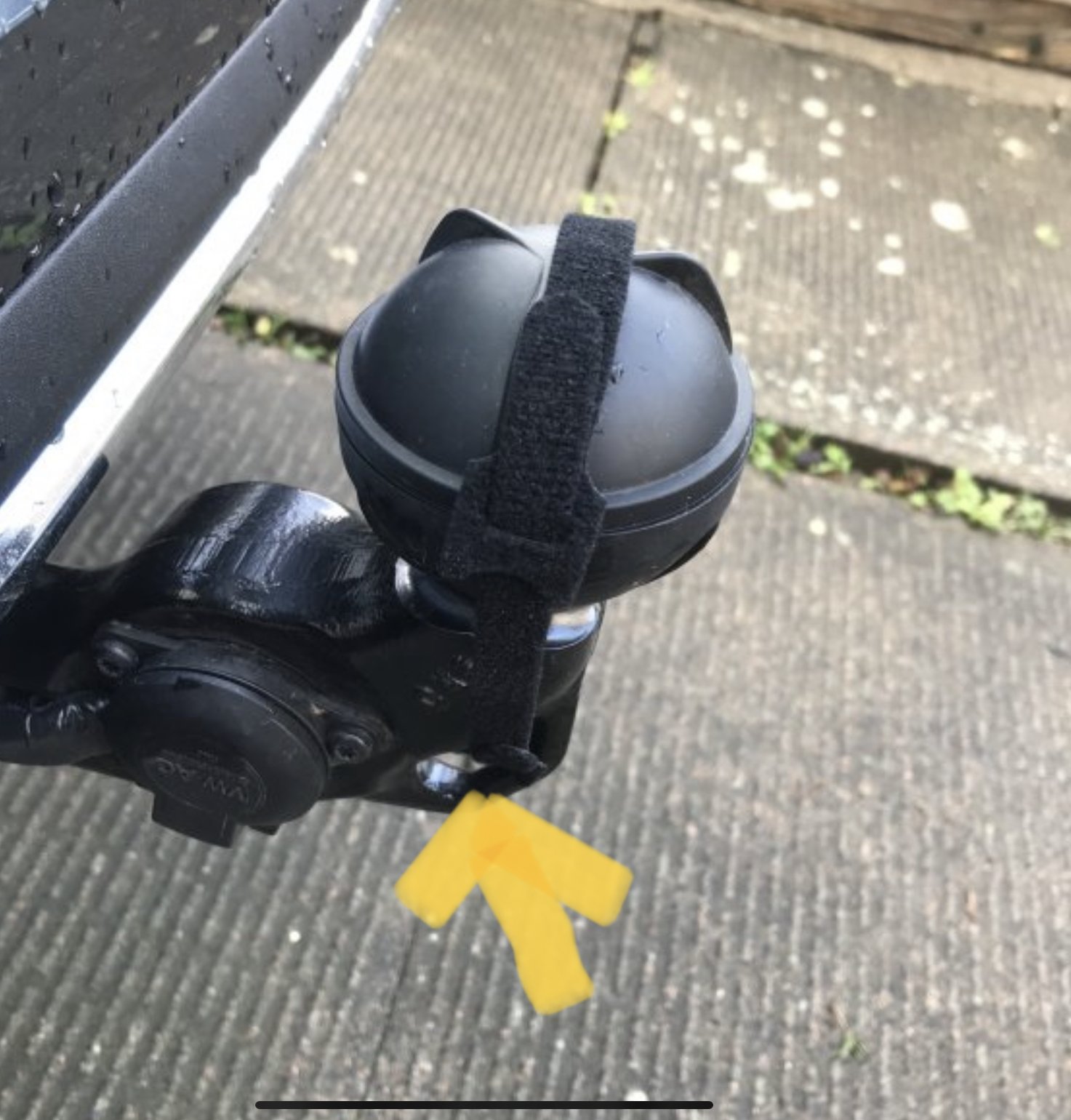

On mine (and the one in Phutter’s post) there is a hole for the breakaway cable, marked here:
