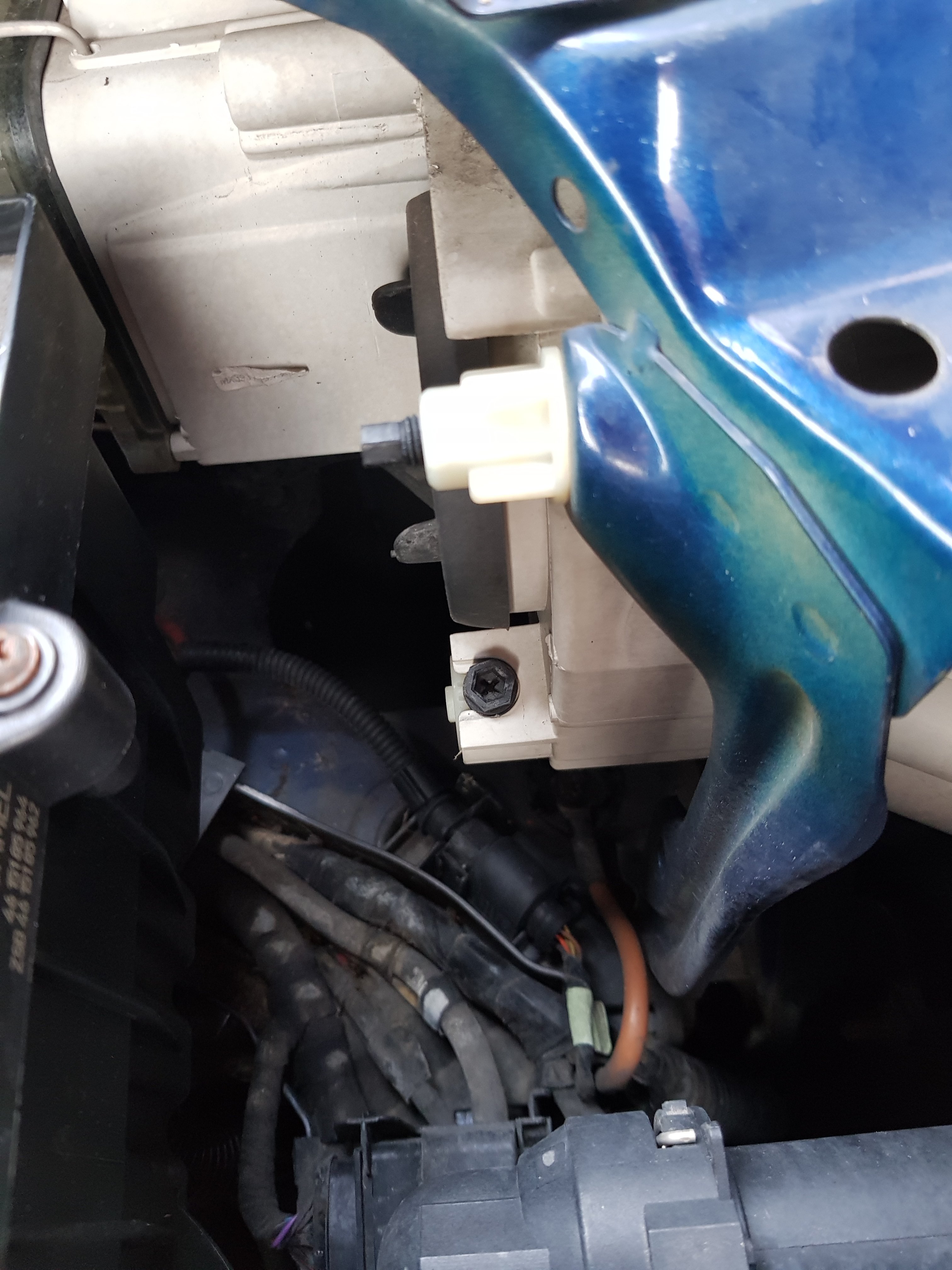

Only had the car about a week. 2007 scout  . When I use main beam  to me it seems to be not pointing directly ahead  but up into the trees  . Are they height adjustable  and if so  is this  it ?

Dip beam fine mate all adjusts  correctly its main beam that's up in the air.   Just wondering before I touch anything that what I posted is the correct screw for adjusting it

I know what you mean mate  but  the beam pattern is correct  it's just ready to land planes
First thing to do is check the bulb is in correctly.

Both bulbs in correct...  I have just found the adjustment nut... both were pointing  way up in the air...  all sorted now guys..   thanks for the help !
