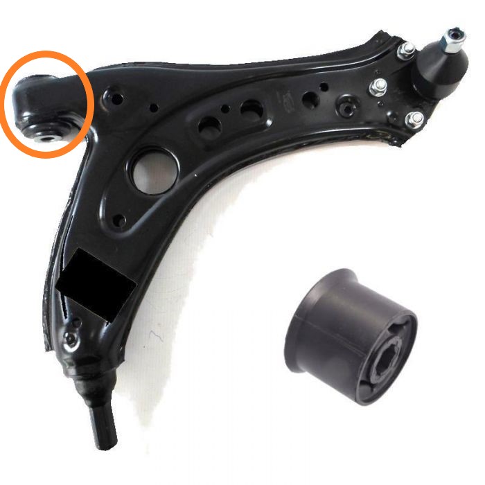

1 hour ago, AnnoyingPentium said:
Which ones, sorry? I'm in a bit over my head here... :)
He means the small bush on the front of the wishbone. To be honest, they hardly ever fail and are not really worth bothering with.

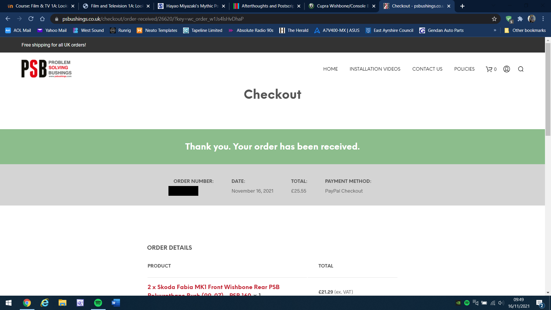

Ordered the bushes people. Thank you all. I'll report back with my findings and results in due time. :)
tumbnail-a91ebefb-a18d-4487-8fd6-29d8c1e
Yeah thats the one, I did mine cause I was that far in and it wasnt much more to get the two bushes from PSB.
I but these my Fabia
SWAG 4044688298393
And yes right side this small bushes ( front side) was totally rust inside and  fail MOT test. So later on i bought this wishbone which include this small front bushes.
But like other say it was litel pit tricky done it but i done it.
i use this kind system to taking off old one.....
And i made tool my self like this when i install new ones....
yes it take some time to do but its not that harder anyway...
