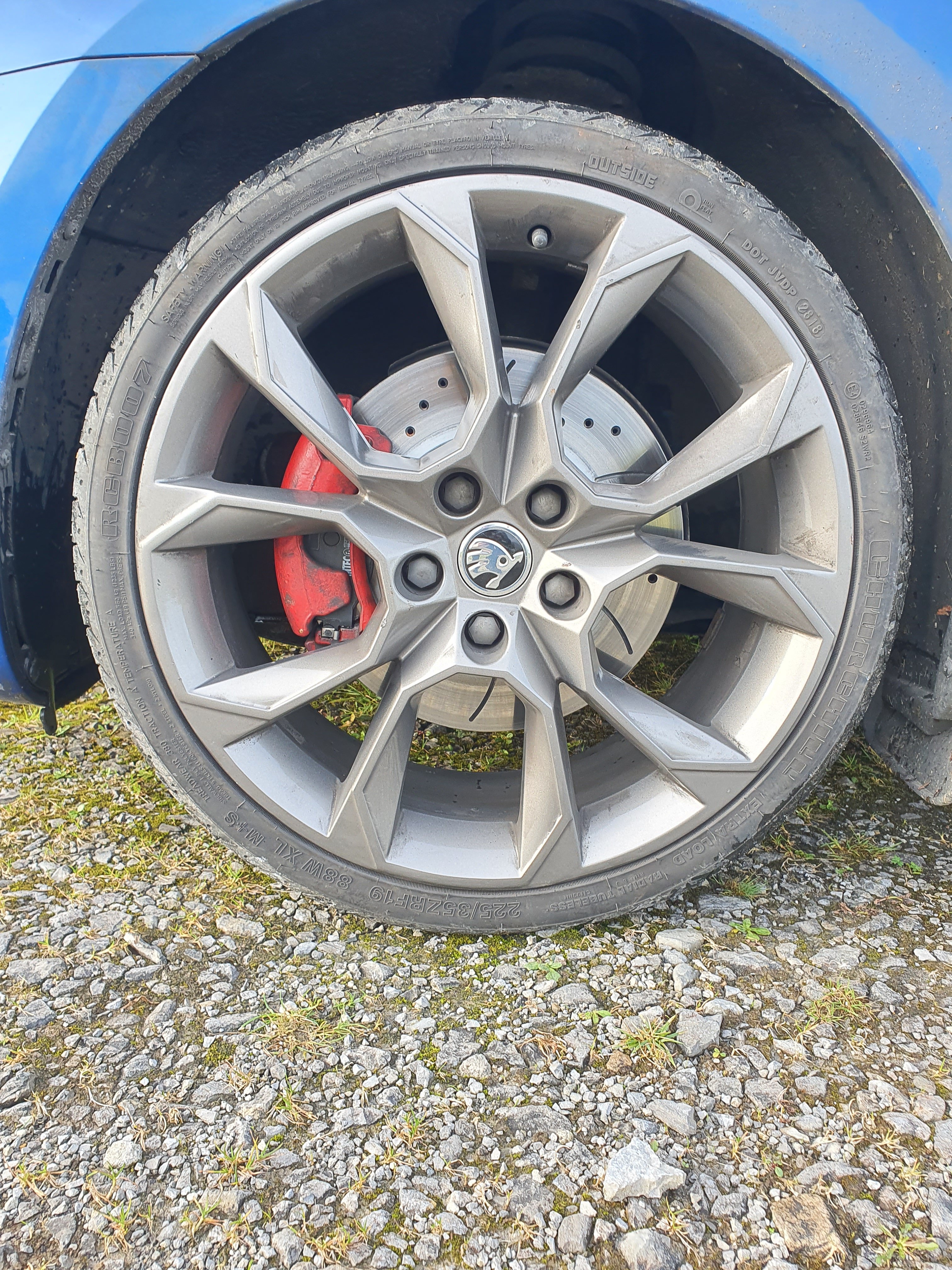

Hello All
I own a 2018 Octavia III and need to purchase a new alloy as one of mine is losing air due to a slight buckle.
Issue is I cannot ascertain which type of Xtrem alloys are installed on the car.
I took the wheel off to try find a part number but unfortunately it had 3 different codes for each of the versions (Black Gloss , Anthracite & Silver metallic brushed)
I think its most likely the Silver metallic brushed but am unsure as any part picture i look at are showroom/computer generated images which are hard to rely on.
Please look at the picture below and let me know if you can - any info is greatly appreciated.
I'd say silver metallic brushed.

It looks like someone has repainted them, as this is what the silver metallic colour looks like.

Check where the air is leaking from. You might just have a slow puncture. You can use soapy water to help find the lead, or remove the wheel and dip it in water. It's possible the rim isn't buckled. Sometimes a tyre fitter will damage the rim where the tyre bead sits against the rim, or the rim where the tyre bead sits may simply need cleaning up. Having air leak past the tyre bead is a common problem with alloy rims, but often easily solved with an alloy rim refurbishment.
