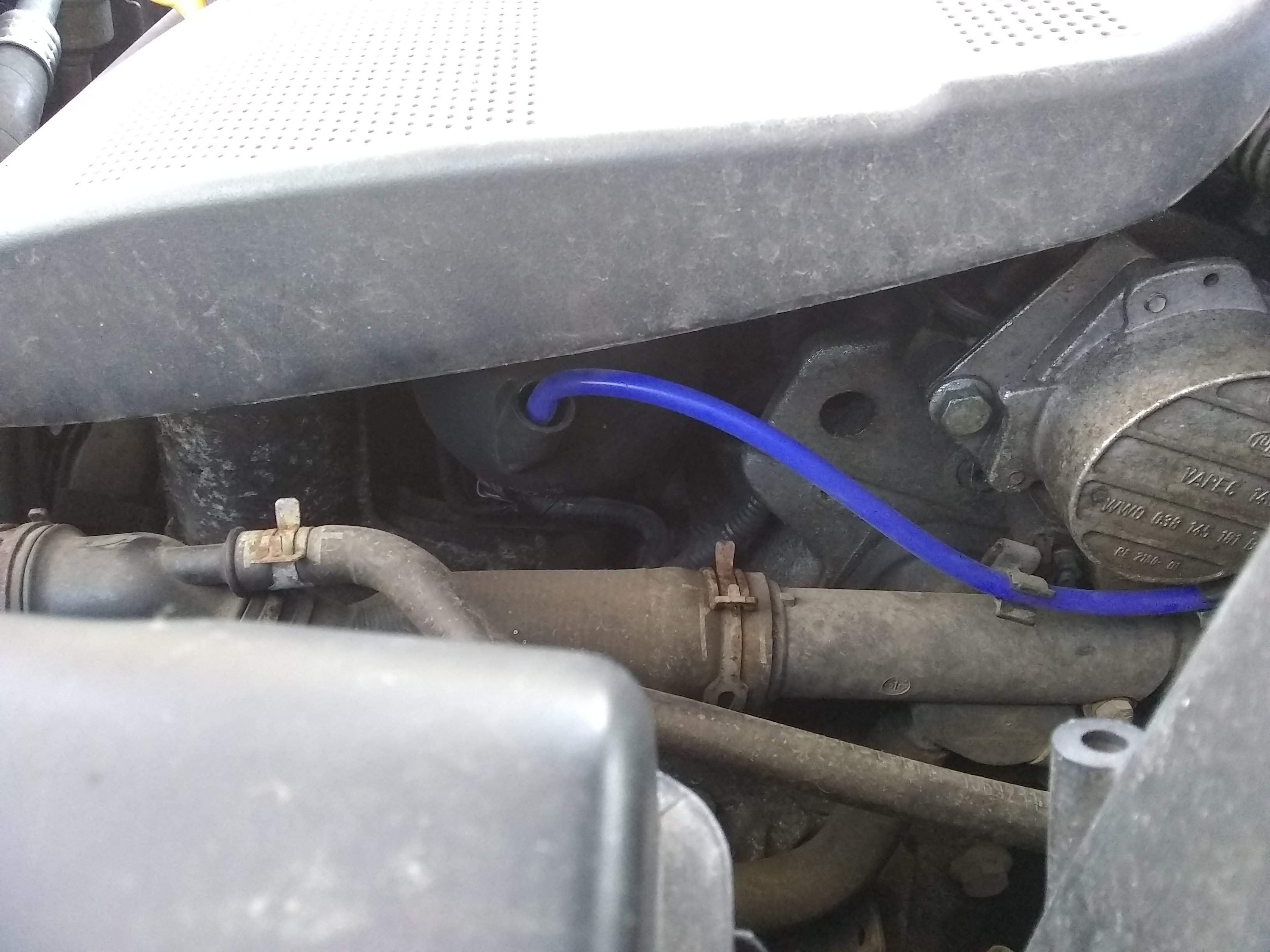

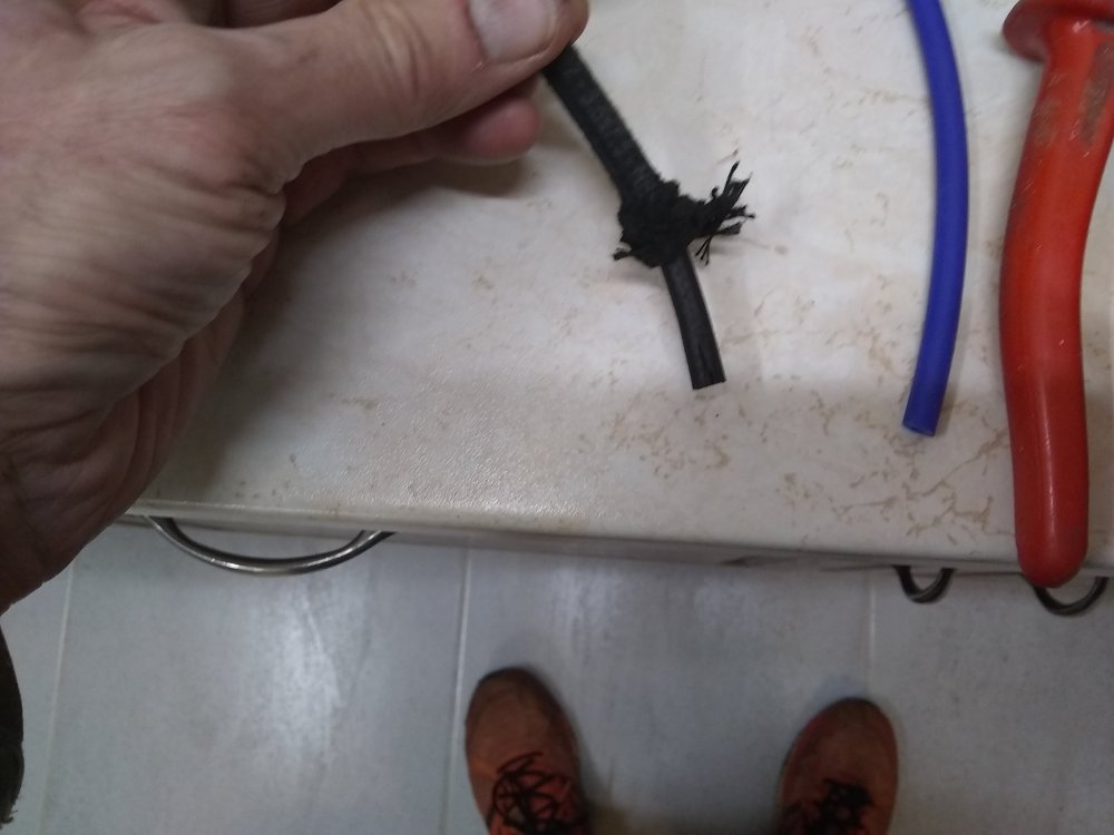

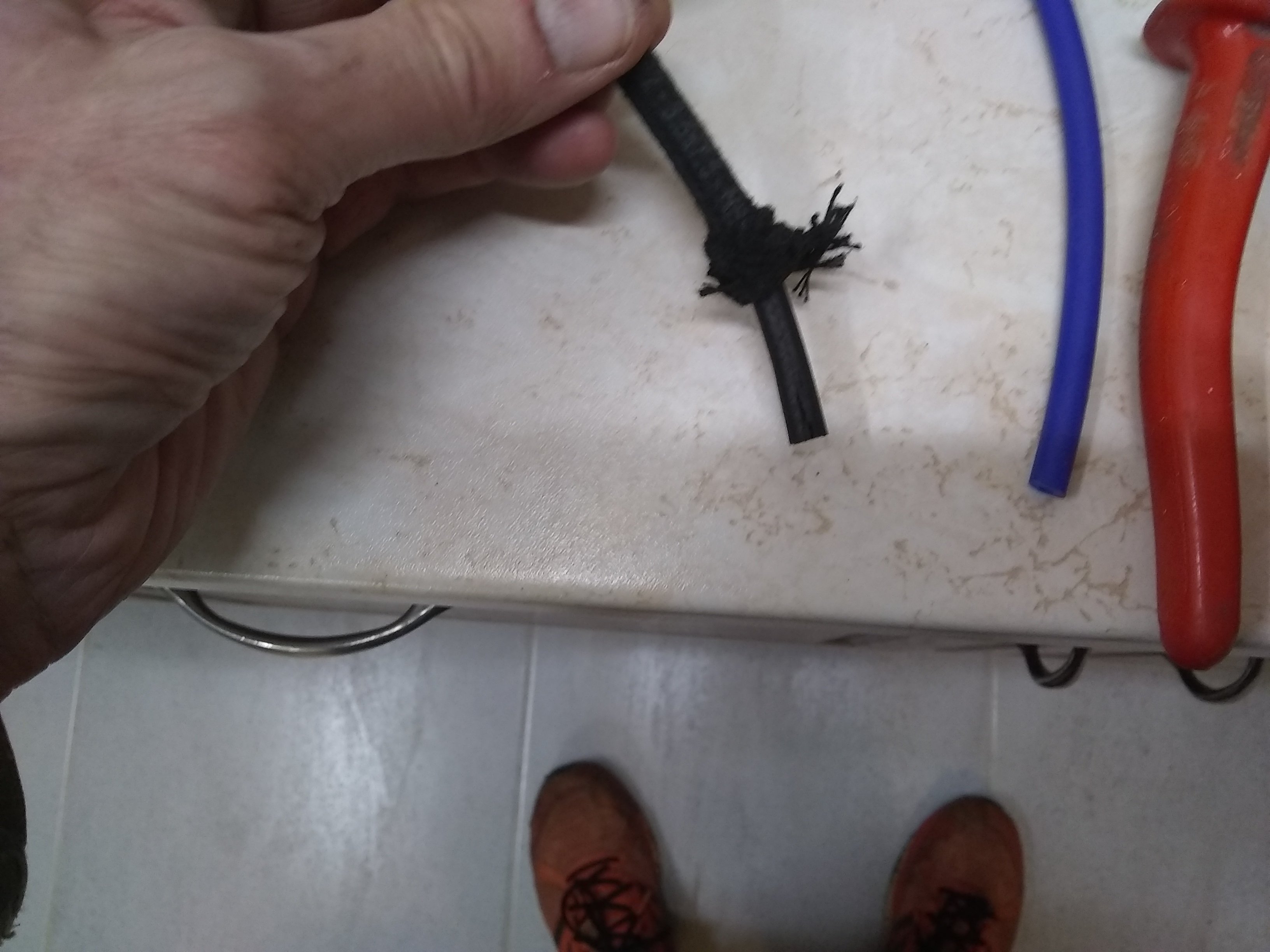

The turbo one was 17964/P1556 Charge pressure control : negative deviation.
Searching suggested vacuum tubes. so I looked under the bonnet and found a lose tube which should go to the engine, then end of it was split for an inch. So i replaced it with a spare length of blue silicon tubing and the problem is solved, The car accelerates up hills now.
