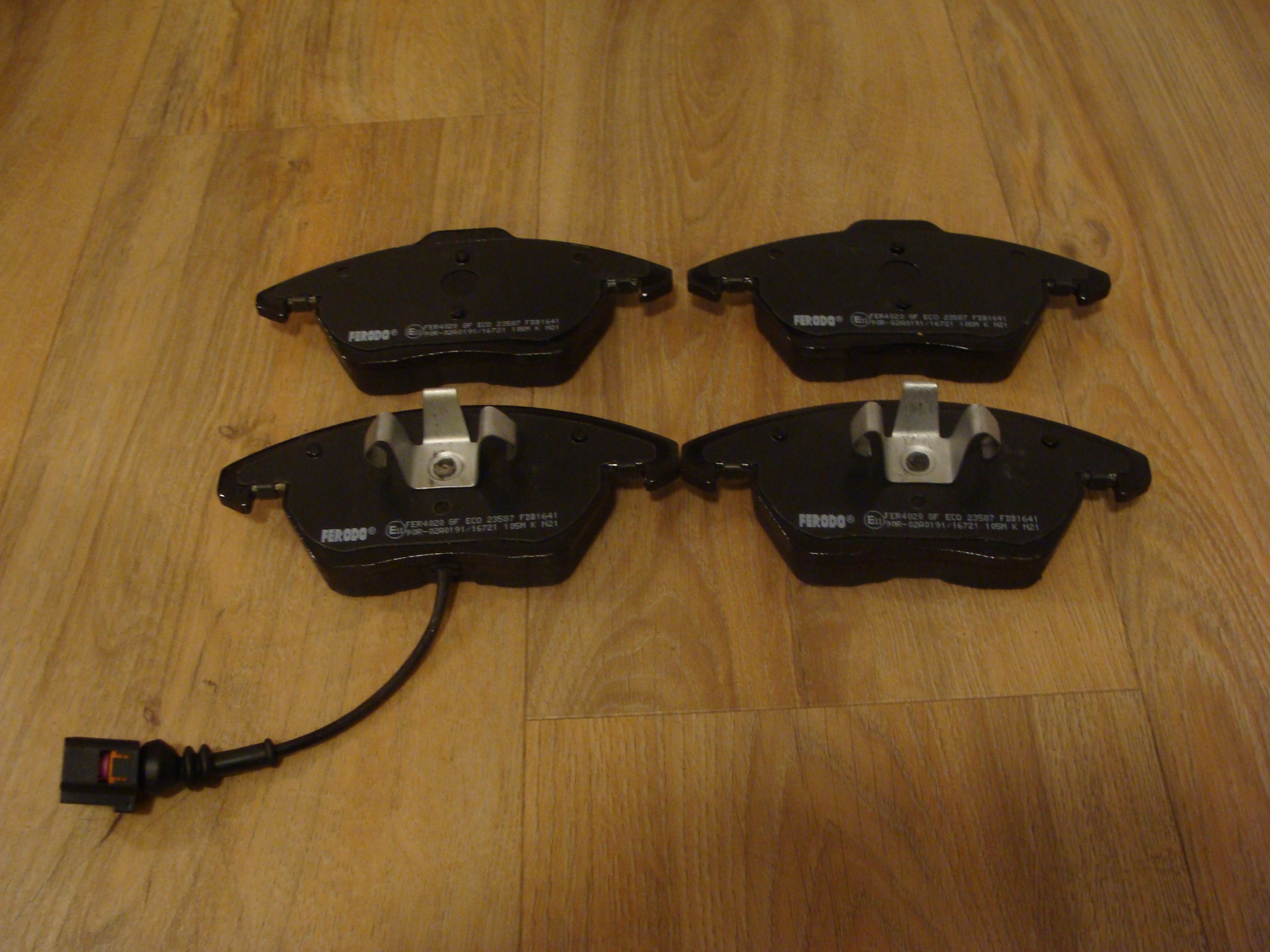

Bought new brake pads today for my wife's ( 2012 ) Octavia-II,

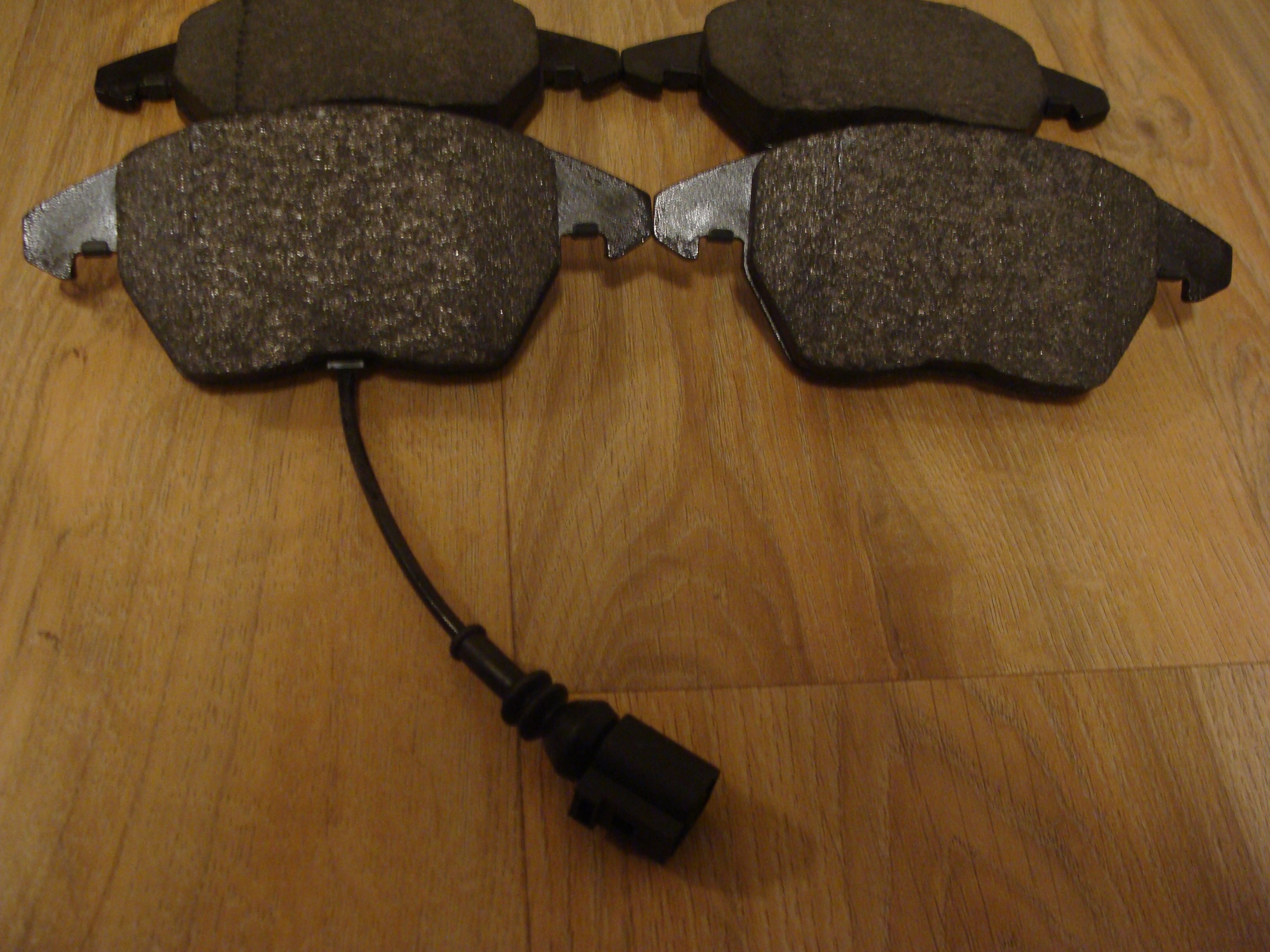

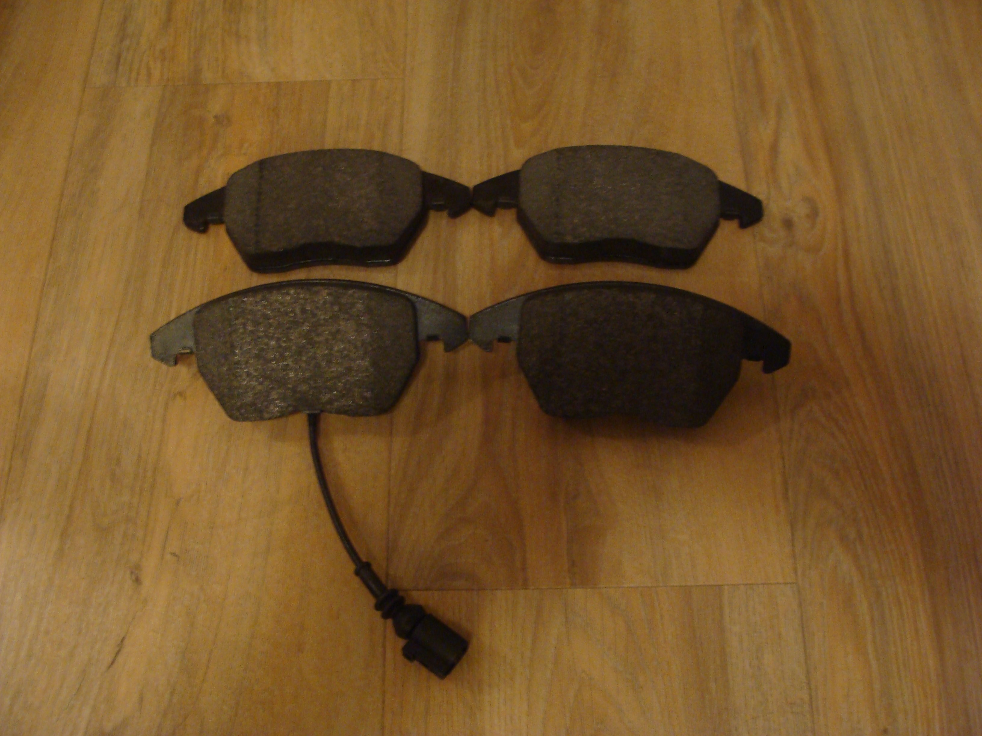

but was surprised when I opened the box tonight and see that only one of the inner brake pads has brake wear sensor.
Should not both inner brake pads have wear sensors ?  🤔
They've been like this on Skodas since the 1990s.
Yes, this is normal.
