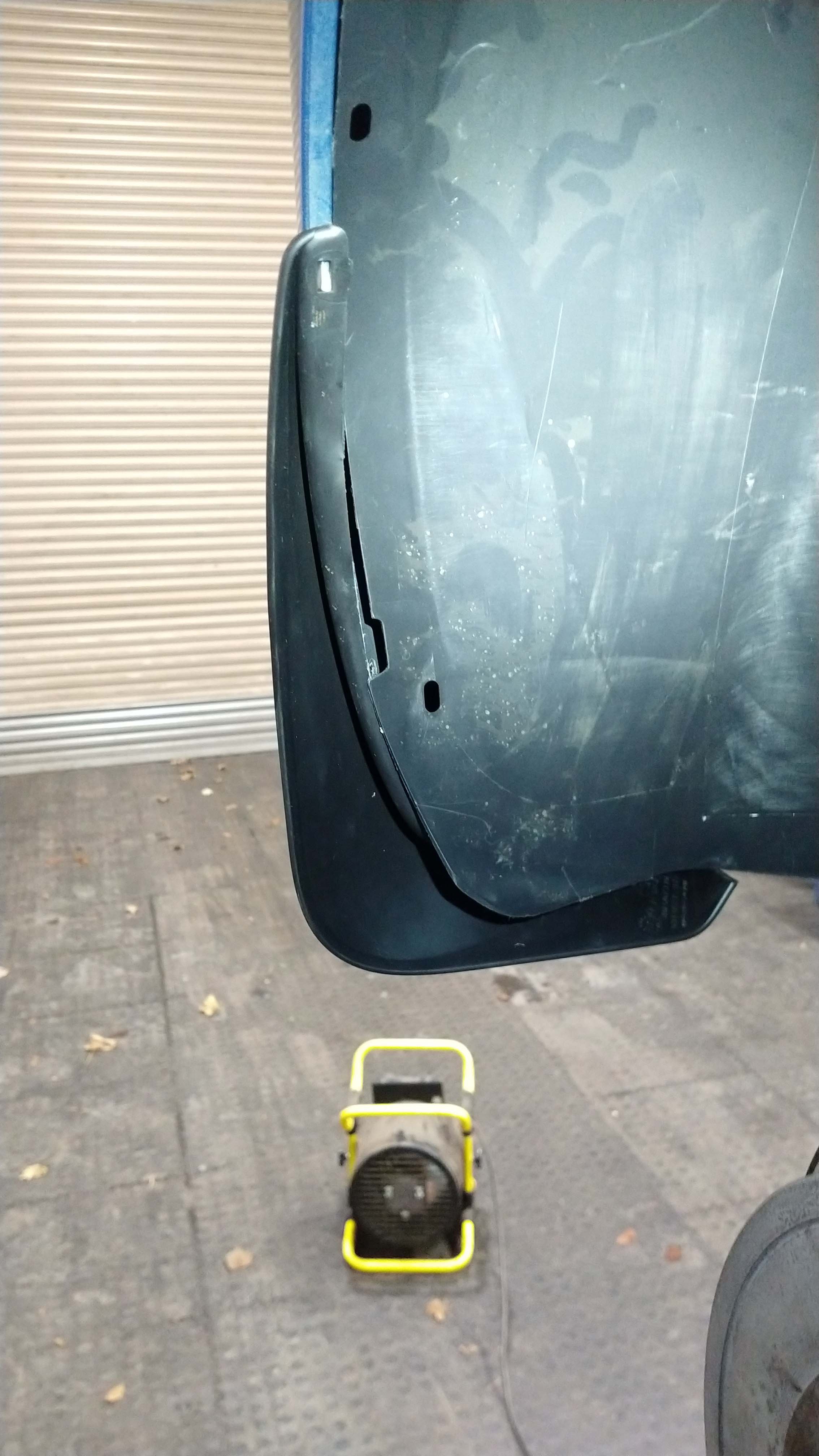

Then proceeded to fit liners and mud flaps. I used a fan type space heater to help with any drying required.

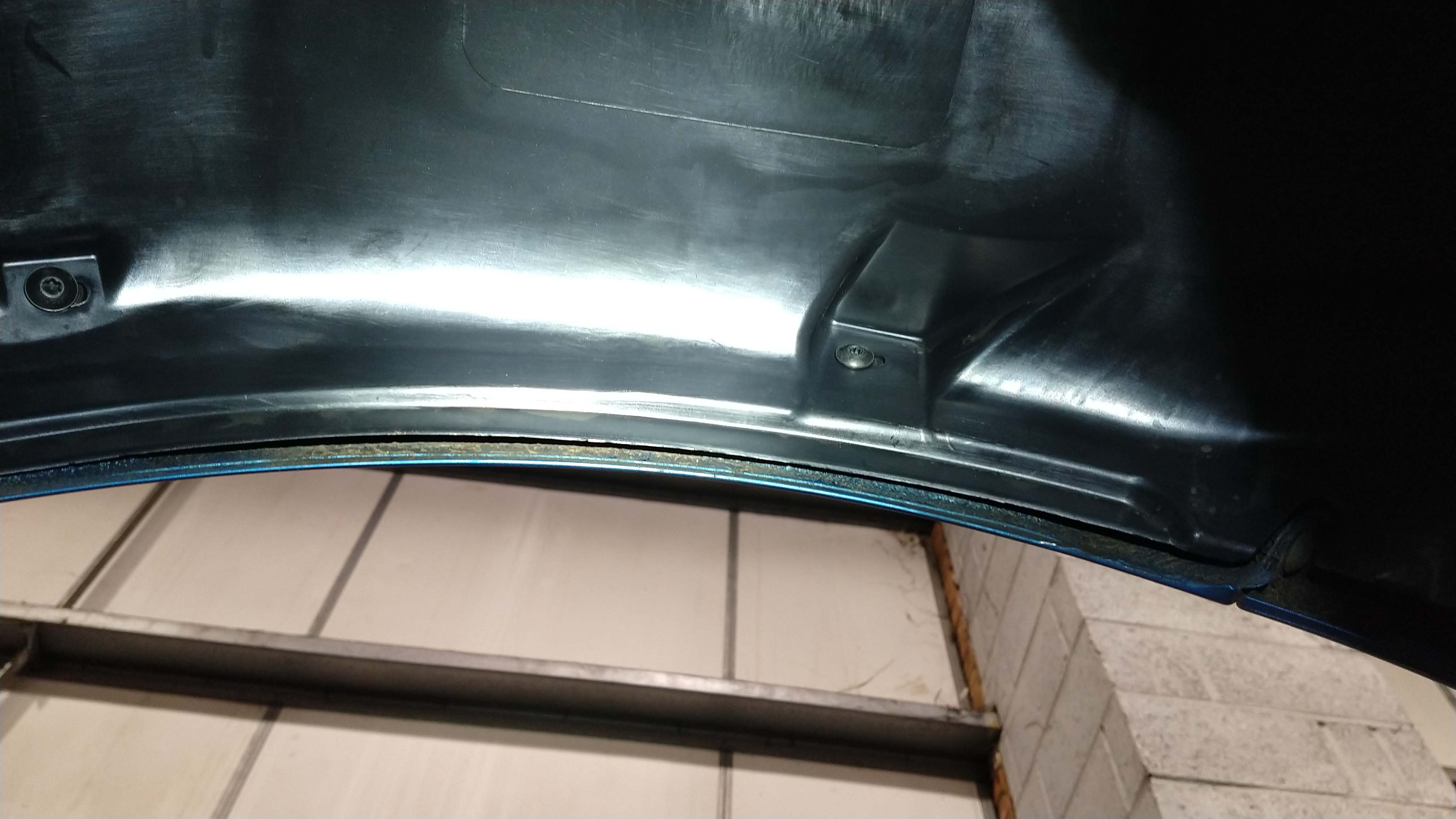

The Citigo had a lot of mud/dirt in the rear arches from it's first three years of use. ( Two hours of jet washing to clean off )
There WAS just the first signs of rust/flaky paint around the fuel filler cap inside the wheel arch.
I also gave this area several sprays of paint before fitting the liners.

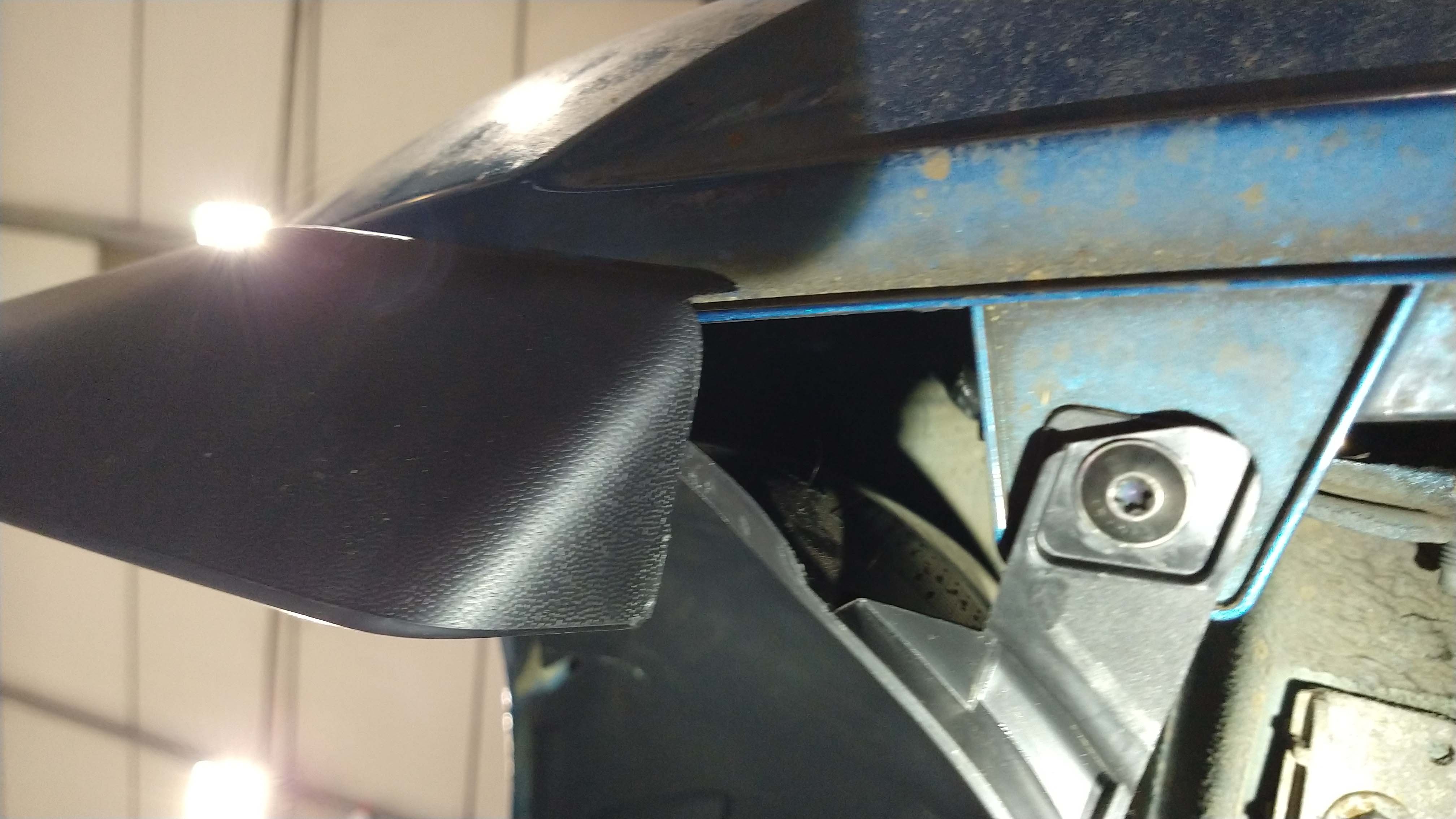

The screws you remove from underneath the rear bumper are a Torx 15 and are not reused. ( 1 each side )

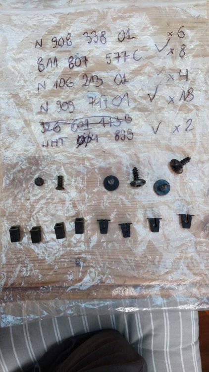

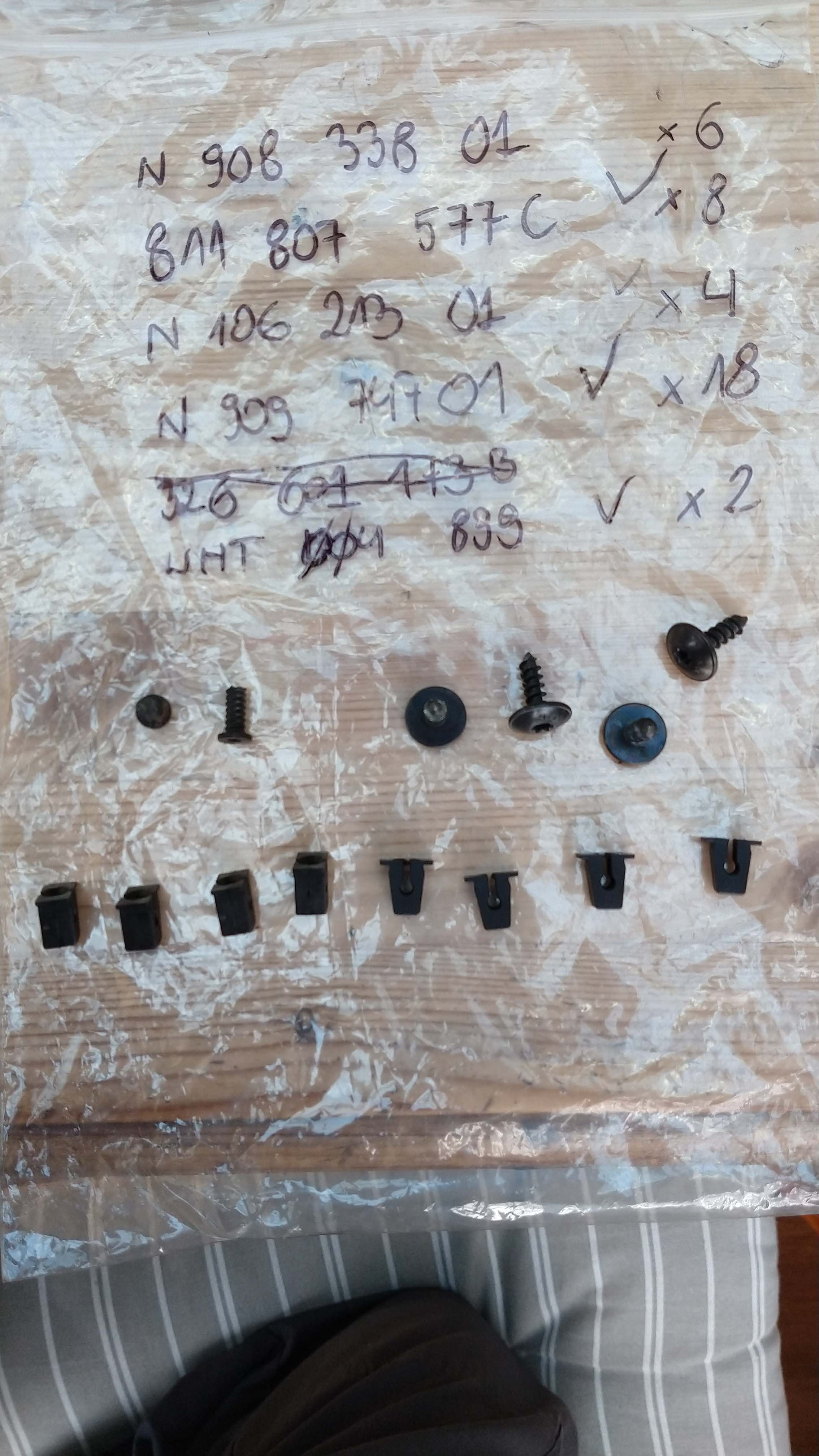

Parts bag and unused parts.
The 8 chassis fittings at the bottom of the photo are wanting a new free home?
811807577C          Screw insert  for wheel arch liner X8. None used? Anybody want them, free?

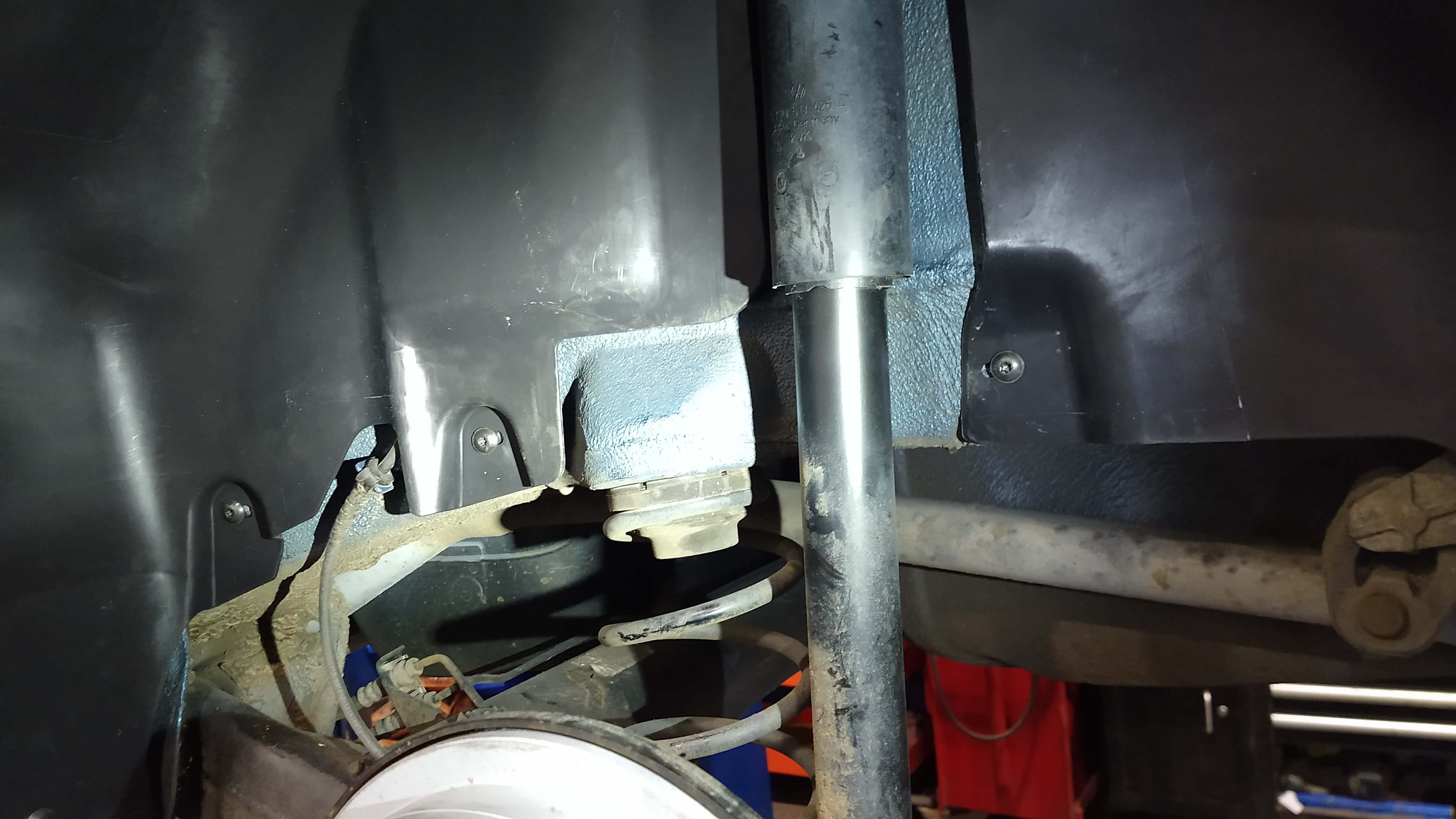

3 x Inner chassis fittings left hand side.
2 X outer Chassis fittings right hand side.
Rear mud flap and unmodified liner right hand side, with fan space heater on floor in background.
Under bumper Torx 25 screw, left hand side.

Removed O-S-R wheel arch liner to check for rust around fuel filler spout.
All good but sprayed with another layer of paint just in case.

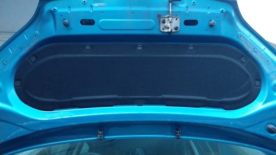

Fitted a pair of front Bosch wiper blades.
Also fitted an under bonnet sound absorber.
Present part number is 1SO-863-831-A and comes with the seven clips to fit it.
About two minutes work. See photo below.
Car still good.
Thanks, AG Falco
