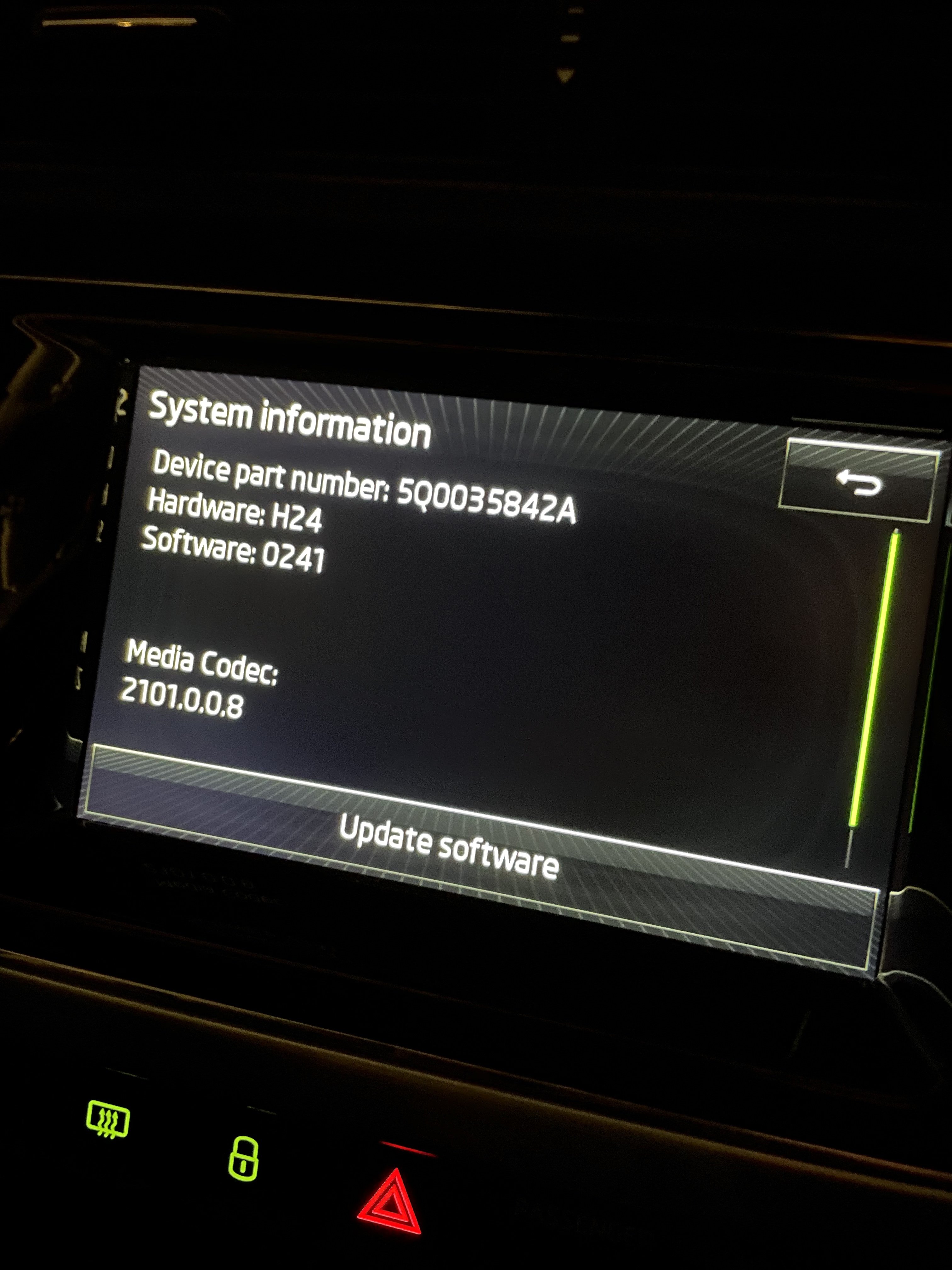

Hey there,
I bought a Skoda Fabia (2015) recently and I'm very happy with it, except that I do have this touchscreen responsiveness as well (it gets better after a reboot but it's not ideal when you're in a rush).
I understand that there is a new version available for it (0253), and I've asked the approved Skoda retailer if we could arrange this software update (my car is under warranty) and I have yet to receive their answer.
