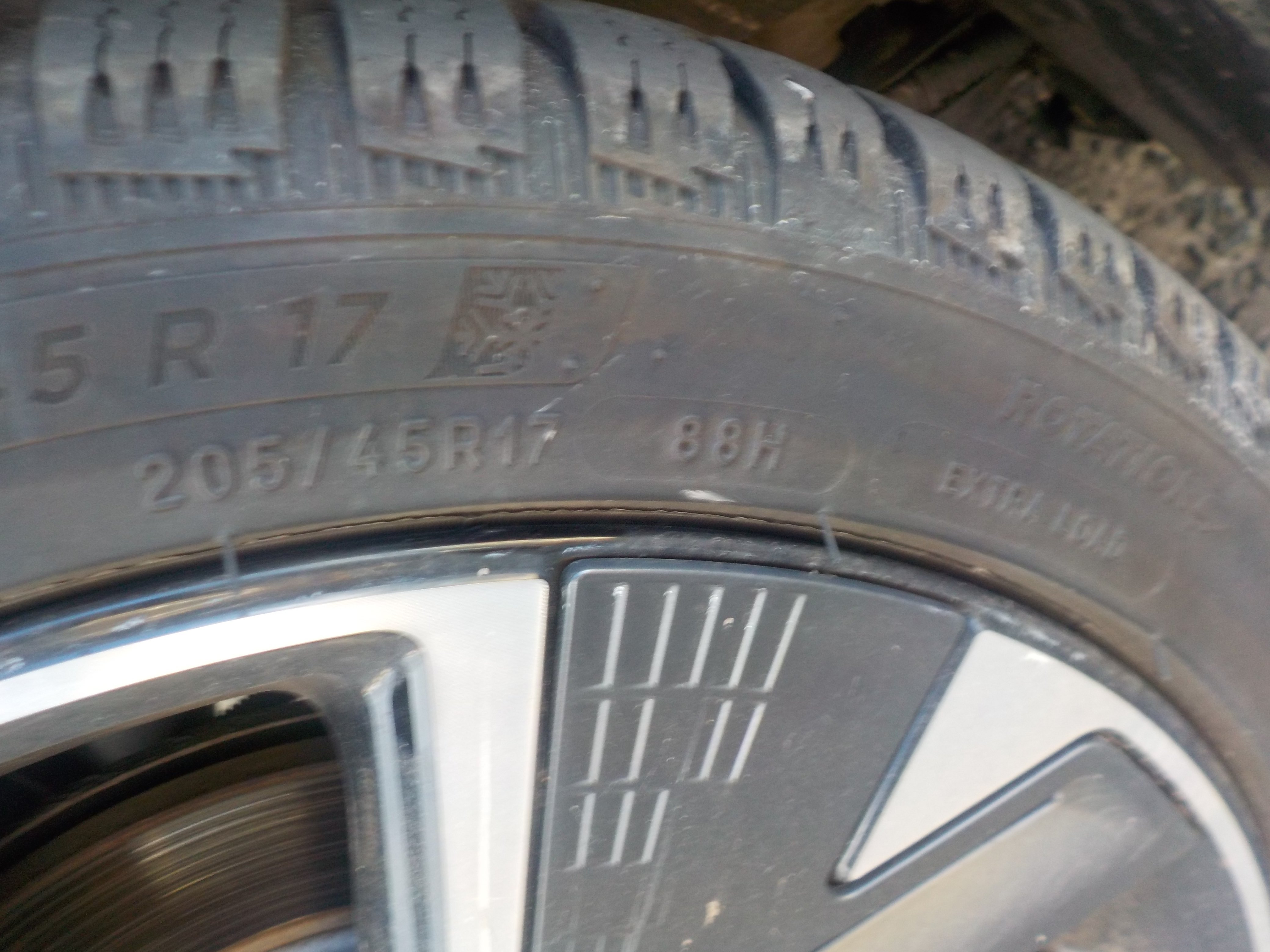

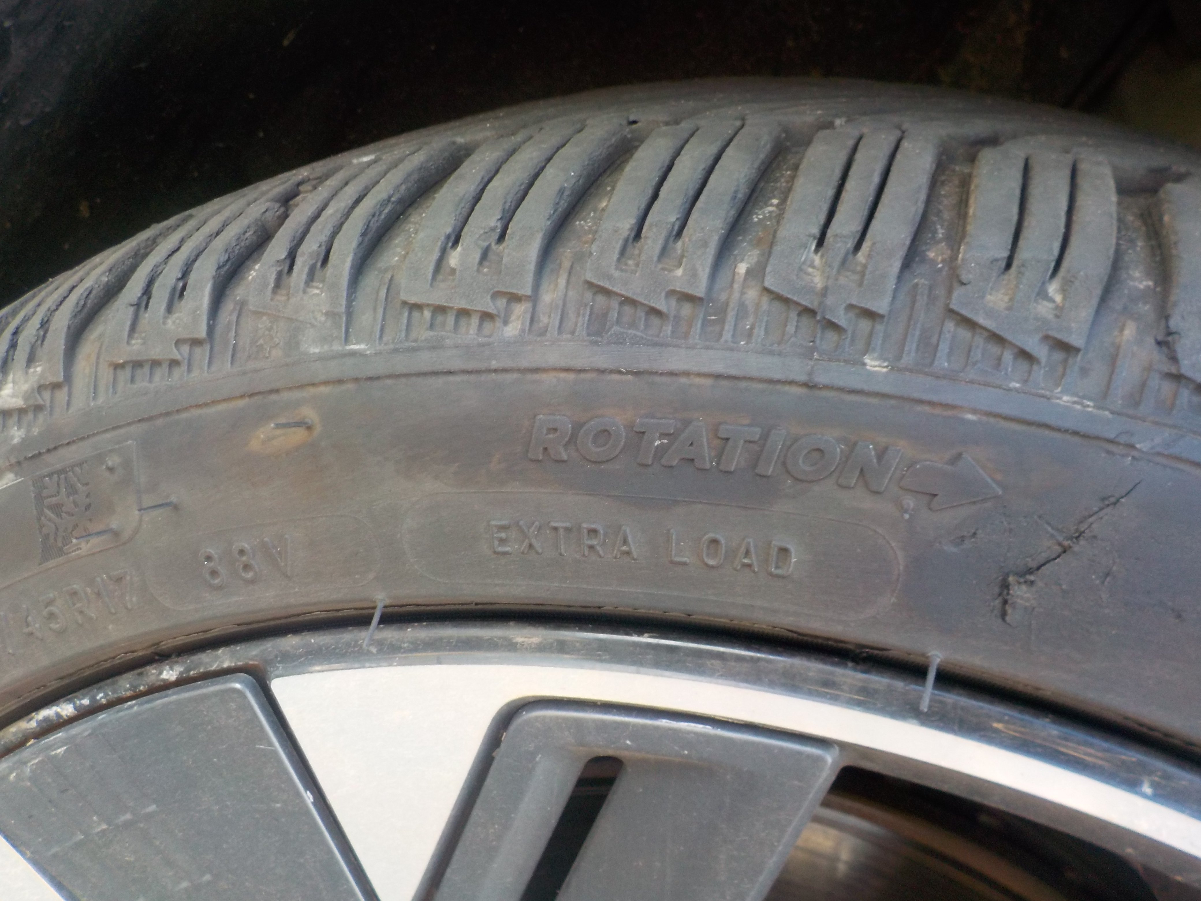

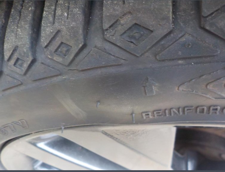

I put some new Michelin winter tyres on the Karok last year and within a short time small cracks appeared on the outside edge more like rubber perishing. Apparently a common thing with these tyres. No cracking or perishing within the tread though.
The MOT tester drew it to my attention but as said above not a fail. Its called progress!
@Karock Which Michelin Winter Tyres is it that it is apparently common with?   Is it Cross Climate or Cross Climate + you have fitted?
It is just i have 4 sets of Michelin Cross Climates and Alpin 5 & 6 without cracking and have not had any issue with Michelin's in the past
Michelin Alpins.
Look on the web scores or owners have experienced peripheral cracking.
@Karock What are they Alpin 5 or 6?
I have had Alpin 5 on rims fot 6 years and they have been used a few winters and they are like new and my Alpin 6 have done 18,000 miles in 14 months and are also as new.
(well maybe a bit of kerbing damage)
