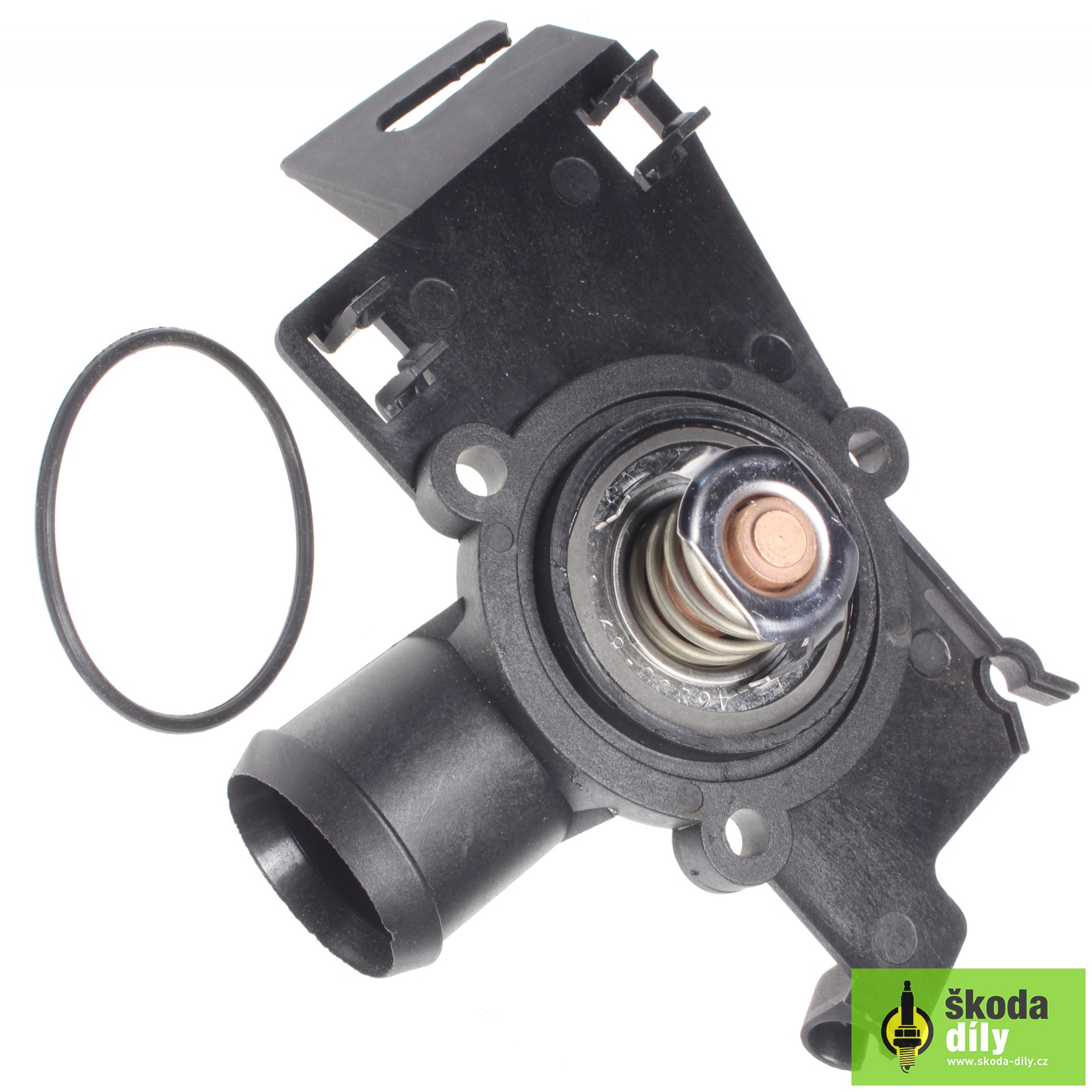

It's better to buy then as a ''set" which means the thermostat already is inside the housing with a new gasket.
I've had conflicting messages. Is the thermostat housed in this piece that is leaking? I've been told the thermo is elsehwhere?
You can buy a separate thermostat and keep the old plastic housing but i think it's better to buy the as set which means new plastic housing with thermostat installed inside
together with a new gasket you will be fine.
Look and example of mine (1.3 Felicia) , older thermostat damaged
so i bought a set as this example:
3 inox bolts and nuts and you are OK.
