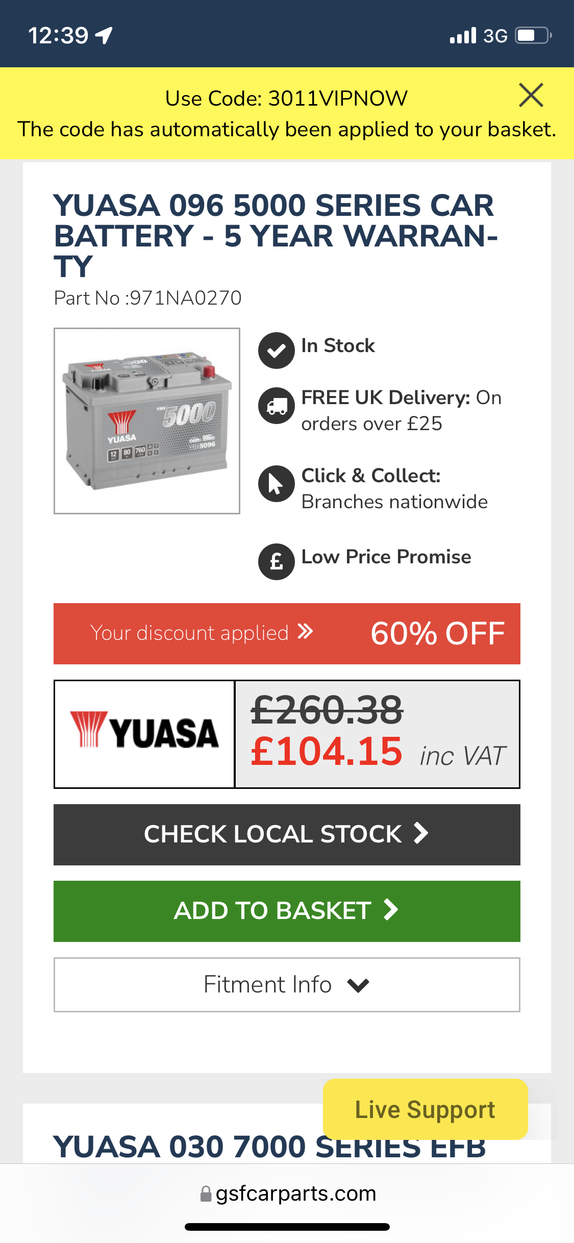

Best deal I can find locally is a Yuasa 096 battery from GSF Car Parts for £104.15 Inc vat (makes it cheaper than the Tayna offering I was going to get). Can’t quite tell if the GSF offering is an AGM battery though - anyone know ?

If it doesn't say AGM it won't be one.
Can you check what fault codes are back?
Same faults as previous, ABS Module and Start / Stop (haven’t scanned yet though).
As for the Yuasa battery, I’ve just googled it and apparently it’s not Start / Stop compatible.
Hmm, maybe the Tayna one is still in the running

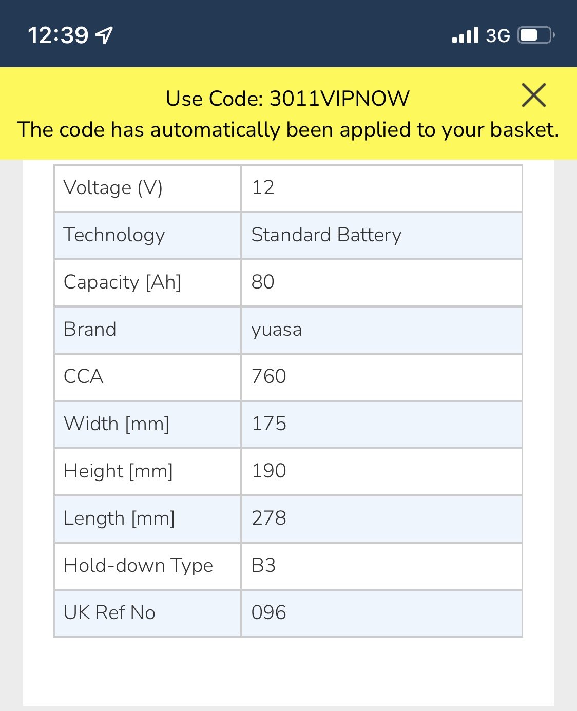

Standard lead-acid battery.
