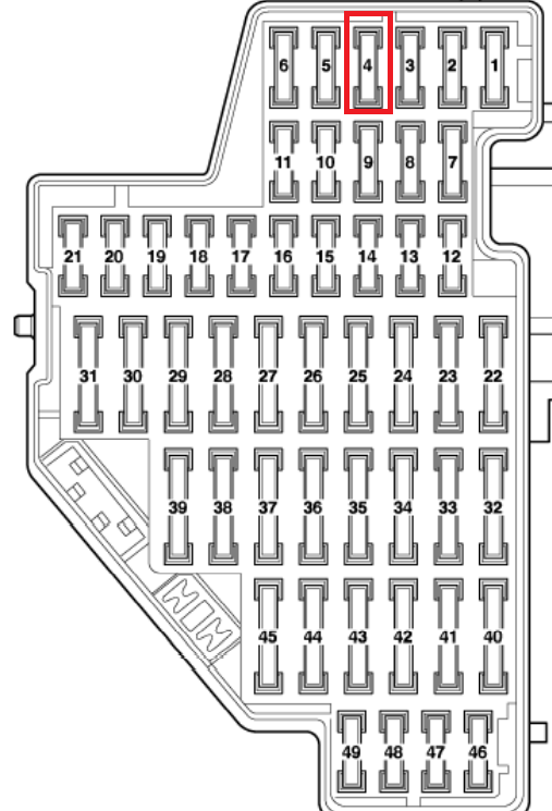

Check cabin fuse number 4 and replace if it is blown.

Thanks do you have diagram.

If it's a RHD car then this :
The fuse was blown ,changed it but no luck.
Thanks
