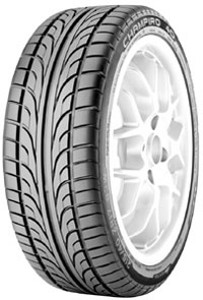

for example:
this tyre is the same no matter how it is fitted.
this tyre is directional, notice how the tread is pointing in a certain direction. change the direction and you change how it disperses water.
this tyre is Asymetrical, the tread is different from inner edge to outer edge so by fitting it on the incorrect side you are changing which part of the tread pattern carries more load in corners and which part disperses water in a straight line.
Good pics showing exactly what you're after :thumbup:
