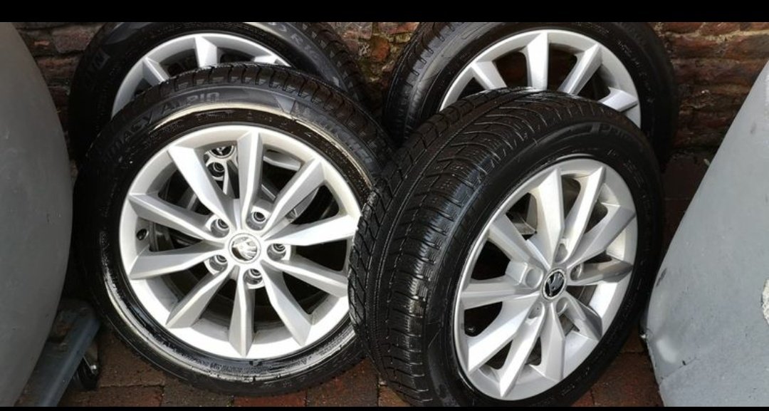

et 49 205/55 r16 will these fit on a skoda mk3
Hello i was looking for a new set of winter tyres and i found a good deal a set of rims with winter tyres on them but i'm not sure if they will fit the seller claims it will but  my research tells me the opposite does anyone know if they will fit ? And ofcourse when i say will they fit i mean will they be optimal and fuel efficient  my current rims are 18 inch pegasus and my car is a superb 2015 mk3 190 hp i don't care that much about the looks so 16 inch is fine the set he's selling is 49 205/55 r16.  Thanks in advance.
They look like Octavia MK3 rims called MINORIS with a specification of 6.5x16 ET46
Kolo z lehké slitiny MINORIS 16" pro OCTAVIA III
https://eshop.skoda-auto.cz/cs_CZ/kolo-z-lehke-slitiny-minoris-16-pro-octavia-iii/p/5E0071494++8Z8
The standard 16" Superb MK3 rims are 6.5Jx16 ET41, so fitting the ET46 rims will move them further into the wheel arch by 5mm. This shouldn't be a problem. The Superb MK2 for example, had two offset for its 16" rims, ET45 and ET50. The ET50 was used for winter tyres, so you would be doing the same thing by also going in 5mm for your winter tyres.
The problem comes with the 205/55R16 tyre size. This has about a 5% smaller outside diameter than the standard 215/60R16 Superb MK3 tyre size.
5% is a big difference. 1.5% to 2% is often considered the most you should change the outside diameter of a tyre by. Going 5% smaller will mean that you speedo will over-read by about 10%. So when your speedo is indication 70mph you will only be doing about 63mph. Or when your speedo is indicating 50mph you will only be doing about 45mph. Or when your speedo is indicating 30mph you will only be doing about 27mph.
Changing to 205/55R16 will also lower your car by about 15mm, so about the same ride height as a 15mm lowered sports suspension car.
Your odometer will also over-read by 5%. So if you go for a 20,000 mile service, you will only have done about 19,000 miles. This will increase your servicing costs.
The rims are fine, but change the tyres to 215/60R16 or you could take a look at slightly oversize tyres such as 215/65R16 which are sometimes cheaper. 215/65R16 would give you about an extra 10mm of ground clearance compared to 215/60R16...which could be useful in deep snow.
205/55R16 are much cheaper than 215/60R16, but the Superb MK3 doesn't use cheap tyre sizes...unlike the Octavia MK3.
When you are buying OEM rims, always ask the seller what the OEM part number is before purchase, so that you know exactly what you are buying.

thank you i won't buy these  since it's not optimal
