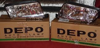

I did the same as AnnoyingPentium and never been flashed and had no problems on MOT.
We have the same units too from DEPO, they came from some ECP subsidiary. :)

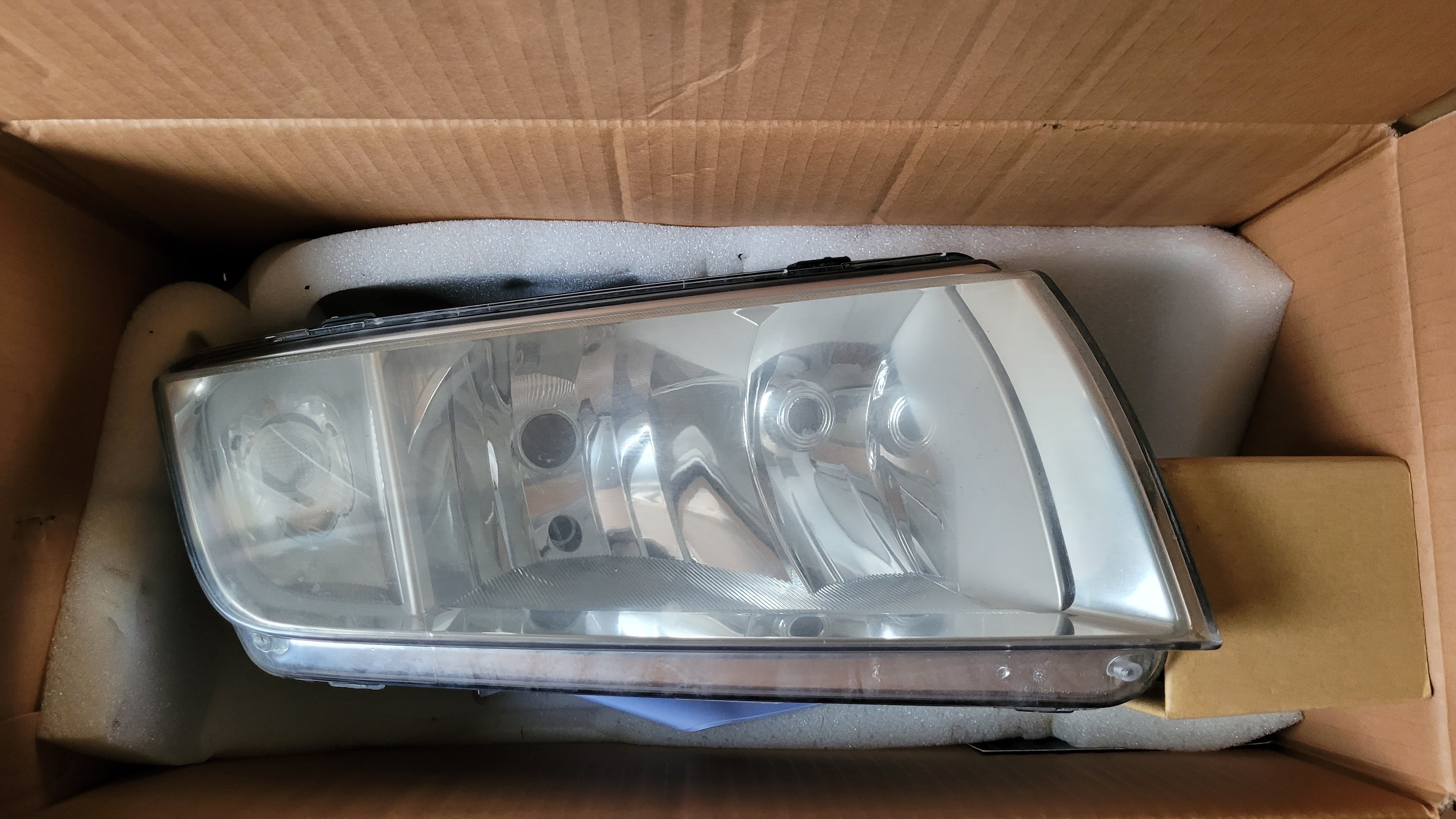

I only have a very small pic but this was them when I got them...
2 minutes ago, TMB said:
Yeah :)

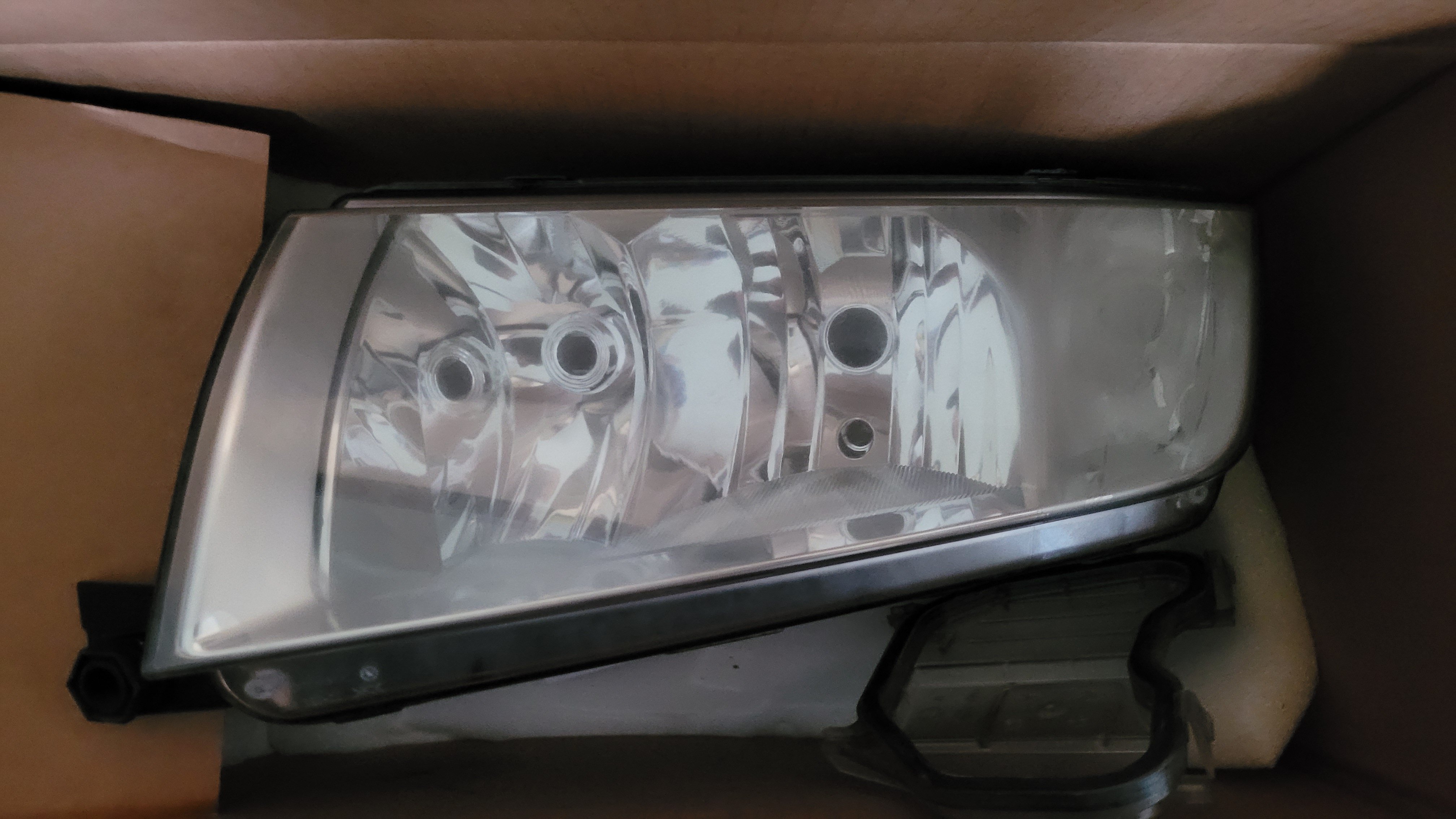

I've just got the photos of the box with the old HELLA units inside from my for sale listing on here. They're the same boxes though.
I gave my old ones away to a member on here called Hutchy who has/had a business dealing with Fabia headlights.
Ah yeah, is he still around these days? I'm having a hell of a time trying to shift the damned things.

Looking back a few posts, the units I got from "energized custom" were DEPO.
As I've posted, I've changed both sides and have one passenger side with broken securing lugs and a driver side totally intact, and needing a good polish. The bits on the broken lamp are free to anyone needing them ( unless someone can repair the unit lugs, and then it's free to take away etc), The driver side is intact and is free to a good home ,if collected etc.

I fitted exactly the same units also and carried out the chalk mate set and they were fine at mot time.
