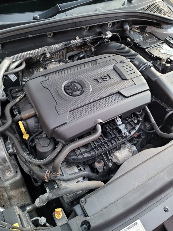

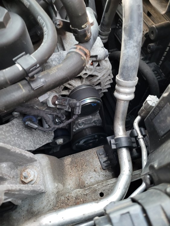

I looked under the lid for confirmation, i am no expert mechanic but that looks very much like a cam belt to me.
It is supposed to be the same engine as the Golf GTI

@briinthesky That's your auxillary drive belt connected to the alternator (top) and air conditioning compressor or possibly the water pump (i'm a TDI owner so different layout) the camshaft will be driven from a chain or belt (petrol or diesel engine dependent) that is well protected from the environment.
If you want to see how the chain is inspected then watch this video in this link, its  "buried" under some covers and requires some dismantling to get too.
https://www.shopdap.com/blog/post/timing-chain-tensioner-and-chain-issued-for-2-0t-tsi-vw-and-audi-models.html
