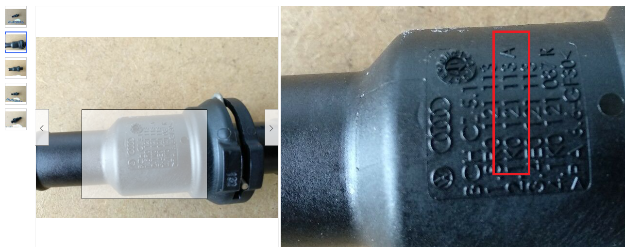

If you're a very lucky person, it may have been installed with the part number facing in a direction where it can be seen unobstructed by too much other stuff..

Thanks for the quick replies. Temp never varied from 90 degrees until a few months ago. Will have look at the part when it stops raining to see if there a number. They still have the old stat and hopefully the bag the new one came in but not open till the 4th. Steve

Hi. Had a look at the part but can't see the number. It was £27 for the stat. Might have to change the main thermostat as well. Seems OK in outside temperatures above 5 degrees but struggles below that. Steve
