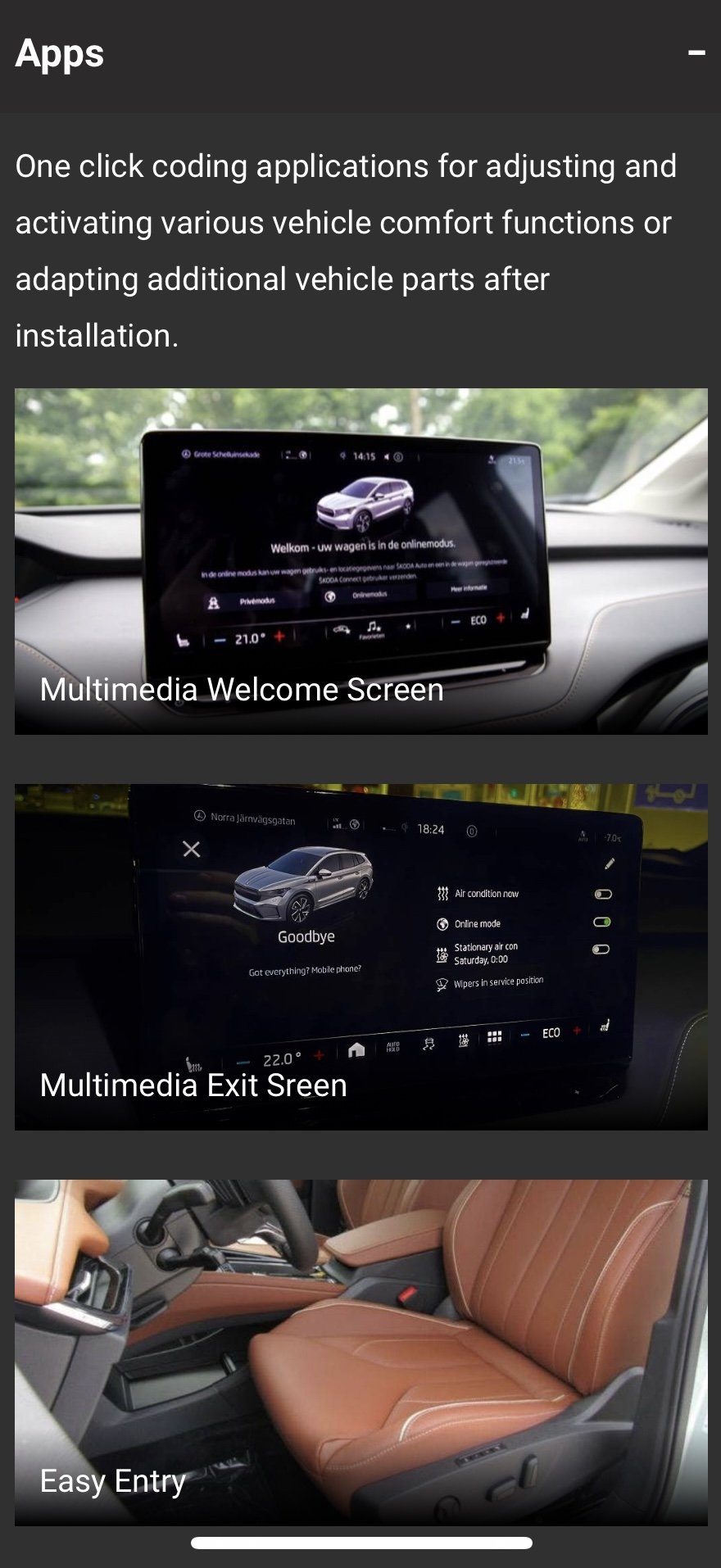

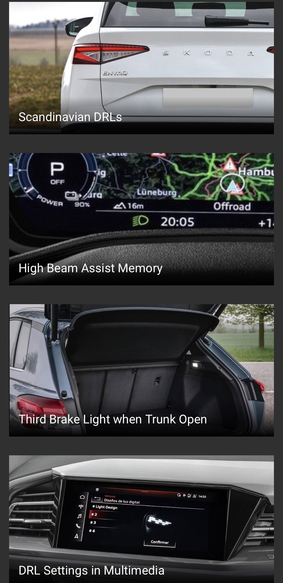

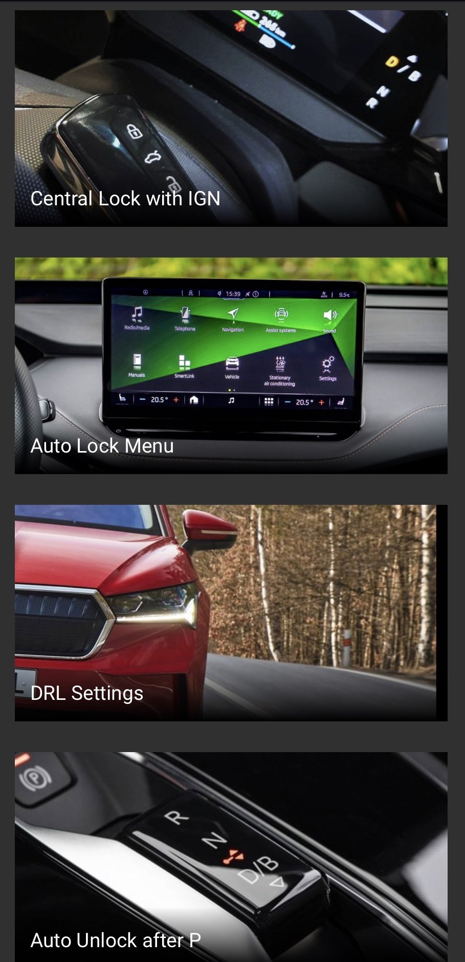

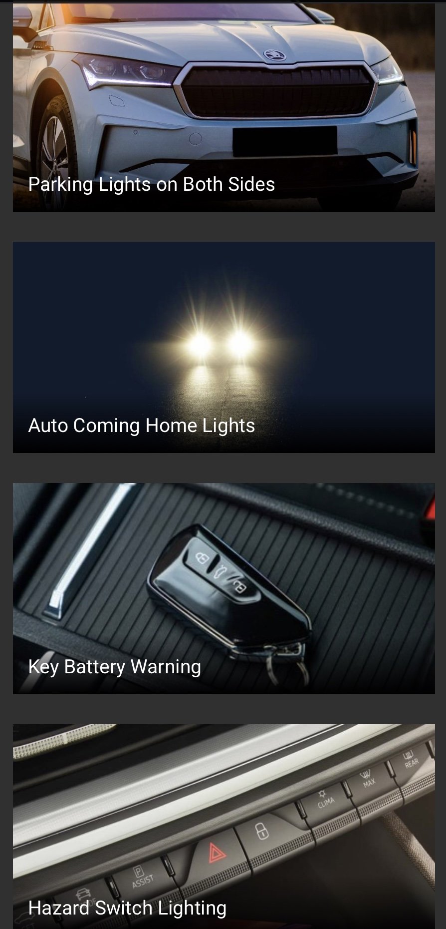

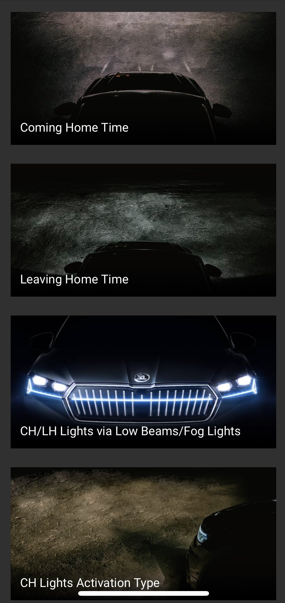

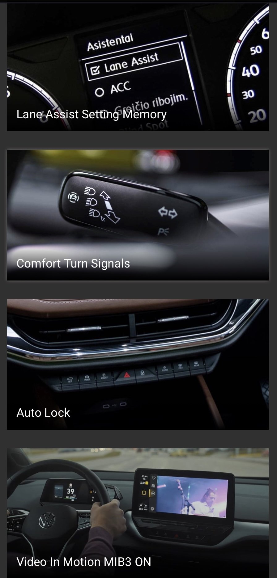

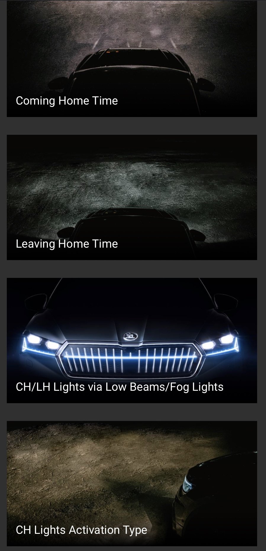

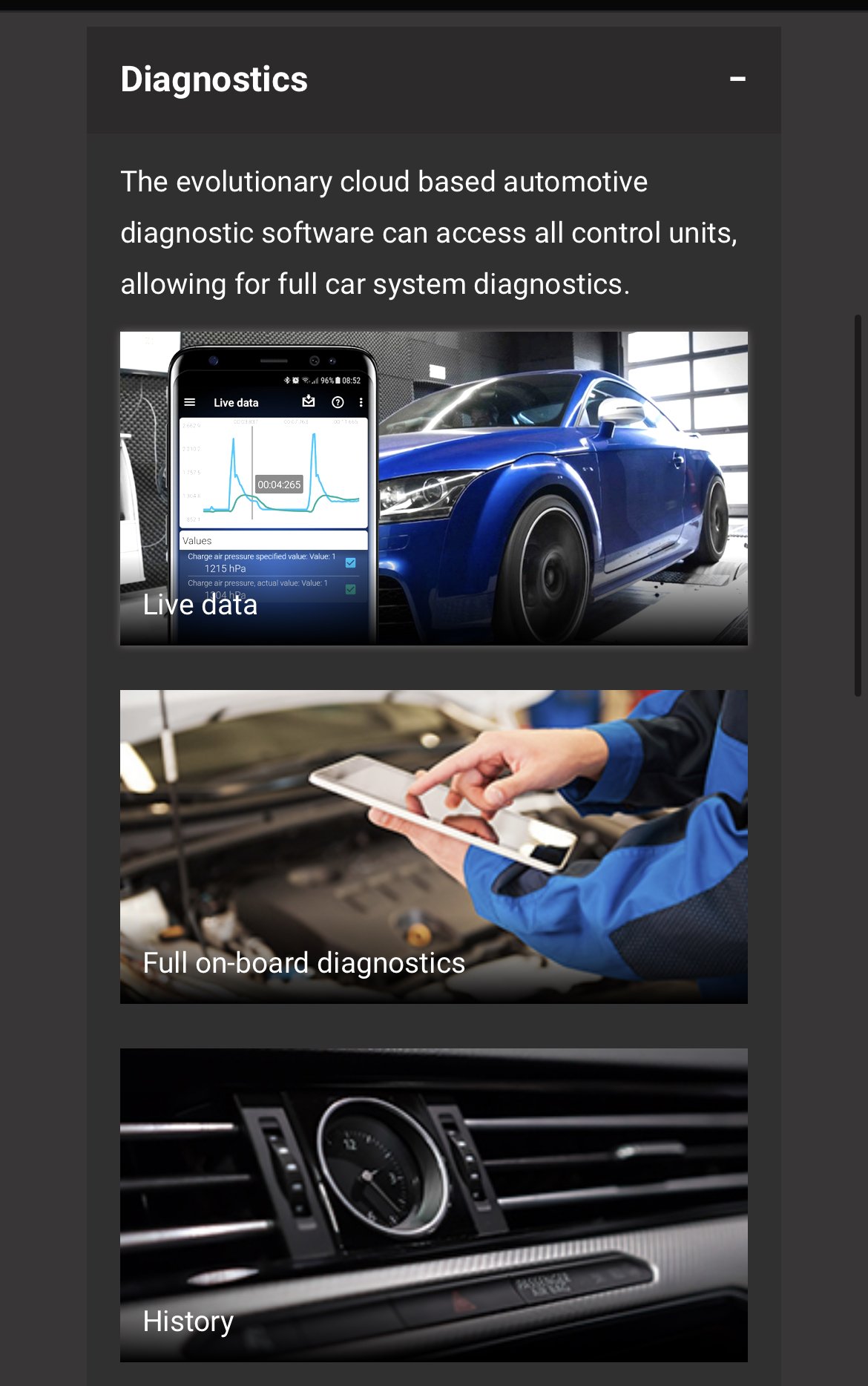

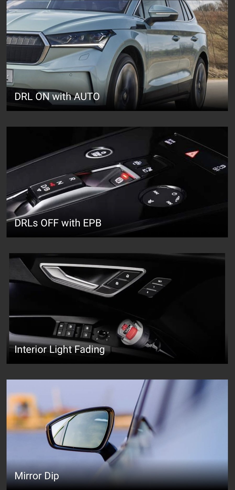

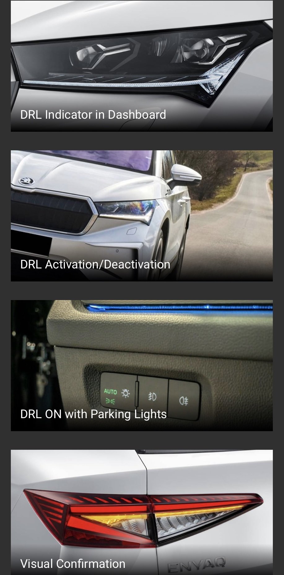

I have the OBDeleven scanner, used it on my VW Tiguan and my wife’s Skoda Fabia, i was meant to be getting my car Christmas Eve but it’s still not shown up and the dealership, it’s stuck in the port of Tyne 😞. I have added a few photos to show what it can do with the Enyaq, hopefully mine will be here in the next few days and I can tell you exactly what it can do.

I have only used OBDeleven tool so far and it’s perfect for home diagnostics, it also has a backup function so if you do mess something up you can revert it back to its original state.
With the OBDEeleven tool you buy the dongle and a license, then use credits for the apps (the simple on/off, as described in my previous post) you can pay for the credits in app or watch adds to earn one credit (5 ads max per day).

Is that one credit for each of the pictures in your post @chopper85?
So each “app” costs different amounts between 5 and 10 credits. Best thing I can suggest is have a look at some of the videos on YouTube.

hi,
I have tried obdeleven to setup easy entry and the results are mixed, sometimes, a few times, it works and does nothing most of the time.
Would be really interested if anyone manages to turn off the lane keep assist function by default. It takes at least 3 button presses to turn it off each time you start.
It works well on the motorway, but in narrow country roads, it 'bounces' tugging the wheel from one side to the other and is pretty annoying ....

Apparently OBDeleven have a simple APP in which you can set the Lane assist to have 3 settings using the standard buttons :-
1 - Always ON after ignition (standard)
2 - Always OFF after ignition.
3 - Memory - resorts to last setting after ignition.
Must admit I havent tried it yet as I dont mind the lane assist.
