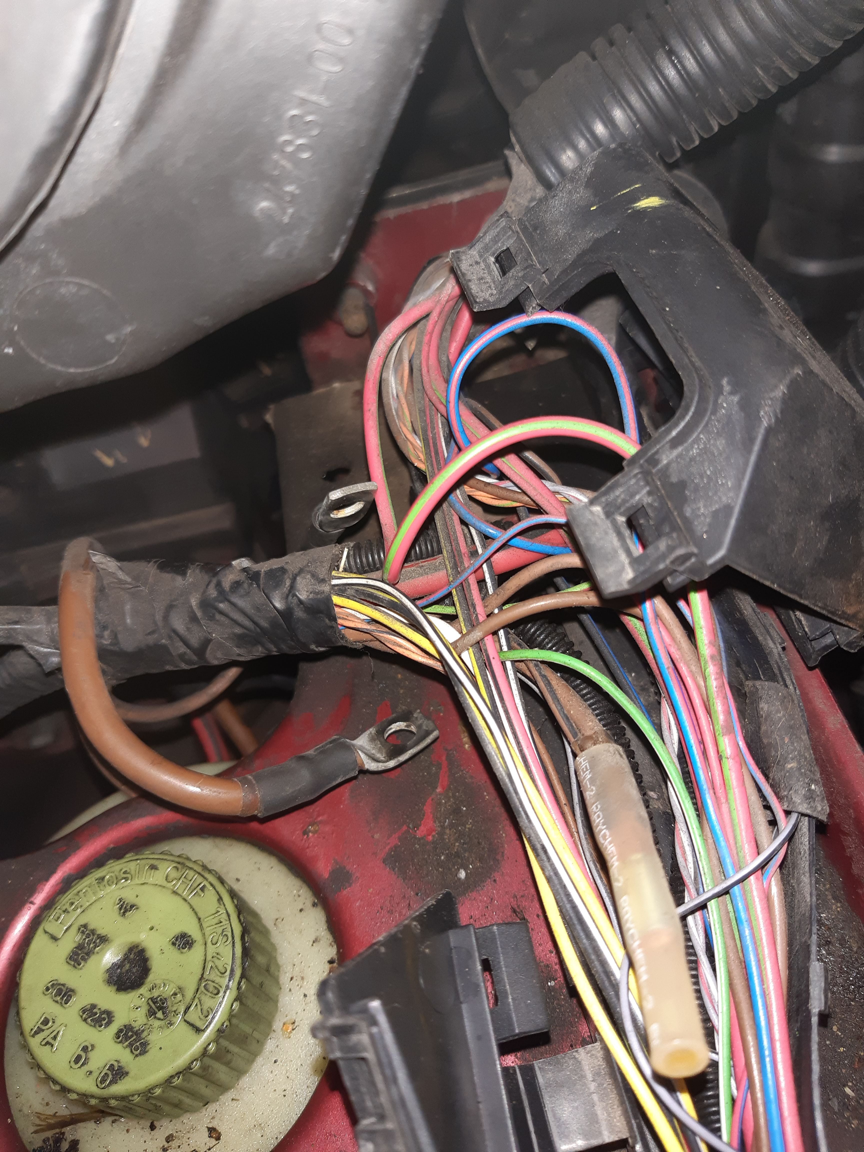

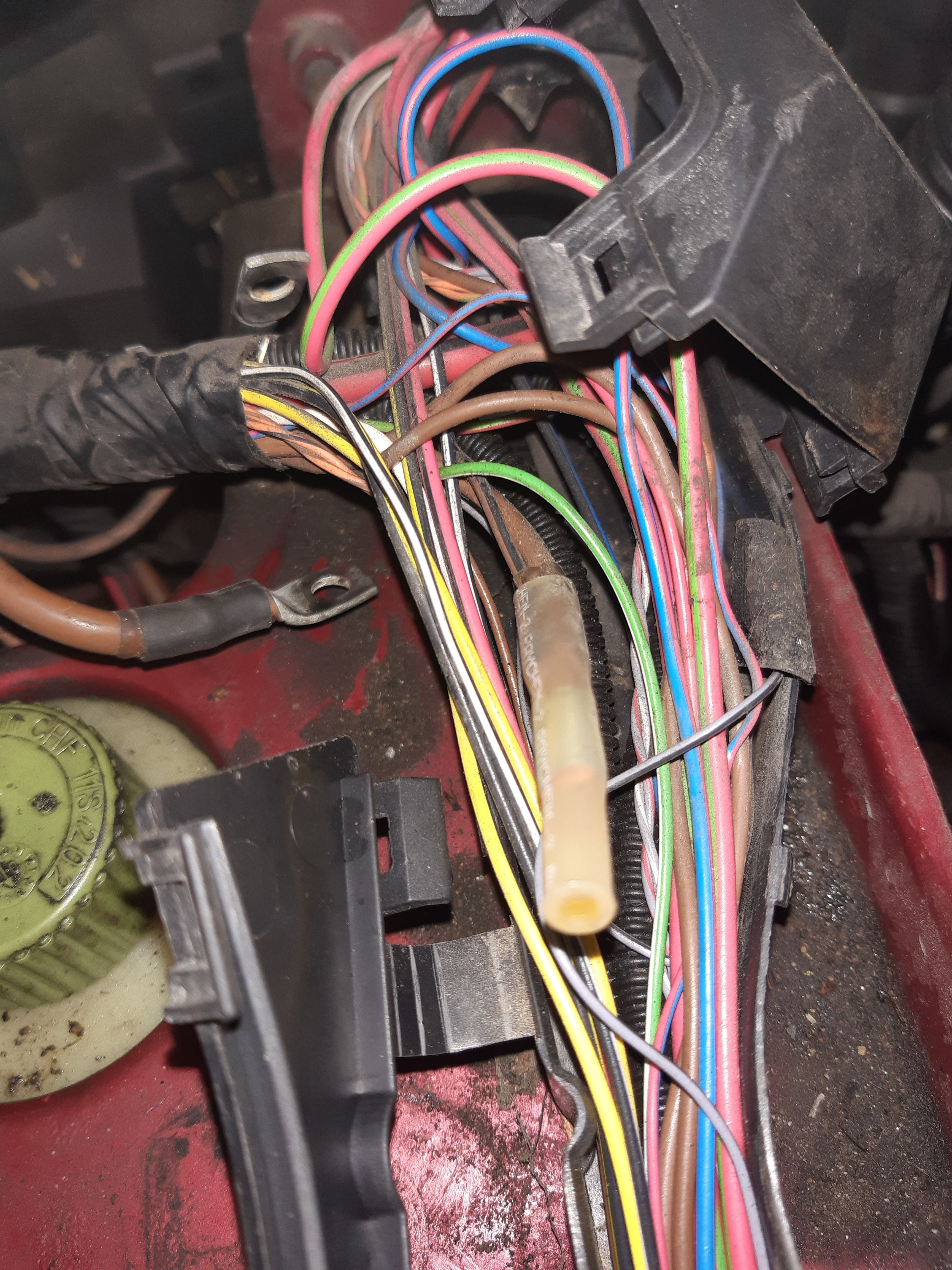

Update: I took the battery and battery tray out yesterday to have a look to see what's going on with this pump. There was a conduit of cables running under the tray (more later) and I discovered that I could access the plugs on the top of the pump fairly well if I removed the black plastic trim from the front bumper (I suspect that this would hold a fog light or driving light on a higher-spec model. As it was it just pulled out, nice and easy).
And I saw nothing amiss. All seemed to be as it should, not cables were frayed or worn or broken, all three plugs on the pump looked to be clipped in fine. I unclipped them and re-clipped them to make sure that they were indeed as they should be, and I also removed and cleaned the connection on the end of the earth strap and did the same to an earth point on the body just above the steering pump motor. Has it made any difference? I don't know; the light didn't come on when I turned the engine on afterwards but it always was an intermittent problem so I wasn't expecting it to.
One Q: the wiring in the conduit looked somewhat ramshackle, with black plastic tape around it. It also had a peculiar looking connection that looked like a piece of clear heat shrink about 2 inches long, which appeared to connect a heavy gauge brown/black wire to a much lighter gauge wire of the same colour. Is this from the factory or has someone else been here before me? Here are some photos.
20220114_172949.thumb.jpg.e61b5dea3c877aba9e9738ae9f0e02fc.jpg20220114_172957.thumb.jpg.de675f4f0df66b67b7689becfb50db20.jpg
Thanks again for your help. Time will tell whether this has made the problem go away.

I expect all that is exactly as it was when it left the factory.

Wino, thanks. It just looked a bit ... scrappy. The old and curled insulation tape didn't help.
