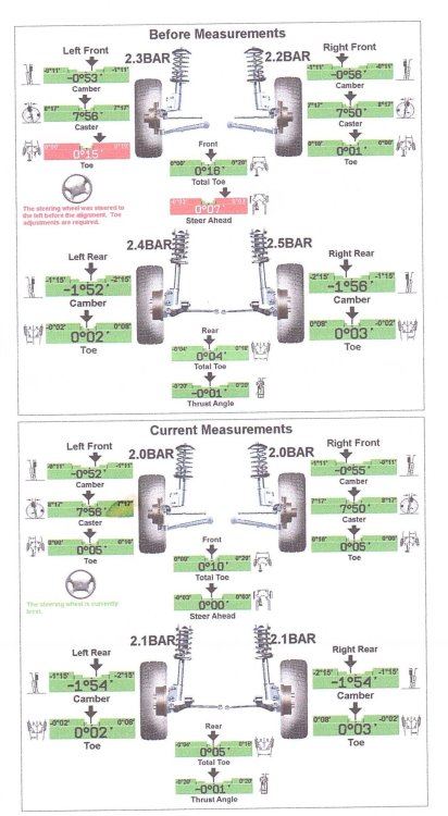

I had a full set of Michelin Pilots fitted 2.5 years ago and have done 15,000 miles on them. I’ve just replaced the fronts as they were wearing on the insides, so bad that fabric was just coming through!
I had Hunter four wheel alignment done at the time by a highly regarded garage. I’m now wondering if they did the job properly.
The attachment show the results at the time. Anyone with any views as to whether it was done correctly?
Obviously I need to get it redone. I live out in the sticks and my choices of Hunter equipped garages is a bit limited. The garage I went to that time has the best number of reviews of the lot!

I don't know the factory values, but they have definitely corrected a couple of values that were flagged up as out, and would have caused the wear you report on the front end.

Not at all, everything was spot on and within limits other than a previous tracking adjustment had been done on one track rod only meaning that when the vehicle drove in a straight line the steering wheel would have been slightly off centre. In correcting that they have got the tracking to the nominal setting from one closer to parallel but within the allowed tolerance.
With the tyre wear you are experiencing you dont need a 4 wheel alignment to see what is going on, old school Dunlop tracking guages like mine or even a stringline or two straight edges to see that it is toeing in or out massively.
