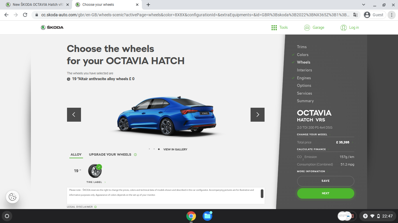

i thought vrs octavia dsg came with 19 inch wheels?
@Joss1733
What wheels has the car you ordered got that and have waited so long to get ?
Reads like 19" here.
It depends what country you order the car in.
In Finland, Czech and Gemany, the RS model comes with 18" wheels as standard.

11 hours ago, roottoot said:
@Joss1733
yes 19inch
