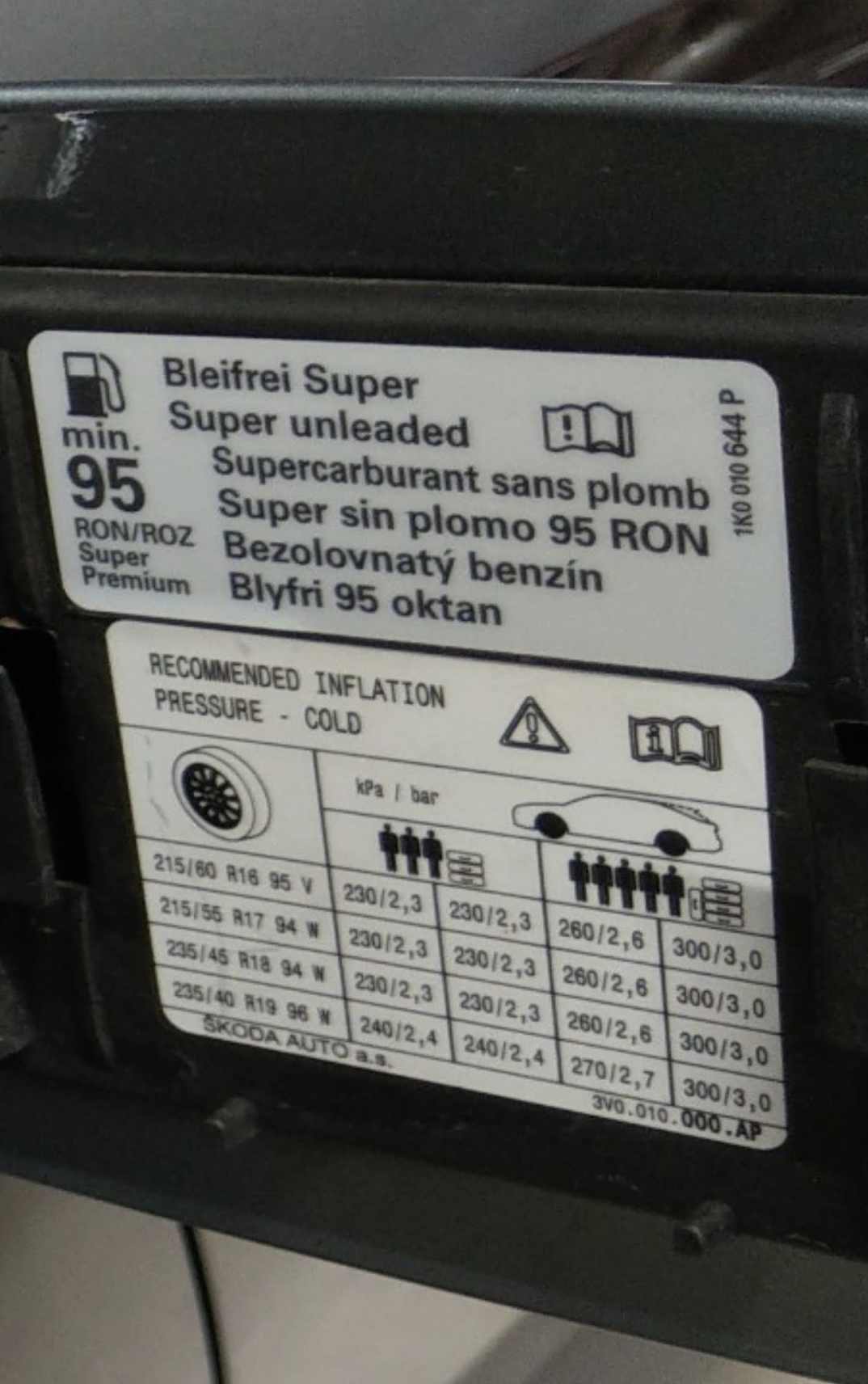

That load index for the 19" is incorrect - the minimum required load index is 96, as indicated on the fuel flap....
1027426534_Screenshot_20220115-0949542.thumb.png.ca836ec651b74d8482f47799f3005ec6.png
It's not incorrect.
I gave the standard load index, not the XL (eXtra Load) index.
I used it to compare the comfort levels and assess the tyre pressures between different tyre sizes.
You can't compare comfort levels and tyre pressures from one size to another, if you use the standard load index on one tyre size and the XL index on the other tyre size.
Going by the tyre label inside the fuel filler flap, the Superb MK3 fitted with slightly oversize 245/45R18 tyres would need 32psi (2.2Bar) front and 32psi (2.2Bar) rear with a lightly loaded car, and 35psi (2.4Bar) front and 39psi (2.7Bar) rear with a heavily loaded car. These figures are obtained by comparing the recommended tyre pressures and standard load indexes (not XL) of the 235/40R19 tyre size and the slightly oversize 245/45R18 tyre size.
The 235/40R19 tyre size can support 630kg when inflated to 3Bar, and the slightly oversize 245/45R18 tyre size can support 710kg when inflated to 3Bar. Bear in mind, that the weight a tyre can support is proportional to the tyre pressure. For example, halve the tyre pressure and the weight it can support is halved...and vice-versa...double the tyre pressure and the weight it can support is doubled. You can't inflate a tyre to more than it's recommended tyre pressure, and you can't support more weight than recommended by the tyre manufacturer.

I disagree.
It's simple - the fuel card states the minimum load index required, for each of the approved tyre sizes.
It's not about, nor states, the tyre being standard or XL.  That's the owners choice.
If u have 235/40/19 tyres, the minimum load rating required is 96.
Simple.
I can b stupid n get a dirt cheap 235/40/19 tyre with a load index rating of 92, which fails to meet the minimum requirements, hence a defect, and making insurance void.
Or I can buy same sized tyre, with the correct load rating of 96, for double the price (almost).
I also don't understand why u keep referring to the Superb being fitted with the 245/45/18 tyres - it's not. Standard is 235/45/18, as shown in the fuel card too.
Yes u can fit 245/45/18s, but it's not the standard, nor common.
I've increased the tyre profile on mine by fitting 245/40/19 (96 XL) instead of the standard 235/40/19.
Edited by JR RS

18 hours ago, JR RS said:
I disagree.
Simple.
There's many inaccuracies in your post.
I usually refer to the 245/45R18 as slightly oversize, never as a standard fitment because its not.
I haven't suggested anyone fit standard load index 235/40R19 tyres.
I have used the standard load index in all tyre sizes to assess comfort levels and tyre pressures, as this creates a level playing field for the comparisons.
Comparing a 245/45R18 96 SL (Standard Load) index tyre with a 235/40R19 96 XL (eXtra Load) index tyre would be meaningless, because the standard load index tyre gets its load index from 44psi (3Bar), whereas the XL index tyre gets its load index from 51psi (3.5Bar).
235/40R19 with a standard load index aren't necessarily cheap. For example, by far the cheapest tyre in that size currently listed on mytyres is an XL tyre. However, I've never encouraged the use of cheap, poor performing tyres as it's a very bad idea. In fact, I'm a big fan of top performing all-season tyres with the 3PMSF symbol that work well in all conditions.
From a point of safety, a 235/40R19 standard load index tyre can support the same weight as an XL tyre in the same size when they are inflated to the same pressure up to 44psi (3Bar), eg. both tyres can support the same 630kg weight when inflated to 44psi (3Bar). The XL index tyre can only support more weight than the SL index tyre when inflated above 44psi (3Bar).
Edited by Carlston
