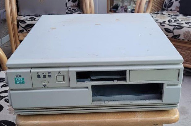

It was my late father's when he was about my age, his first computer on a working wage as an apprentice for Ritchie's Printing in Kilmarnock, bought second hand around 1995/1996 we reckon. I've got almost everything there for it including the original Conner 100-and-something megabyte hard drive, a Sound Blaster 2.0, and a 256KB video card. Here's a photo of it... I have the blanking plate too for that 5 1/4" drive bay, plus a floppy drive from my Pentium II to go into it. It powers on, but doesn't get much further since there's no RAM.

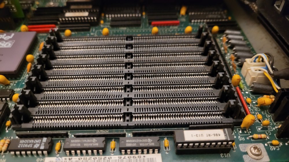

Are you sure they are 72 pin and not 60/30 pin?
Close up photo of memory slot would help. 72 pin have a gap in the middle of the slot

As above, I'd have thought an SX/25 would be 30 pin. There's a few different sorts, the main difference if it's parity or none-parity, so it's probably best to start with some pictures of the board.

Some photos of some perhaps relevant stuff.

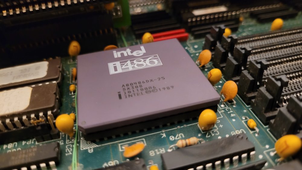

Turns out that's a DX, no? The motherboard is proprietary to the PC case since it's not a standard AT fitment.
Edited by AnnoyingPentium
Yes thats an early 486DX. And those are 72pin EDO ram slots. I might have a few in the loft somewhere amongst all the computer junk in the loft I've hoarded since god knows when.
Why would you want to ressurect a 486 system? Are you opening a museum?
It's been a while since I've had anything that age open, but I'm surprised that it's 72 pin RAM with that many slots. I wouldn't expect to see more than 4 slots for 72 pin. 30pin normally has more because it needs to be installed in pairs. If it is 72 pin, 486's would normally be FPM rather than EDO, but EDO will almost always work.
