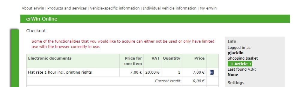

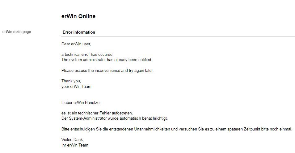

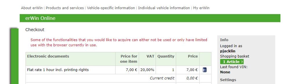

Is there any other place other than irWin Online I can get wiring diagrams for a Superb MK2 ? Every time I try and buy an hours printing I get an error message I've also tried using a different browser.

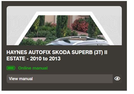

I got a discount code so it cost me £23.40  for an online manual. Though not sure I'm over impressed as the wiring is for LHD !

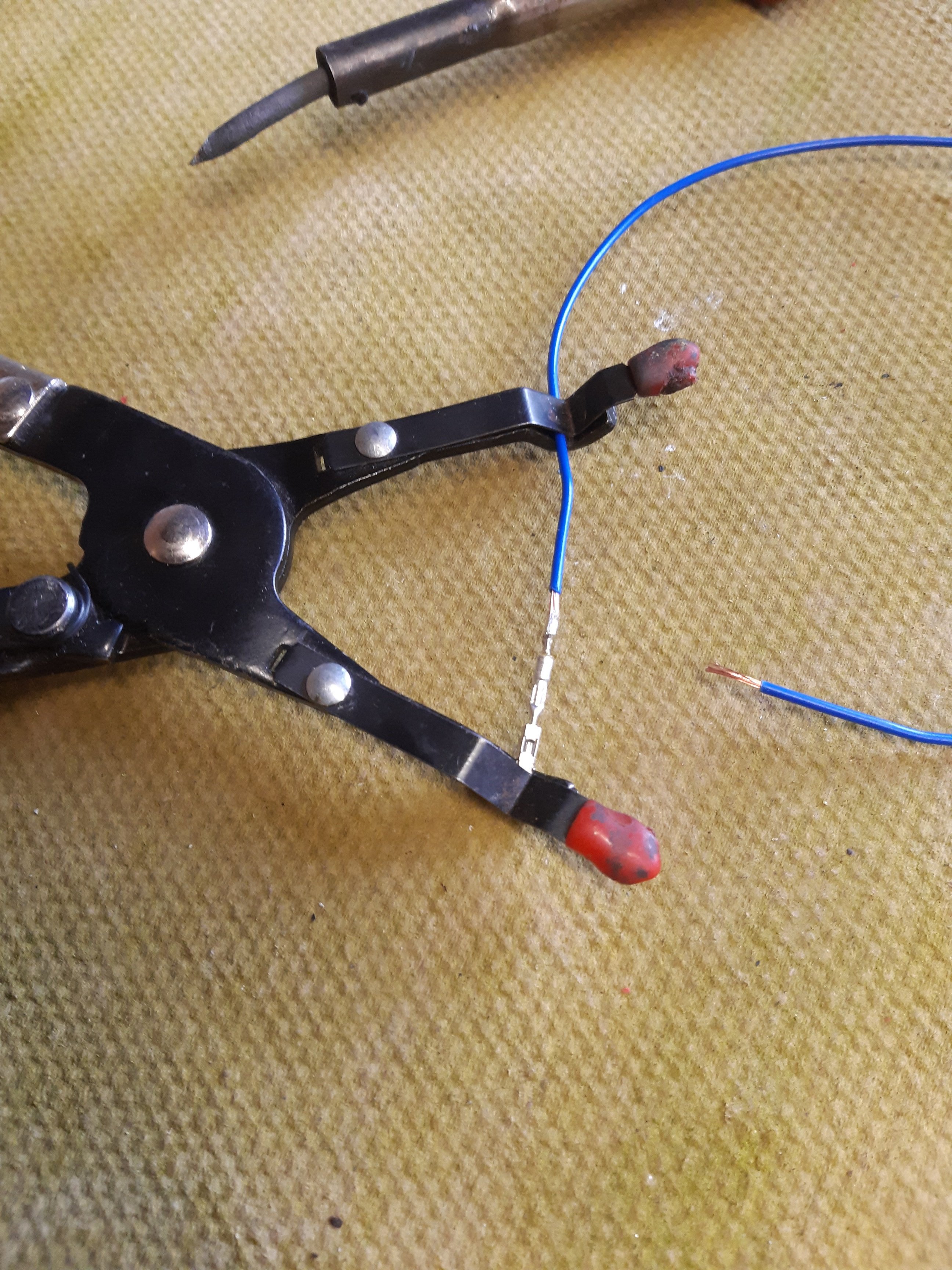

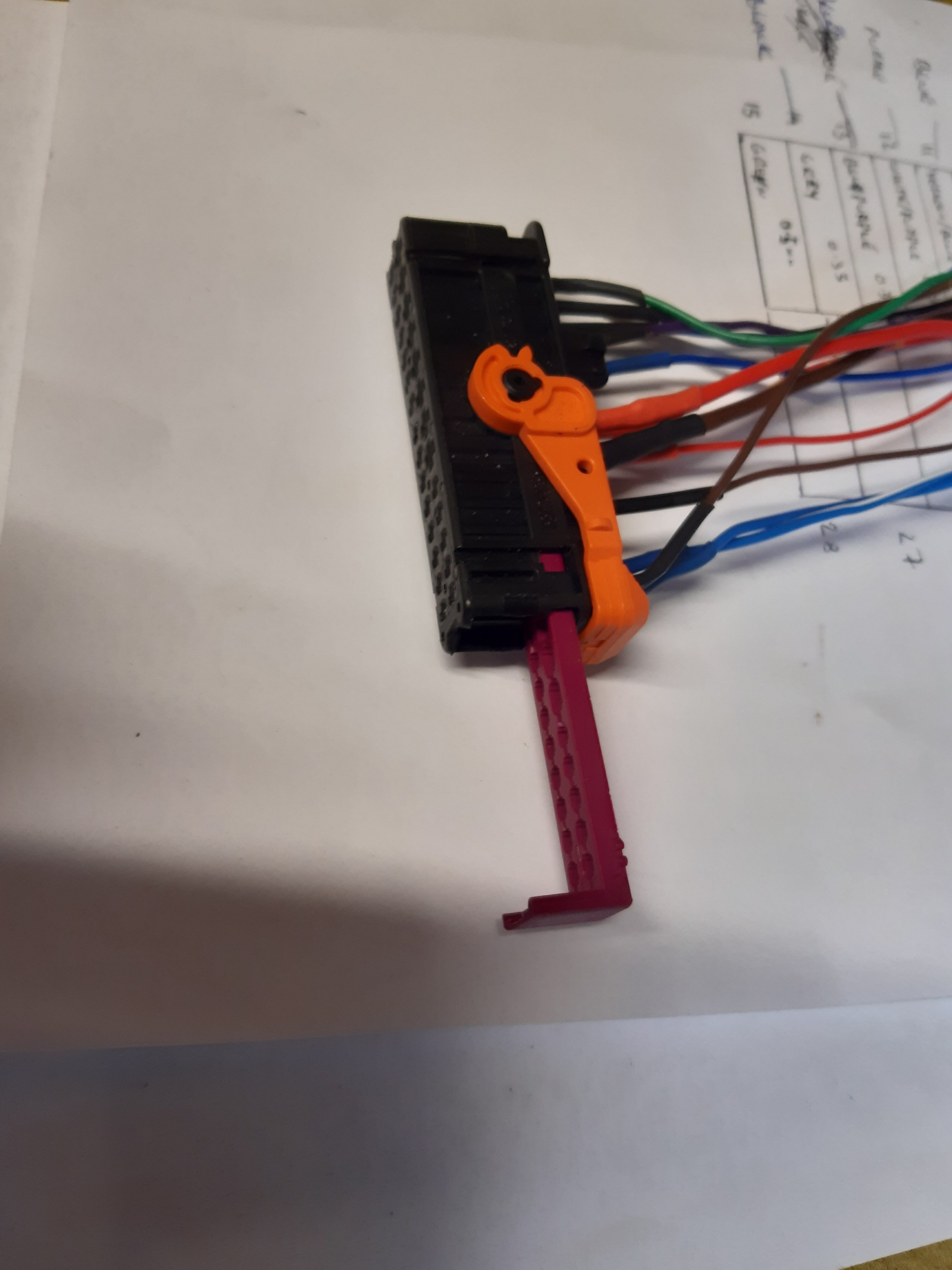

I'll replace all the wires in the front door looms for new more flexible wire. I've seen the kits on Ebay but at around £30 a door is more than I want to pay and I've currently got the time as I'm between jobs. I appreciate for a garage to source a repair kit as it's probably the quickest cheapest option for the customer.

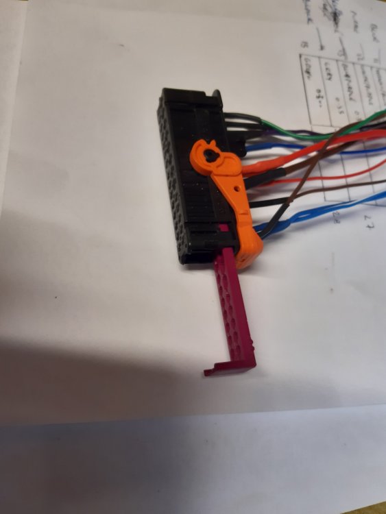

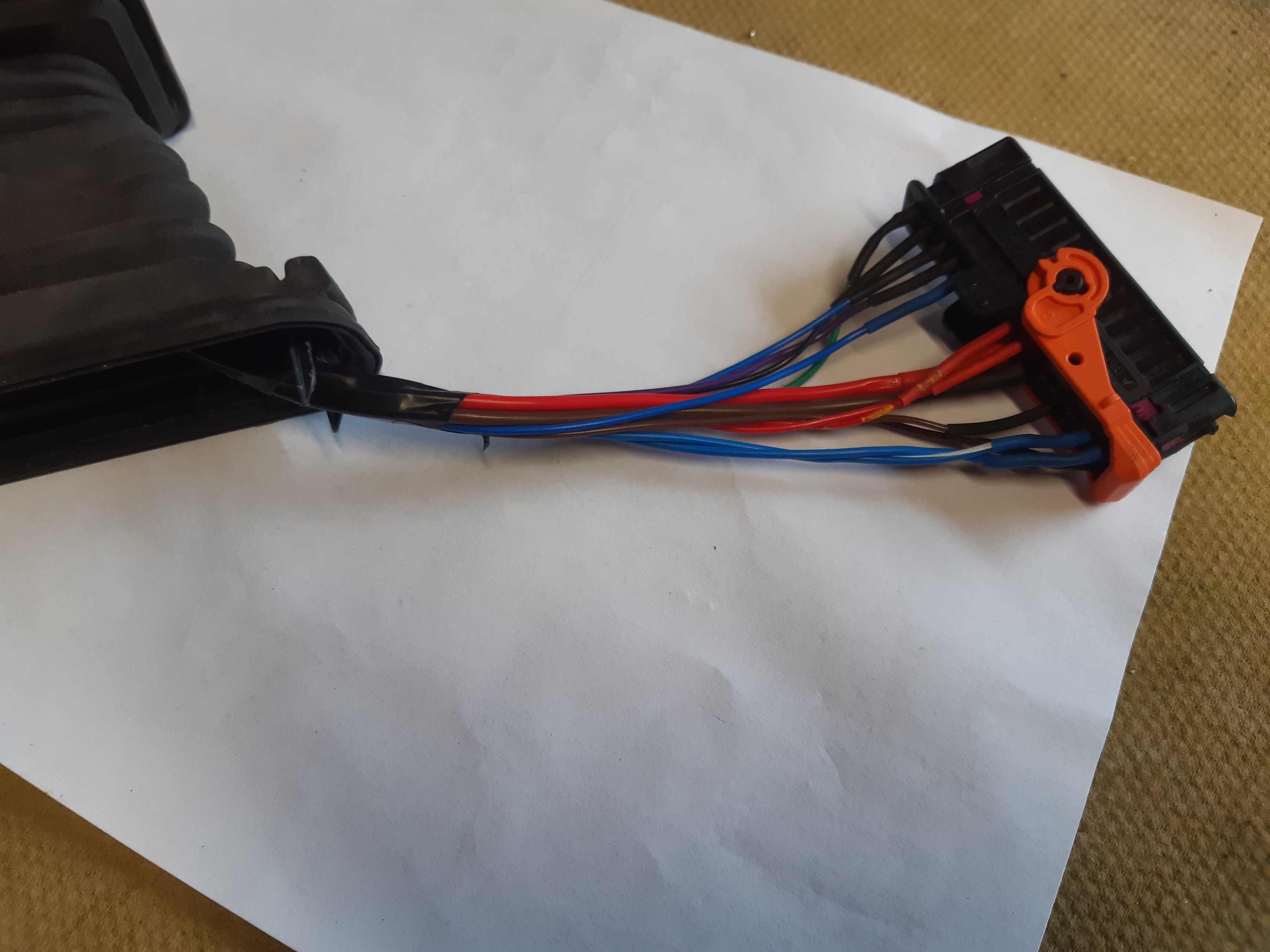

So the broken wire went to the central locking switch so I never noticed which door wasn't locking / unlocking as I tend to use the remote. Out of the 13 wires that go to the drivers door 7 were damaged including the broken wire which had additional cracking to the insulation which felt brittle. On the two largest 2.5mm² wires you can see marks where I assume they have been rubbing against others wires. I guess the wiring to the other 3 doors will be in a similar condition.
Edited by Derbyshirebod

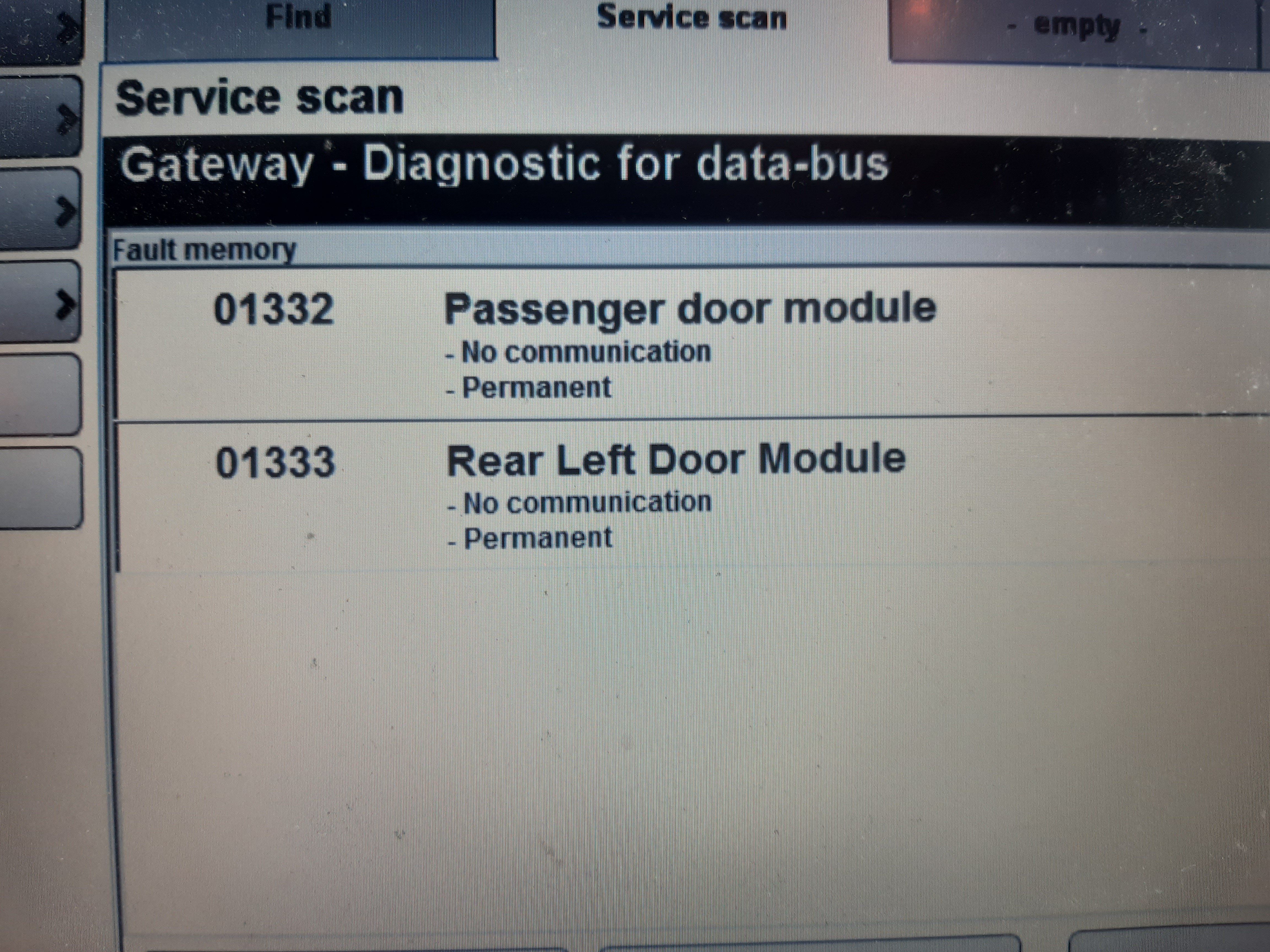

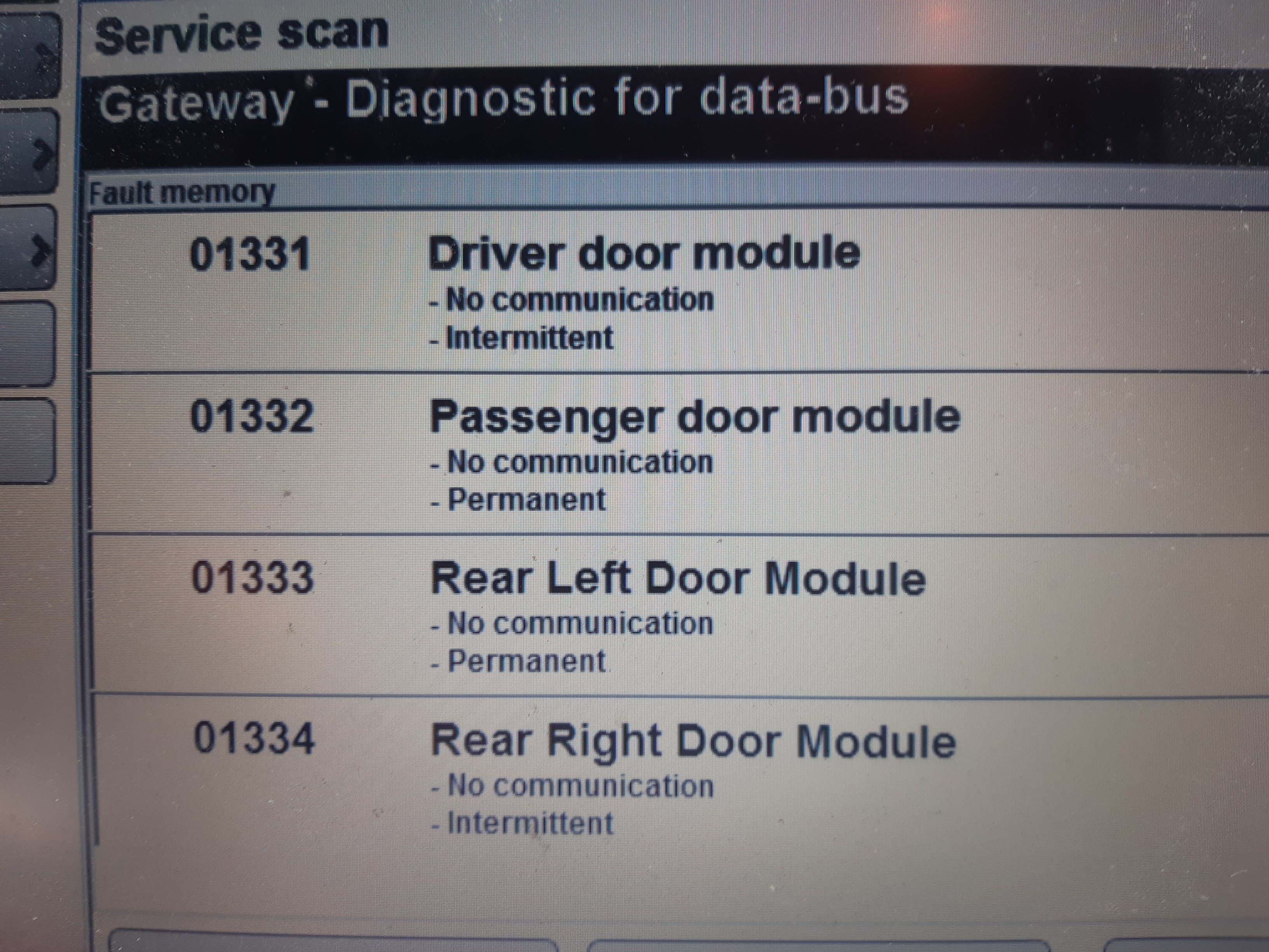

Before I started I checked for error codes and found 4 one for each door. The 2 intermittent ones cleared and the 2 for the passenger doors remained.
That's about 240mm of each of the 13 cables replaced in the drivers door loom. The 2 N/S doors still have none of the functions working. So now on to the next door!

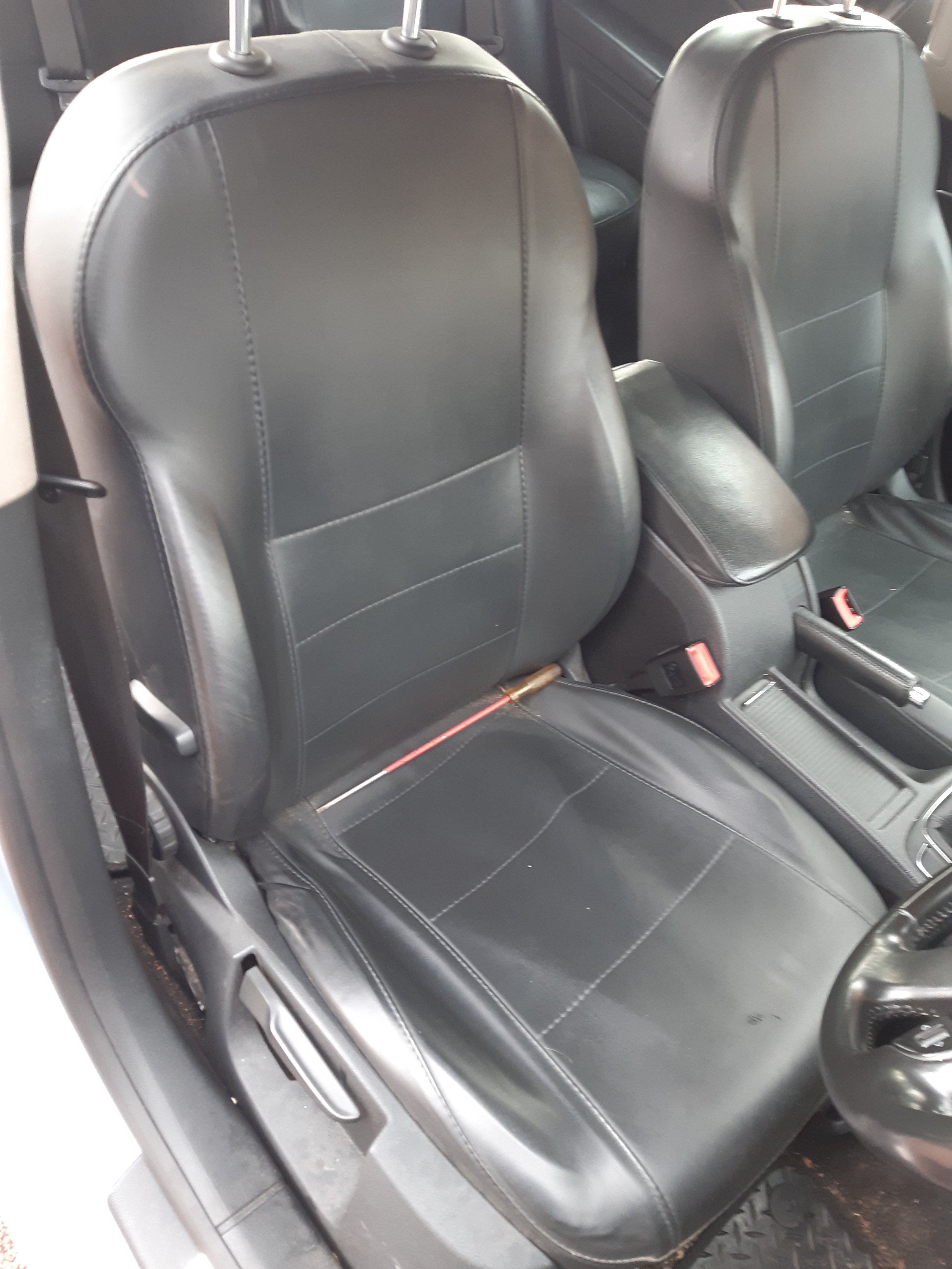

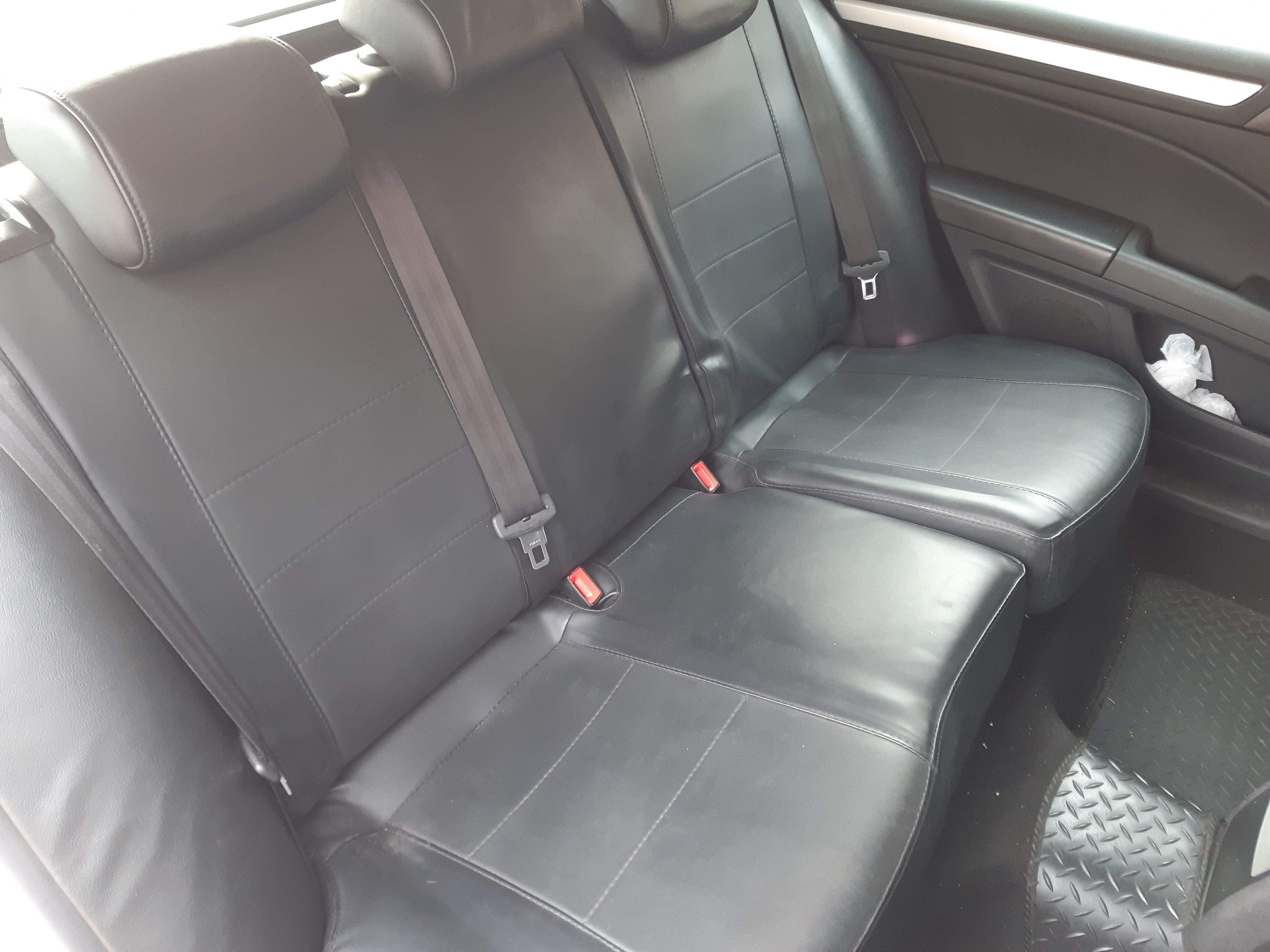

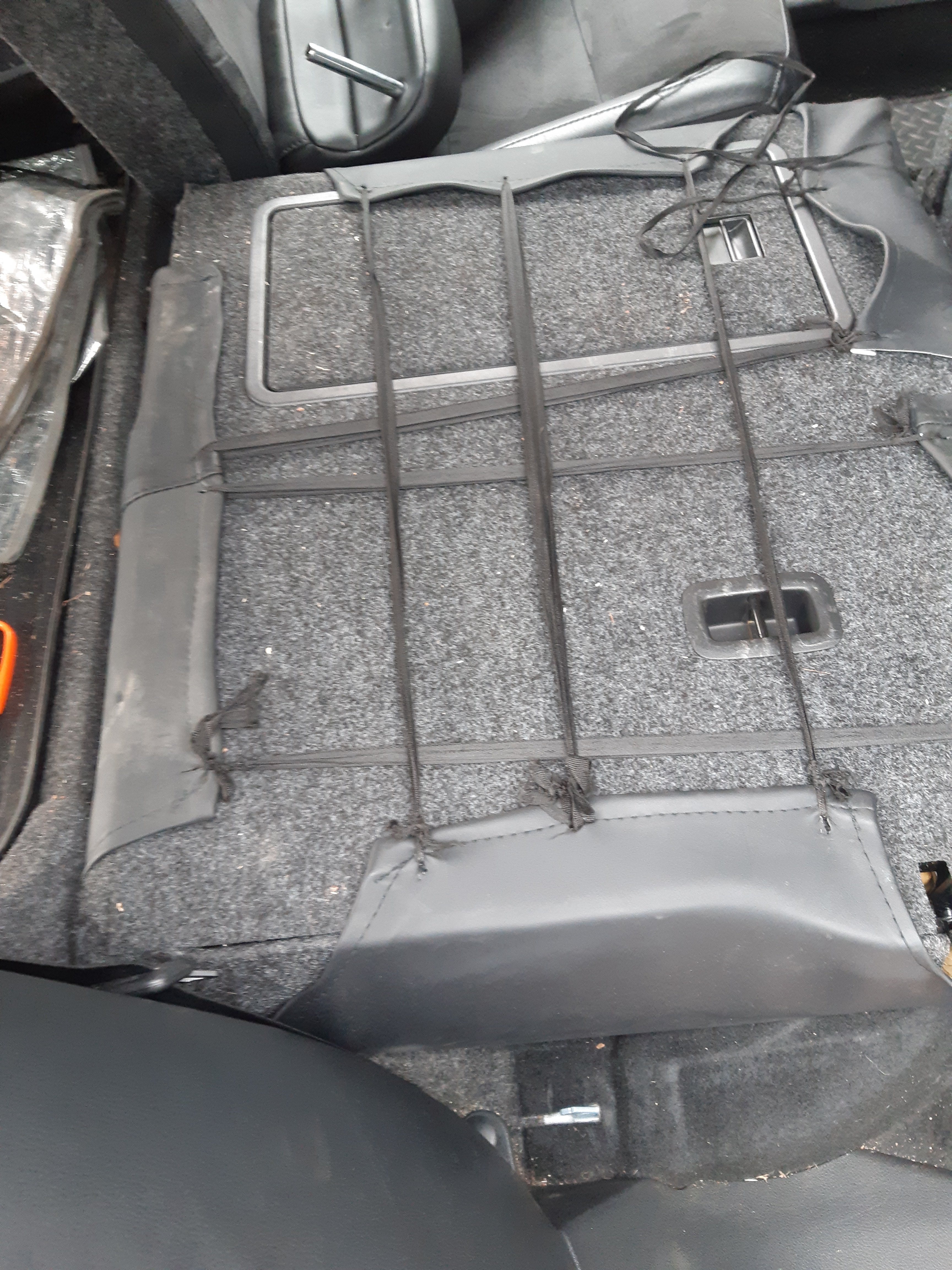

Yep easy to clean deposits of bodily fluid from. Not so comfortable if you sit on them too long as they don't breath!  Couldn't use the rear center arm rest either.
It wasn't a 5 minute job taking the seat covers off! The front seat covers took ages to get off!20220128_114035.thumb.jpg.95d4dec497328581eef1299ad42ea104.jpg

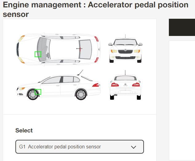

I can't see any wiring diagrams other than for grounding points, fuses & relay locations which isn't very accurate. Wasted my money IMO buying an online manual.

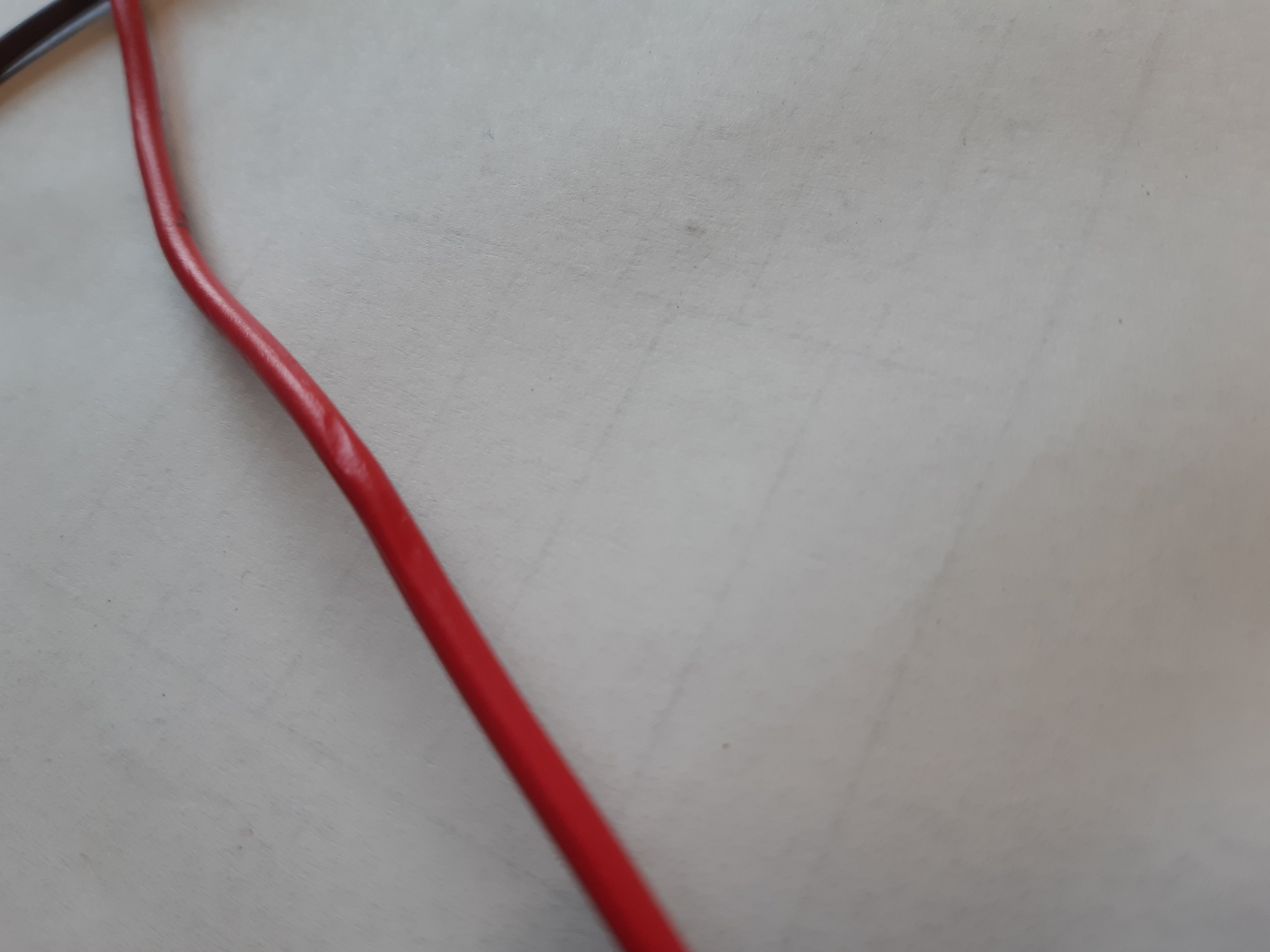

I've still got the same issue with both N/S doors not working. Though have now found the earth cable to the N/S front door has broken. Can also see the positive cable insulation is cracked. I can understand why none of the door functions aren't working but why would that affect all the rear door functions? I've not checked the wiring for that door yet. It would be good to have sight of detailec wiring diagrams.
The master controller is in the drivers door, any signals to operate the rear door locks, windows etc go via the master controller and I think that is the case even when you operate the rear door handle or the window up/down switch on the rear door.
Editted, As your car is RHD then the above does not make sense, could you possibly have a broken wire on the drivers door loop or perhaps a corroded contact on the drivers door controller?
Spoiler
Why doesn't the LH front passenger door not working not make sense? The main earth wire is broken as in the photo. The window and neither does the mirror work or any of the illuminated door switches. Why the rear passenger door lock or window don't work is less clear but I've not looked at that yet.
Having wiring diagrams would have been helpful hence buying the Haynes online manual which unfortunately doesn't have wiring diagrams 😞
Both offside doors functions work. I've already replaced all 13 wires on the drivers door loom as previously detailed in this thread. Out of the 13 wires 7 had damaged insulation one of these was also broken. Which was one of the wires going to the central locking switch.
The cable insulation has lost its plasticity on most of the cables it seems.
