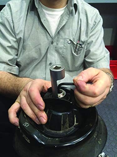

If you do use a crowfoot spanner remember you need to correct the torque setting to allow for the offset position of the torque wrench relative to centre of the nut. Maths is easy but Norbar also make a neat android app to do these calcs for you.
Neatest solution is to use something like
Laser 6496 Strut Nut Socket Set 5pc
  1. Laser 6496 Strut Nut Socket Set 5pc
Which can be used with a standard torque wrench at factory setting

Yep, Laser make some interesting tools at sensible price but unfortunately they only appear to offer as set of 5 for 50 quid odd rather than selling individual sockets.  If you needed a specific size then I reckon the purchase of a cheap 1/2" drive deep socket of the appropriate size to suit strut nut and some "minor" fettling with an angle grinder you could likely make something that wouldn't be pretty but would work the same.
£50 is rather more than I'm willing to pay! 2 new front gas struts only cost me £61.95. If I have to ever change another I'll just use my deep cranked 13/16" ring spanner again! :-)
A 13/16" spark plug socket which usually has a hexagon on the top can be used in conjunction with a long reach (110mm IIRC) hex key bit as you will see the mechanic doing in the Autodoc videos.
You can use a simple Allen key and whilst it will be fine for fitting new struts the old ones on the Yeti dont have a water cover so sit submerged throughout their life, will be very corroded and likely to round out or split the thin wall around the internal hexagon, I bought a longer hex bit to be safe, mine were just a bit too short.
I guess it depends what tools you have in your arsenal. I've got a reasonably sized compressor and air impact gun with spring compressors attached I've undone difficult piston damper nuts with it when I've been struggling.
One of mine came free that way, the other spun so I had to retain it with the internal hex, I even tried big mole grips on the piston rod, it was being scrapped anyway.
I didn't have access to all my tools where I was in France so did not have my customary 13/16" double offset ring spanner, it was worth waiting 24 hours for the correct tool (very cheap) from Amazon.fr, I released the nut with great care, it was on the point of stripping out the internal hexagon, the ones I did in the past with a spanner flat were much easier.

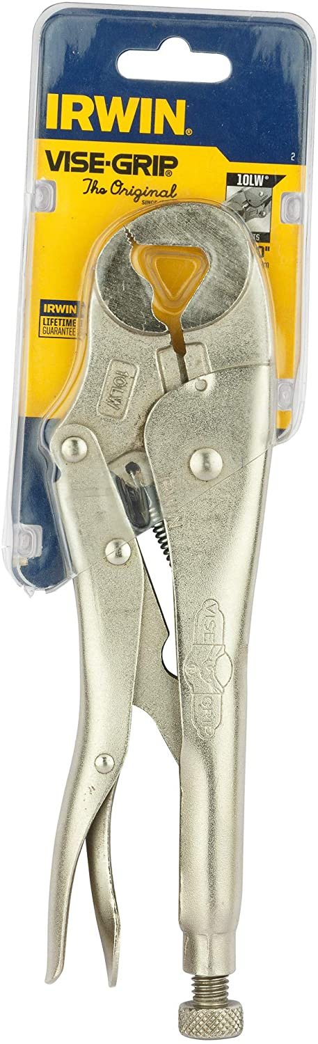

These Vice grips are great at holding piston rod and anything circular or 3 sides of a nut without damaging surface
Edited by DEL80Y
Oooh another must have tool to add to my list that I did not know the existence of 👍
Damn and double damn you Sir!
