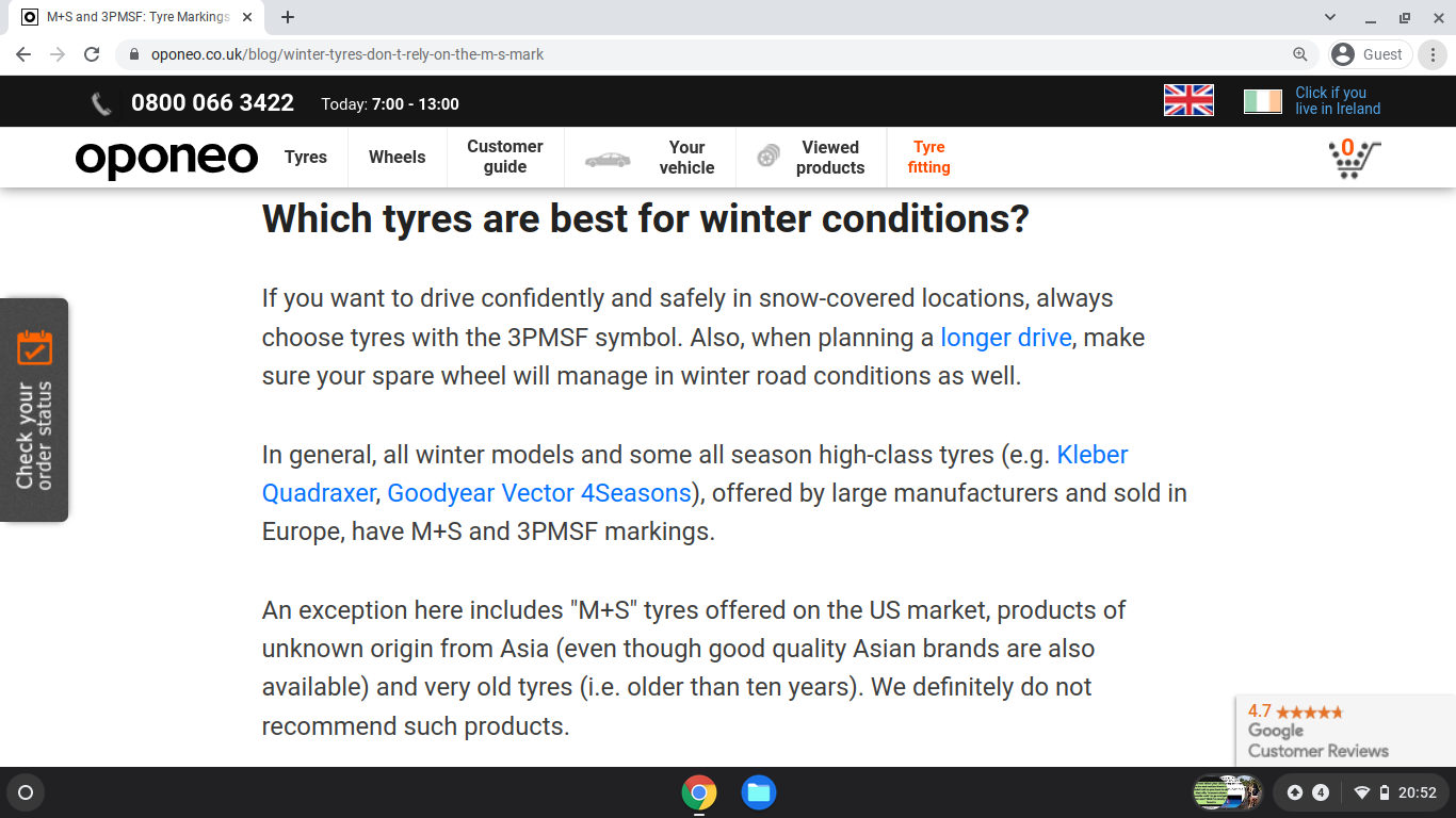

& those with 3PMSF might well also have the M&S marking.
There are 3PMSF that are total rubbish in Mud, these might well be the All Season / All Weathers, and there are some that do rather well in mud.
There were M&S marked tyres that were really rather good in Mud and Snow and over the years i have had these and used them in Mud and Snow.
