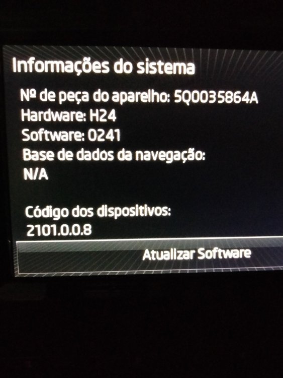

My system is thatIMG20220206201635.thumb.jpg.a80e7b0fa008b5f1090fed418140cc9b.jpg
Its an Amundsen MIB2
That's a MIB2 Amundsen.
