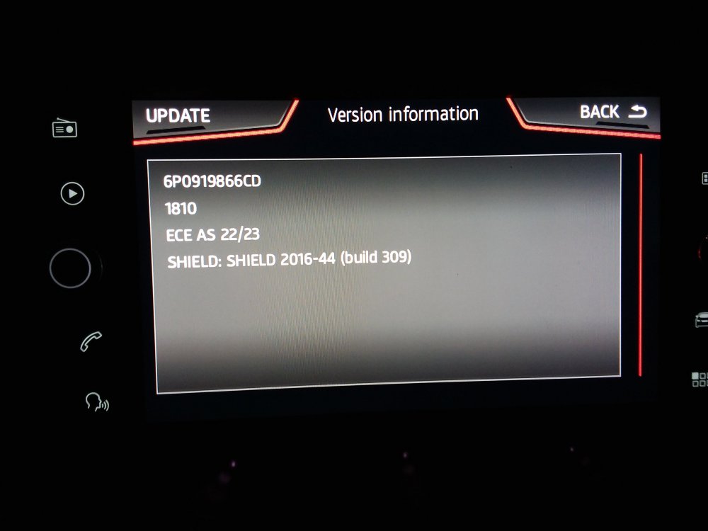

Have my success picture of the all Europe map on a 32gb gold card... reverting back to the EU1 on the Seat card since we are not taking the Arona abroad. Seat Arona is far too uncomfortable for that 😂. Skoda it won't say 6P but pulls out the Skoda part number from the common release.

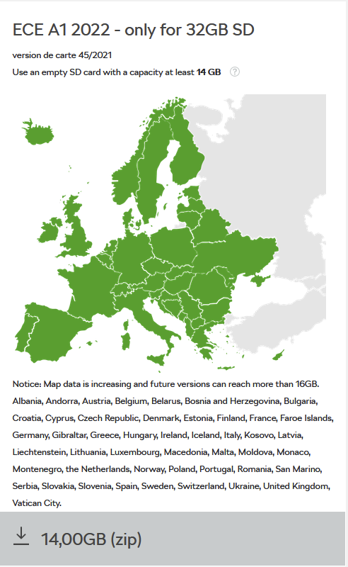

June 2021 the All European map out grew 16GB current short term solution if you require all of Europe on the card:
For GB language across Europe you just need GB and the meta_info.db in the folder:
maps\00\sds
That's a fix till it out grows the card again. Other languages pick your plate and delete the rest except meta_info.db
It does work for other countries. Had positive reports back. But this was the June 2021 release, whether the 0.2gb expansion has put that trick out of business, pass, needs testing. Couldn't be bothered, it's only for cheapskates.

Hi there ! I'm new here and totally surprised to see we can download Seat maps for our Skoda. So I assume they are identical !
I was looking to the Skoda update portal and I'm sure you already know we can download GPS updates. For example this one, provided you have a 32GB SD card :
https://infotainment-cdn.skoda-auto.com/base/maps/STD2_1720_EU_A1_202145.zip
But when it comes to test the downloaded archive/zip file, it is failling. It's failling for this file, but for other ones I downloaded.
Are you experiencing the same ?
Regards
@Vasariah
content of files is identical = cross compatible between VW, Škoda, Seat and MAN
check dates which i posted in previous 2022 tread
some extractors can't unpack this zips, try another

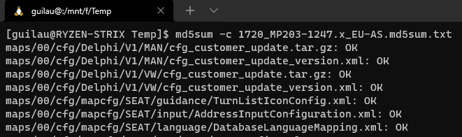

In the end, better to check files integrity using a MD5 hash compute capable program. I personally use a WSL environment where the md5sum command is ready to go.
I didn't have a look for Seat files, but Skoda provides all files MD5 signature.
Reality is the files won't unzip if the zip file is corrupted so the md5sum check is an overkill. Skoda is catching up with Seat. Originally only Seat had it. Has that changed one for MartiniB.
