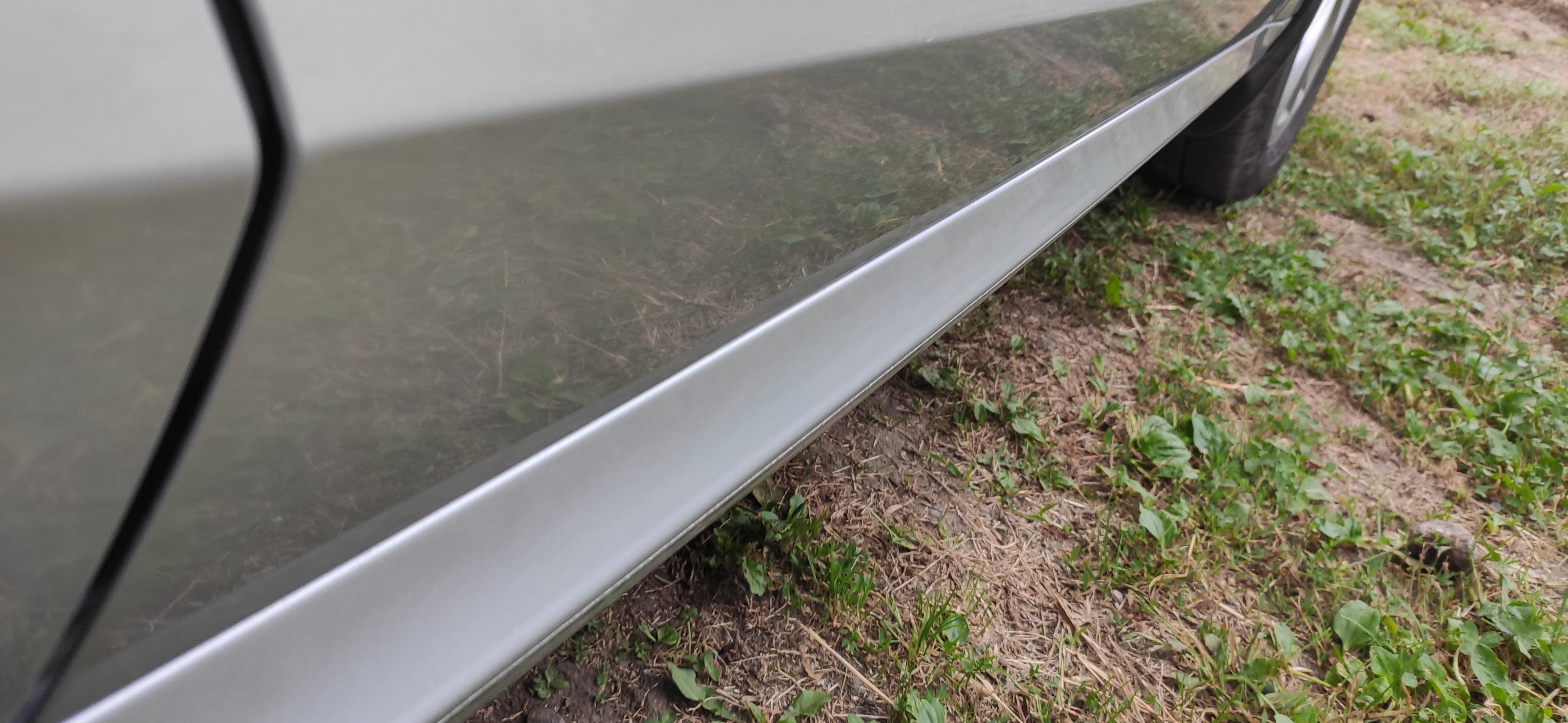

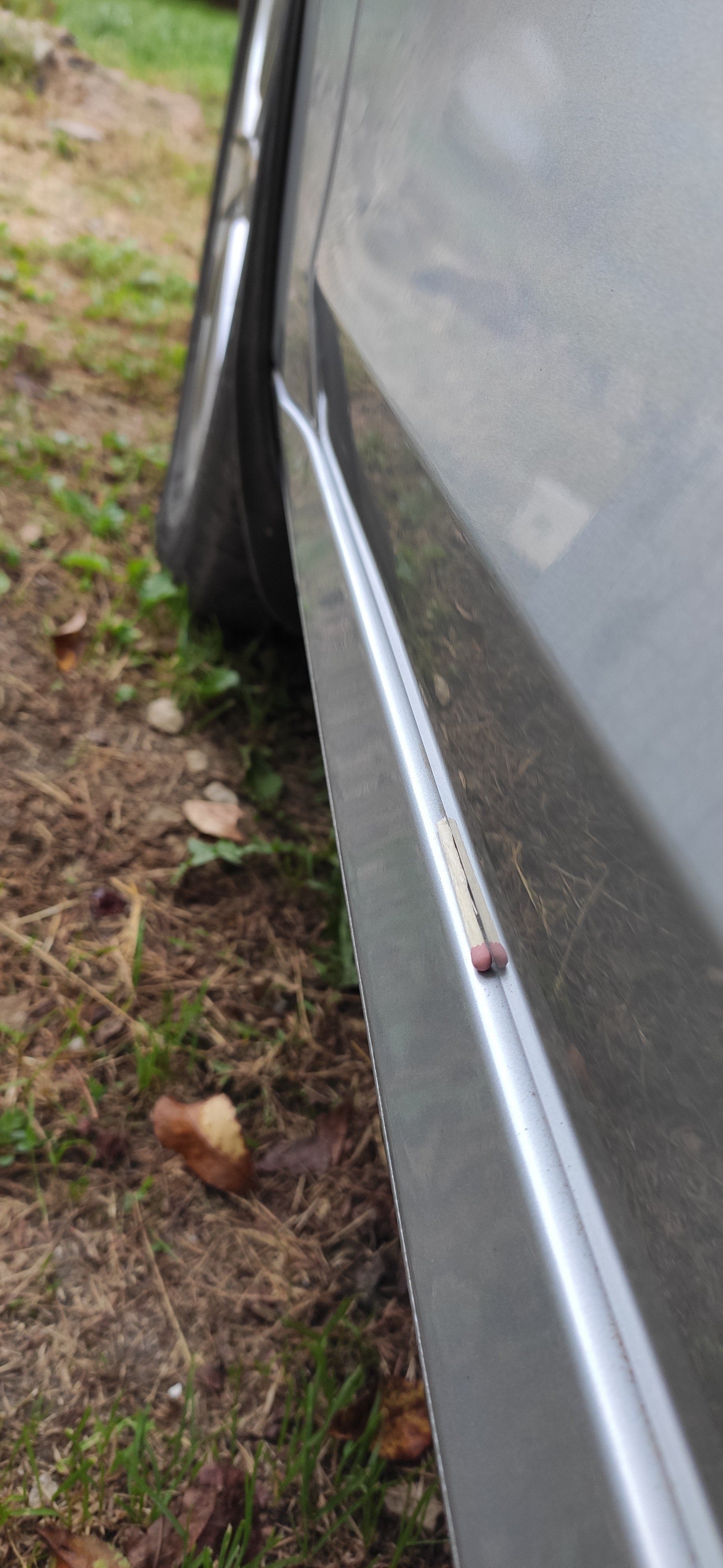

I have written about the body work of the Mk 4 before but I have just noticed a little detail, after owning the car for over a year. The bottom rear corners of the front doors. From a standing position, as you approach the car from the front, the lower rear edge of the door appears perfectly straight and vertical. But it is not at all. There is a sharp horizontal crease along the body work near the bottom edge of the doors and to make the edges of the doors, front and rear, appear vertical, the rear edges of the front doors and the front edges of the rear doors are carefully shaped.  I can not think of any other reason for this detail except to make the door edges appear straight. I now find myself checking the doors of all other cars with a horizontal crease and have not seen this detail on any other car.

Is it not to do with the door hinge of the rear door.
If you look at the hinge rotation point, then when the rear door opens, the wider part is going to arc out further, so if the gap between the doors did not follow the panel, part of the doors would catch each other.  I wonder if your straight line is a constant distance from axis of hinge rotation.
On earlier models if you had rubbing strips, then there would always be a tapered or flat part where two doors met, to avoid them catching.

Surrey John, I am sure that your explanation for the door detail is correct. You couldn't open the rear doors without the relief. Whatever, I still think it's a neat detail now I have noticed it.
