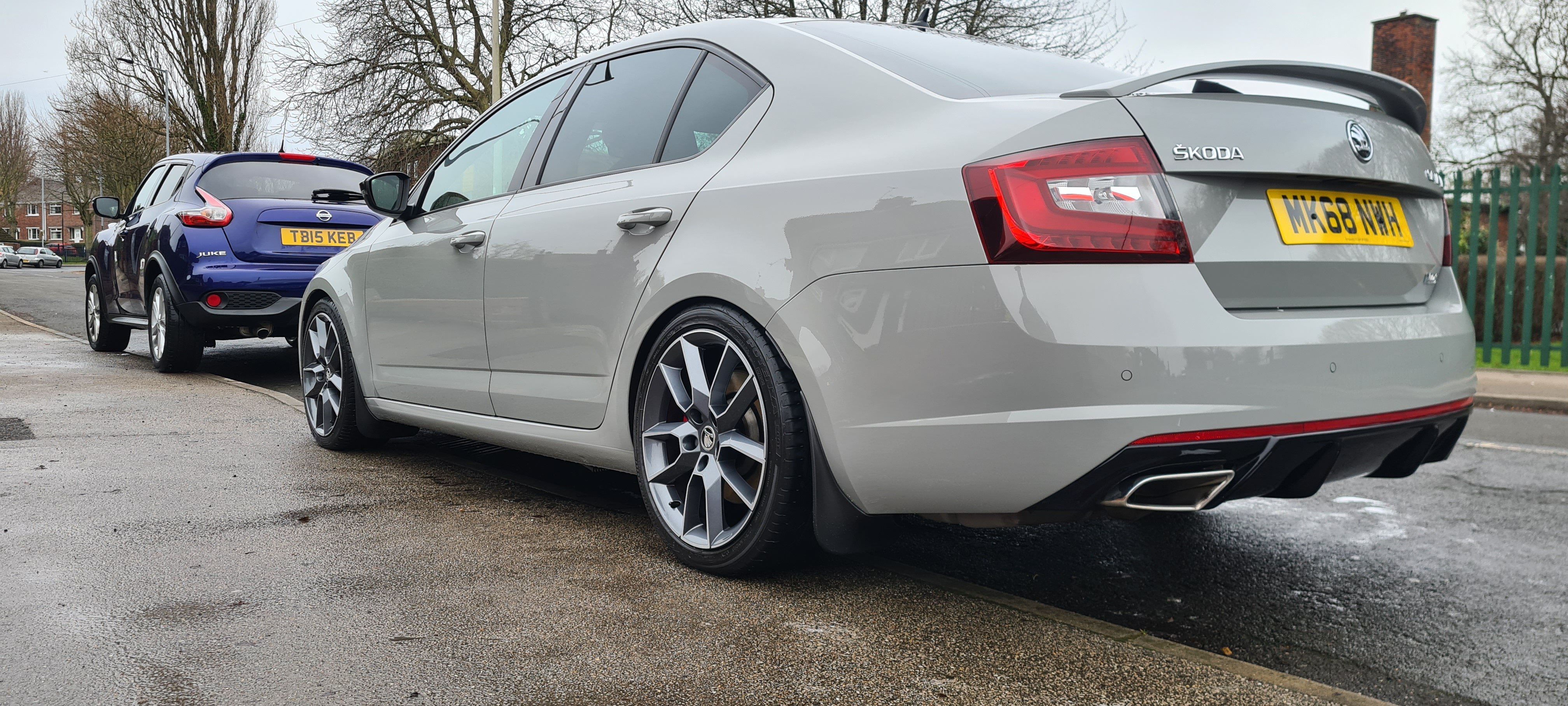

i recently put 15mm spacers alround on my vrs taking the offset to et36.(also on h+r 25mm lowering springs)
Also worth noting that the facelift vrs has different front and rear track widths from the factory than a standard octavia (slightly narrower at the front and wider at the back)
Getting the wheels to sit right in the arches can transform the look of a car IMO so I'd personally go for a lower offset wheel, they look better.

4 hours ago, vrs'burks said:
I can't see going up to 18s causing issue, as long as you stay as close as possible to the rolling diameter of the current wheels. .
Vrs 18s are 18x7.5j et51 with 225/40/18 tyres.
Thanks @vrs'burks  That's a beauty you've got there!  Yup, concur lower offsets look better! :biggrin:
How's the handling though?  Not sure if I'd want to use spacers or just get wheels with the lower ETs..
I can't tell that it handles any differently at all. . I ran my fabia vrs with spacers for 7+years and could never tell the difference with that either.
Obviously with a wider track stability should be improved, but its a roadcar i carry my son and missus around in not a track car so I'm not throwing it around bends anyway 😅
