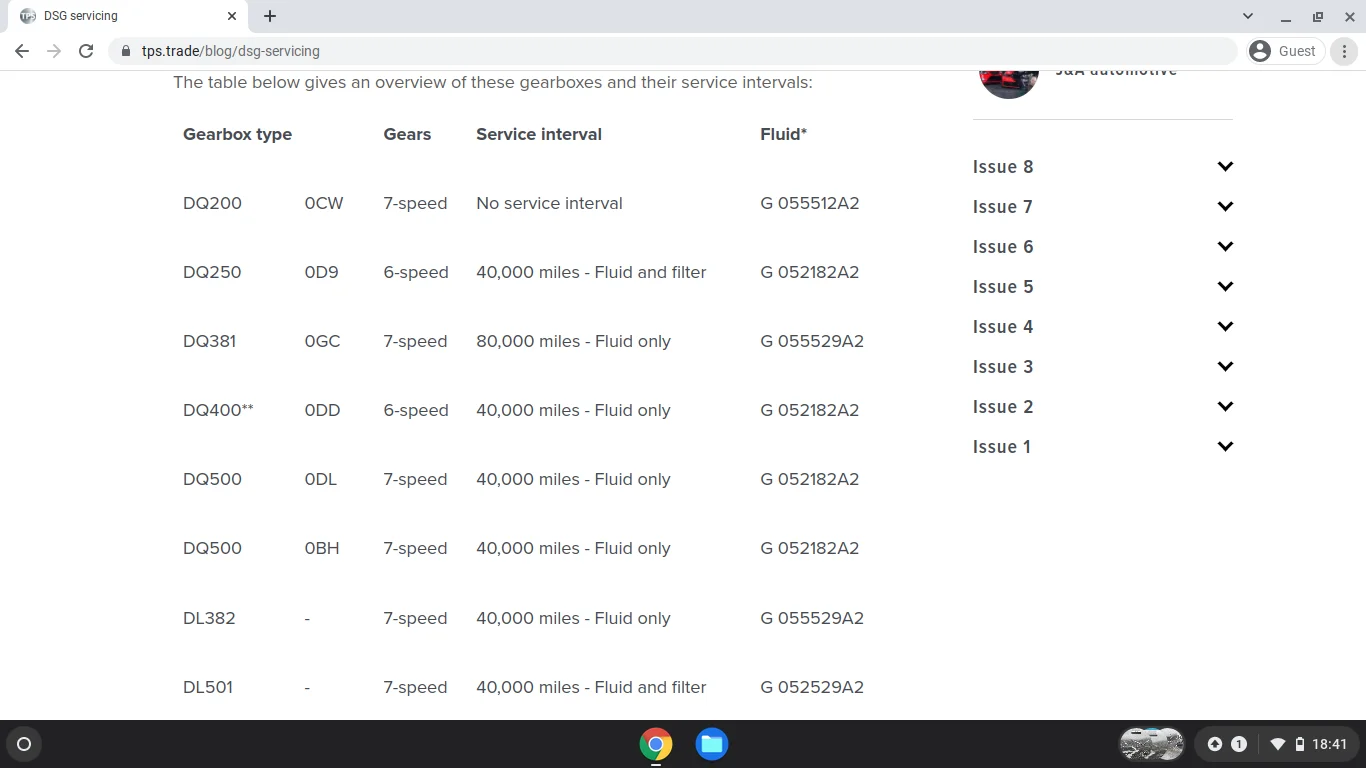

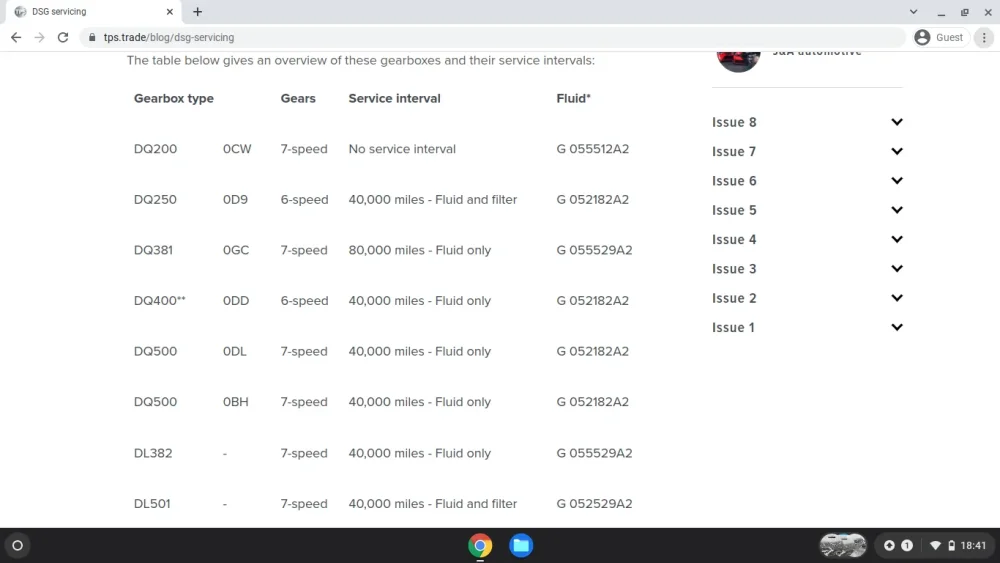

The DSG Oil change is every 40,000 miles or sooner and not @ each 4 years unless that is by chance  coming in at 40,000, 80,000, 120,000 etc.
No matter what this shows.
