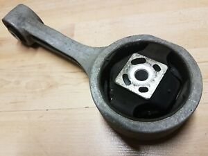

Have a look for the issue on the site, I've seen the dogbone mentioned before and getting a different one to parts catalogue but I can't remember if it was with a MK3 Fabia.  Or put up another thread with that in the title if you don't get more responses from this thread.

Which mount is it? There are two parts in my previous post ? The mount and the dogbone thing?
Thanks
Did I see a dogbone with polybush insert or polybush insert for existing oe am I on Fantasy Island again?
Not sure, so is the dogbone at fault or the other thing ?

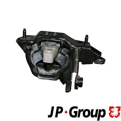

https://www.ebay.co.uk/itm/301964198707
This is the mount. Part number of my original mount was 6Q0 199 555 AR. Replacement mount number is 6Q0 199 555 AT.
Thanks so what’s the other part, the dogbone thing ?

There’s the gearbox mount:
And the dogbone?
