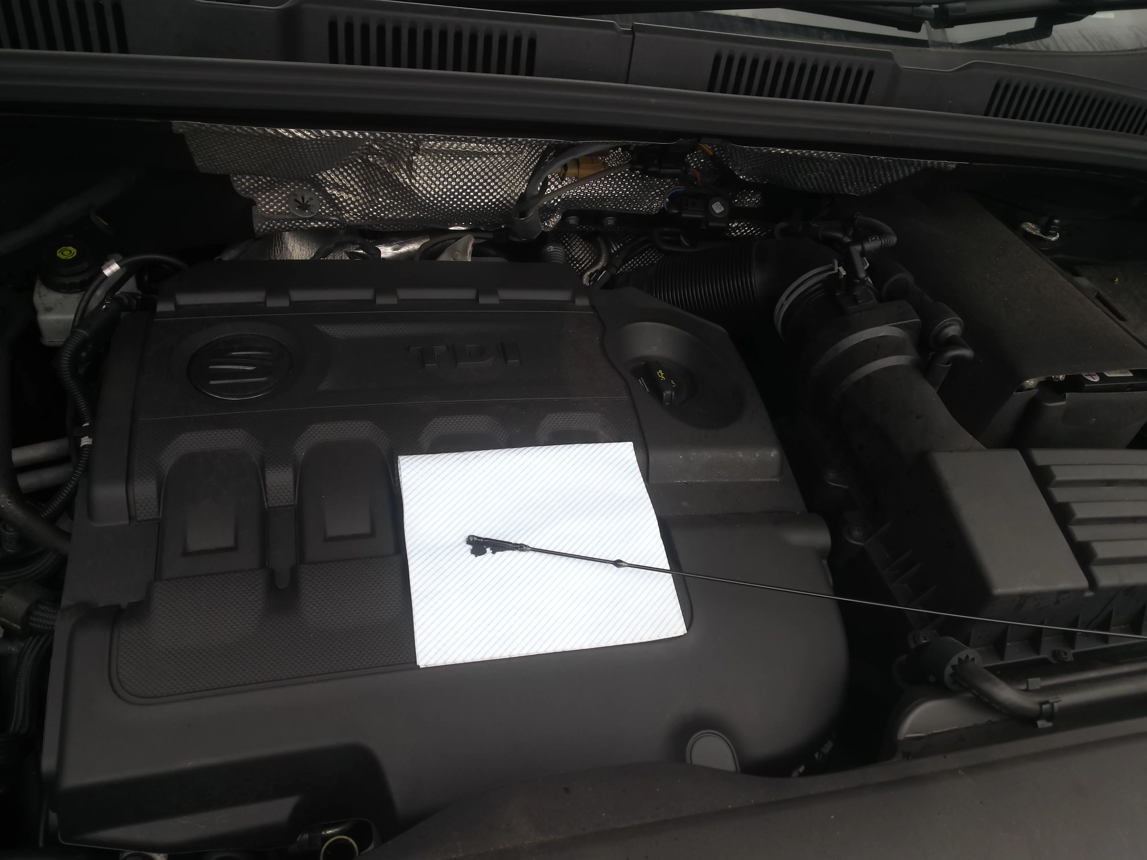

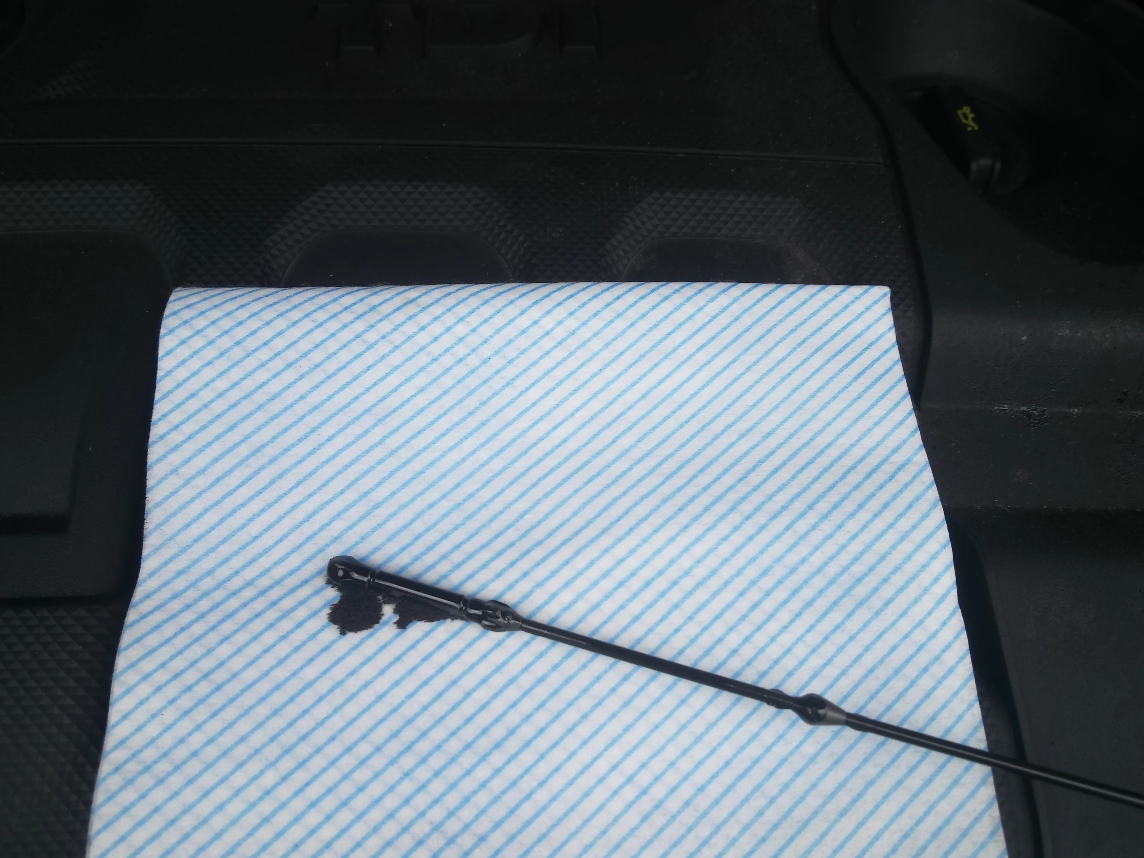

This was my oil like clotted cream in a 2017 in a 2016 2.0 TDI / scr which was to be serviced at the main dealers. Motability car.
Oil was added in the 18,000 miles, quite a bit, none needed after the first service til the next service.
it was like clotted cream up to the first oil and filter change when the car got a cxhance to go in,
but doing was getting great fuel  and actually after that oil change was dirty again in a few hundred miles.
