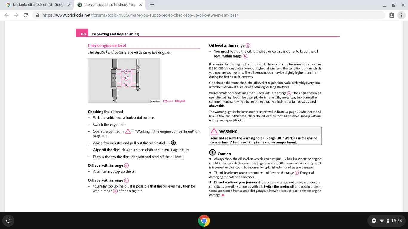

This is in the owners Manual
Depending on driving style and operating conditions, the engine consumes some oil, up to 0.5 l/1000 km. Consumption may be higher over the next 5000 km.
  • Check the oil level at regular intervals.
