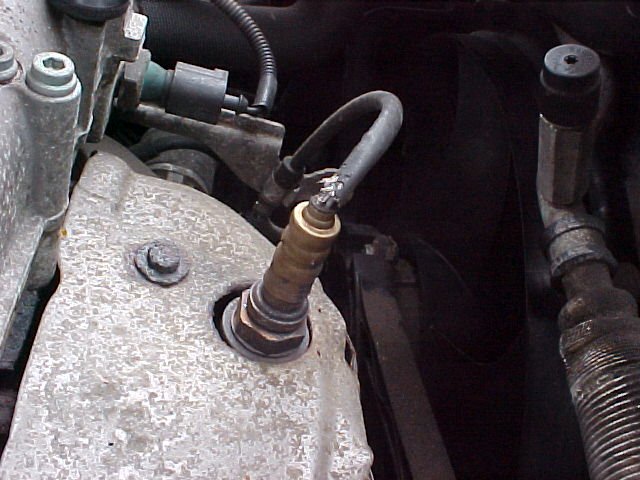

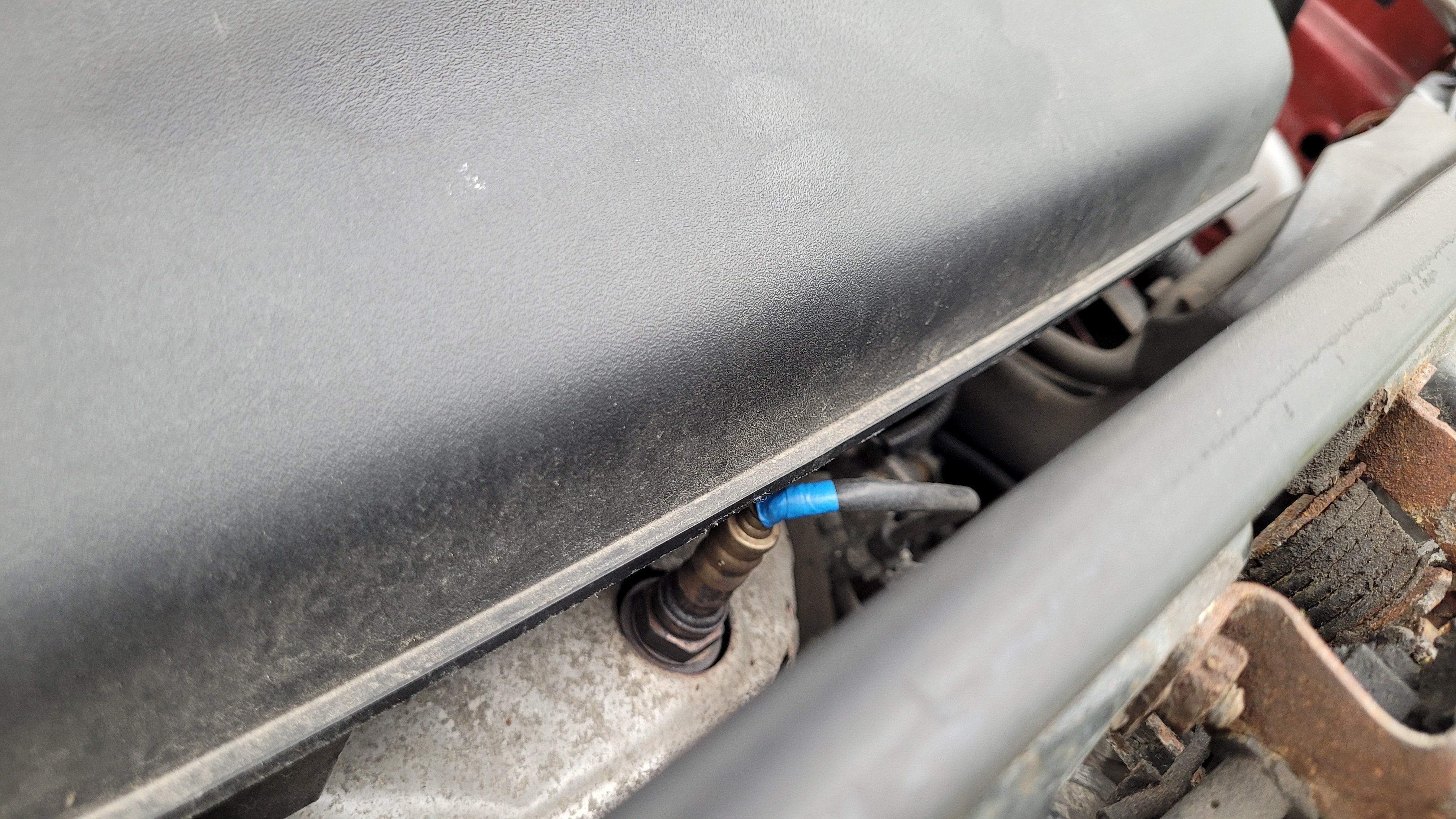

    Pre-cat lambda had pretty FUBAR-ed wiring. I've taped it up for now. Car has stopped cutting out, although it's only been like this for a few days now, but it just seems better.

This saga appeared to progress beyond the realms of being able to be fixed by sticky tape and the prayers of a man praying to a non-specific deity.

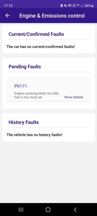

The car was overfuelling... and as a result, skinning me alive in petrol alone. I threw quite a few sensors at it, but it appears both my pre-cat lambda and MAP sensor had both given up the ghost without setting the engine light into a screeching frenzy.
So maybe the moral here is to rely on your brain (or whatever is in that bit of yer heid) and not always on the OBD readings.
All I know is that it works now and that isn't bad. Electrical witchcraft seems to have sorted itself out mostly, too.
Win win.

Yep! In fairness, the computer helped a little with diagnosis, but only through pulling live data from these sensors.
